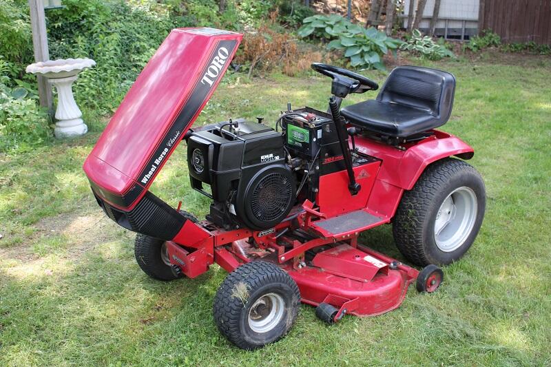

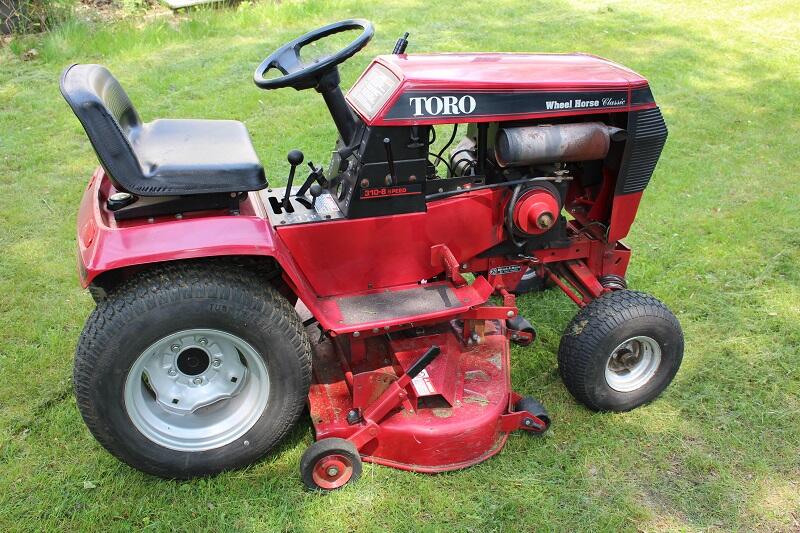

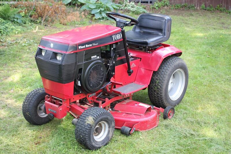

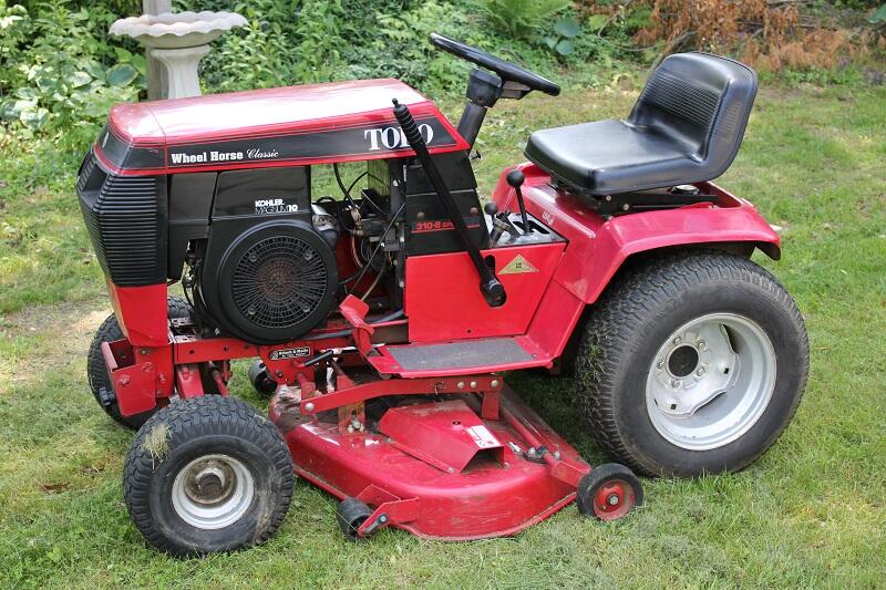

MSGGrunt 19 #1 Posted June 11, 2023 Just picked up a 310-8 rear discharge with 201 hours. Tractor is in very good condition from the others I saw on FB Marketplace. Even the seat isn't cracked. Paid $600.00. I was initially looking for a larger tractor like a 520, but I came to my senses and realize that I always go bigger than I really need for my smaller yard. The only thing I needed to buy was a new air filter and PTO belt. I like the simplicity of a non-hydro drive and manual lift mower deck. I have owned Case-Ingersols in the past and currently have a Honda 5013 4x4 for snow blowing duties. The Wheel Horse did a great job of mowing on my first time using her. 9 8 Share this post Link to post Share on other sites

peter lena 9,092 #6 Posted June 11, 2023 @MSGGrunt do a thorough baseline service on that just to verify how everything works / looks , total lubrication every grease joint , trans oil change / engine oil . also would not hesitate to giv that paint a penetrating oil rub down , that paint is at the oil recovery stage , also , drop that deck and check for build up issues , blade condition .noting the very low deck height , you are asking for a grass packed deck . you want to prevent that , that would be a very good save , with those hours . pete Share this post Link to post Share on other sites
MSGGrunt 19 #8 Posted June 12, 2023 Thanks for the advice on the low deck height. Not a big deal to raise it. I have already planned to change all the fluids, greasing all the zerk fittings and possible taking a look at the deck pulleys spindle bearings. When I picked the tractor up the seller had a hard time starting it and I thought it may need a new fuel pump, but it hasn't given me any issues on the first outing. Maybe after sitting a few days it loses its prime? The starter makes a heck of a racket/grinding sound when starting. I also thought the paintwork would benefit from a good buffing and wax. 2 Share this post Link to post Share on other sites

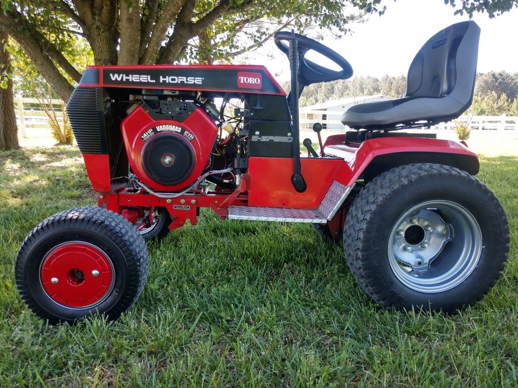

kpinnc 13,771 #11 Posted June 12, 2023 A 310-8 is a great machine. Sips gas, but plenty of power. Keep the engine oil and tranny checked, and she'll run for a long time. Use ethanol-free fuel too. My 310-8 was my first Wheel Horse, and 20+ years later she's still going (with a few upgrades). 2 3 Share this post Link to post Share on other sites

Tractorhead 9,093 #13 Posted June 12, 2023 to. At picts it appears a great condition of the Rig Sounds to me it was a good trade 👍 1 Share this post Link to post Share on other sites
