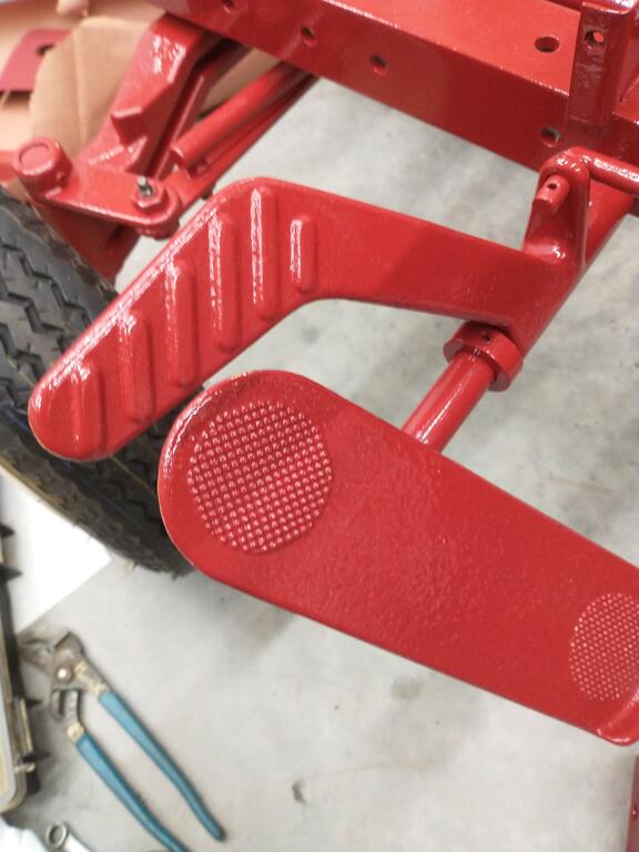

Tucker 1 #1 Posted June 11, 2023 i am try to install a clutch pedal for my wheel horse 701 but don't know how to. Share this post Link to post Share on other sites
rjg854 11,883 #2 Posted June 11, 2023 have you got a picture of what you're trying to do? 1 Share this post Link to post Share on other sites

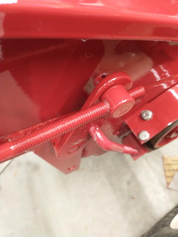

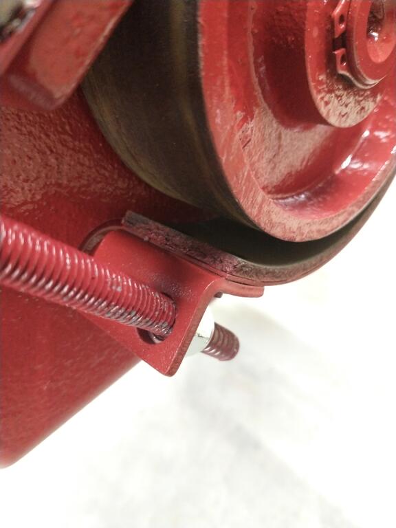

rmaynard 15,927 #3 Posted June 11, 2023 First, be sure that you have sufficient brake lining to properly stop the tractor. Loosen or tighten the nut on the brake band rod until you can achieve full braking and still have the brake pedal in a comfortable position. The brake pedal position can be further adjusted by turning the rod in or out. 2 2 Share this post Link to post Share on other sites
Tucker 1 #4 Posted June 11, 2023 ok i got that but what about the other pedal 1 Share this post Link to post Share on other sites
rmaynard 15,927 #5 Posted June 11, 2023 The other pedal operates the PTO, for the mower deck. 2 Share this post Link to post Share on other sites
ri702bill 8,991 #6 Posted June 11, 2023 13 minutes ago, rmaynard said: The other pedal operates the PTO, for the mower deck. @Tucker - welcome!! The clutch / brake pedal is the one on the left. You NEED the drive belt guard to be installed for proper belt control to allow you to shift. NO shifting while in motion - stop, pick the desired gear and slowly let the pedal up... you need to stop to go to reverse... pedal part way down is clutch, all the way is brake (with clutch). DO download the free manual for it in the "Manuals" section.... 1 Share this post Link to post Share on other sites
