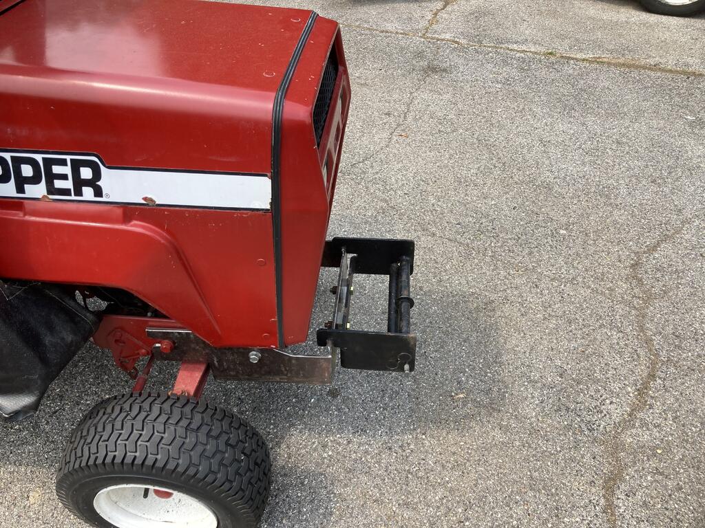

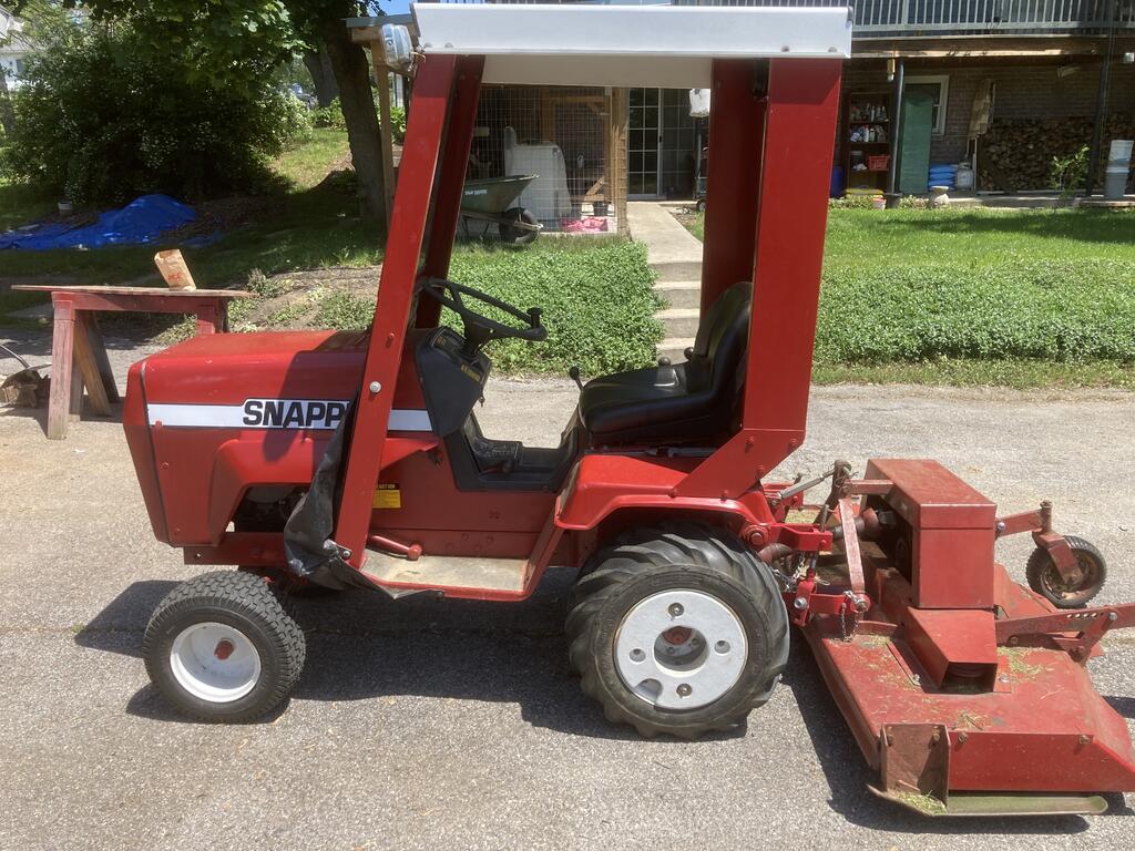

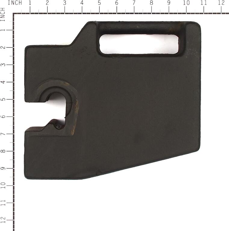

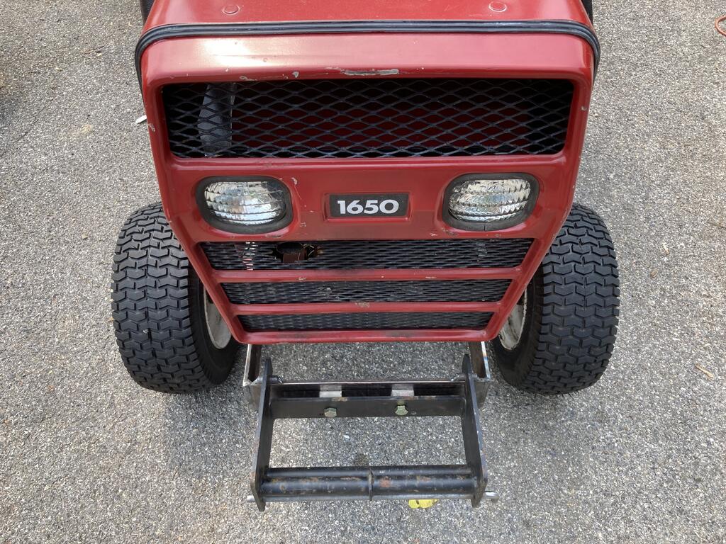

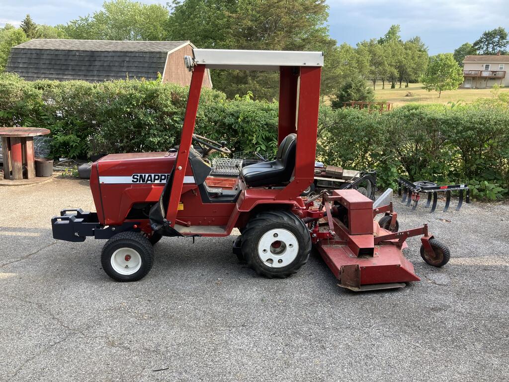

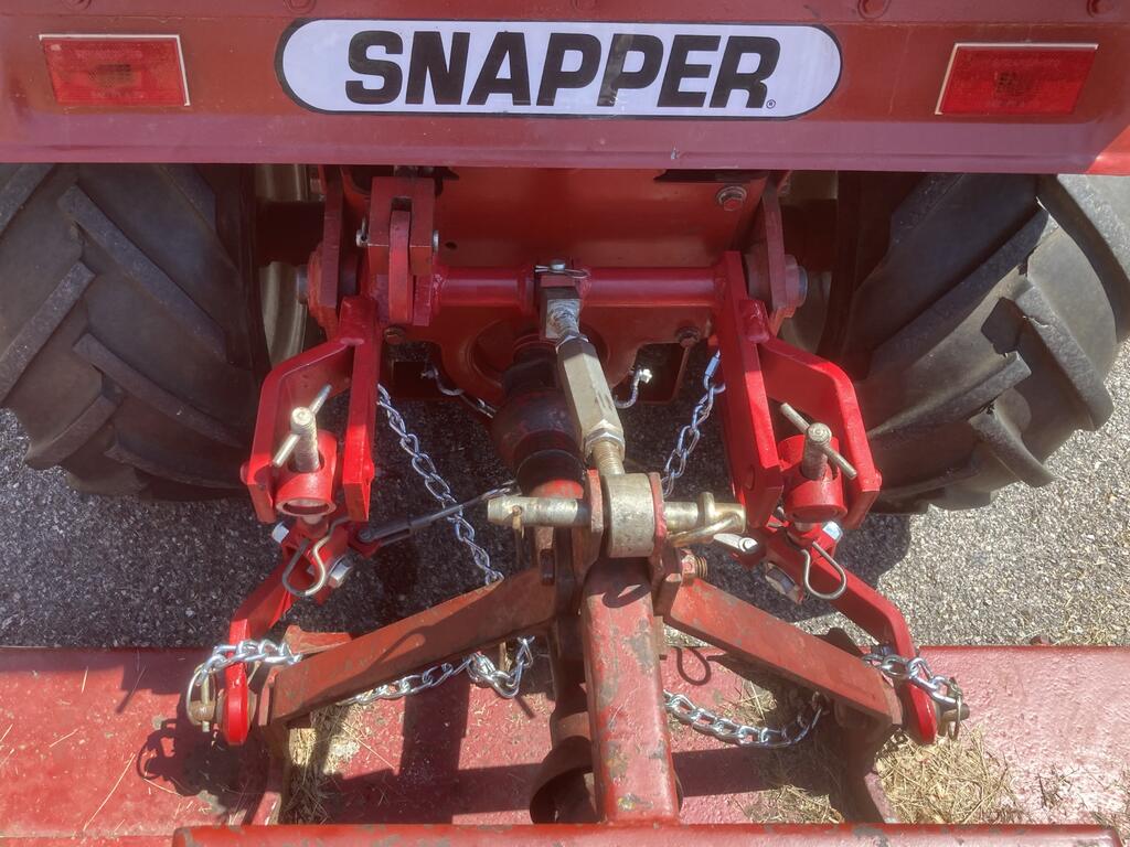

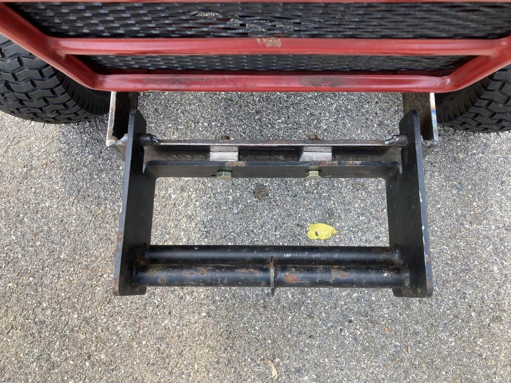

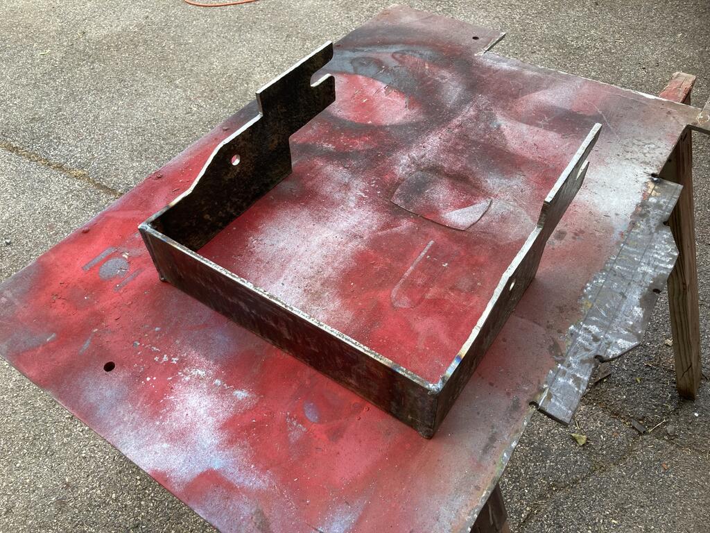

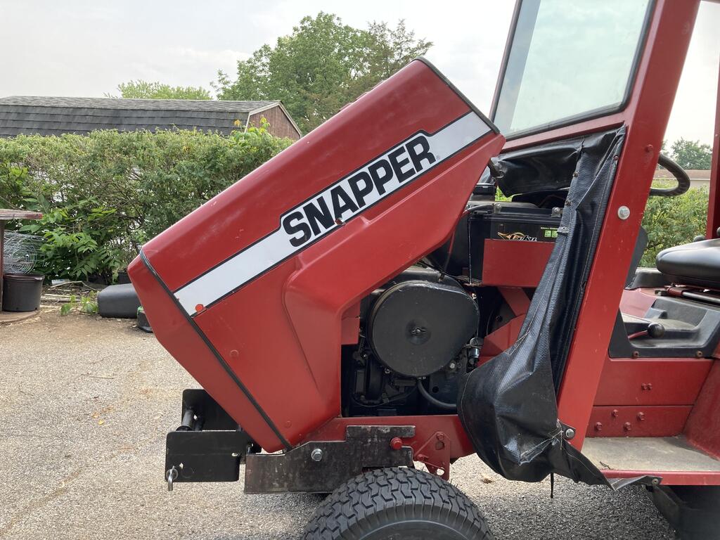

"Manic-Mechanic" 1,196 #1 Posted June 8, 2023 (edited) Managed to build the cat 0 3pt mod and the Finish Mower. Runs excellent but a bit of a ballast issue The hood opens as it should while using the bracket The front weight carrier has clearance Fairly level with a wee bit of incline to counter the weights The Finish Mower is nice and level The check chains doing their job nicely The bracket 5/16 plate steel, (formally a fifth wheel plate from the old Dodge) Was cut with my trusty heavy duty DeWalt jigsaw. Had to use 6 Bosch Carbide rated 1/8-3/8 blades then a Tig for "Penetrations'" The clearance should suffice, (would help if the weights would get here) Simplicity/Snapper Weight Carrier 169422 Lastly Simplicity/Snapper Suitcase Weights1692939 I certainly hope 100lbs will be enough! Very pricey! Edited June 8, 2023 by "Manic-Mechanic" Constant editing issues! Not user friendly at all! 5 Share this post Link to post Share on other sites

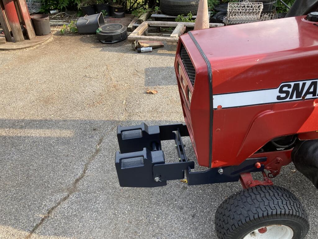

"Manic-Mechanic" 1,196 #8 Posted June 9, 2023 Little update 1 Share this post Link to post Share on other sites
