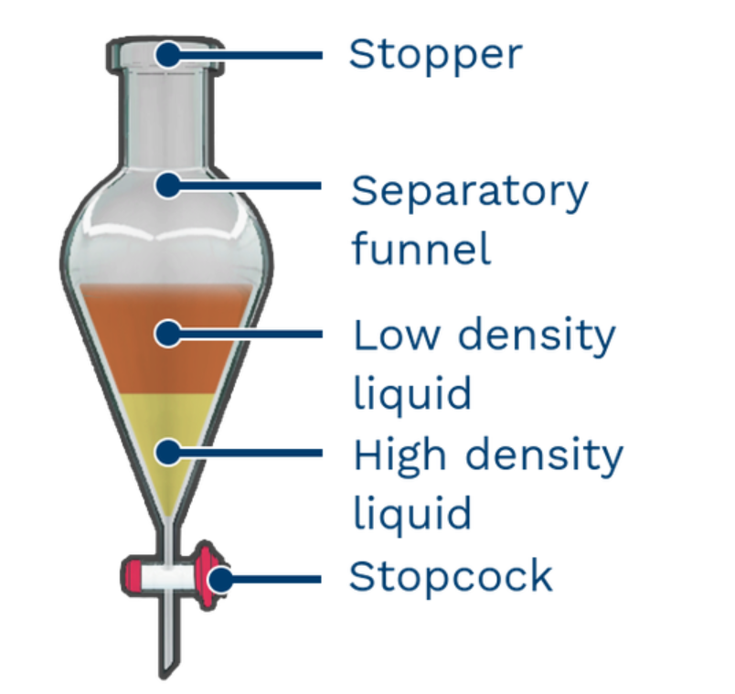

wh500special 2,454 #5 Posted June 5, 2023 i didn't watch the video. I presume he's adding water to gasoline to try and extract the alcohol into a water phase at the bottom of the funnel. I do like reference to the separatory funnel though. Great piece of lab glassware. It's a very straighforward estimation process to determine the octane reduction when you take out the ethanol: Since we are looking at octane level over a fairly small range (say 87-93) you can pretty well assume that the apparent octane level as a function of percent alcohol in the mix is going to be linear. 100% Ethanol has an octane level of around 100-115. I'll use 110 as the baseline. Typical base formulation regular grade gasoline for non-mountainous areas has an octane level of 87 but I suppose the refiners may drop the octane number slightly when the fuel is intended to be blended with ethanol as a booster. If you were to blend 87 octane gas with 10 octane ethanol at a 50/50 mix you'd get an overall octane of about 99. (87+110)/2 = 99. If you blend at 10% ethanol to 90% gasoline you'd end up at about 89 in the blend. 0.9(87)+0.1(110)=89. Working backwards from a pump posted value of 87 octane gasohol with a 10% ethanol content, then the base gasoline started life as 84 octane. 0.9(x)+0.1(110)=87 so x=84 So if you remove the alcohol by extraction that's about where you end up. That's probably too low for a lot of engines to like. if this was higher octane fuel - say pump posted 91 octane - with the ethanol in it and you extract the alcohol, then you'd land at about 89 octane when you're done. That ought to work just fine in almost anything. This all assumes, of course, that the ethanol was the only thing the blenders added as a means of boosting the octane number. if they added other stuff too, then the reductions when you extract the alcohol will be somewhat less. And what are you going to do with that water/alcohol/whoknowswhatelse mix that's left over? You can be sure it's not just alcohol and water that can be responsibly dumped. The safest thing to do with it would probably be to blend it in with a large quantity of gasoline and burn it . Steve 1 Share this post Link to post Share on other sites

wh500special 2,454 #7 Posted June 8, 2023 (edited) I don’t. And I’m not much of an expert on solubility in general. I always worked with systems that were already characterized and for which someone else had generated data. But not being an expert has never shut me up before… I would think that the polar end of the ethanol molecule would have greater relative affinity for the surrounding water than would the non-polar end for the non-polar mix of stuff that makes up gasoline. I base this guess on the high potency of hydrogen bonding in alcohols and water that gives them their almost magical properties of high boiling points, surface tension, and tendency to form azeotropes. So I’d surmise that the water would preferentially wash out the ethanol from the gasoline. But since gas is a mixture of a wide array of miscellaneous hydrocarbons - probably including a variety of other alcohols and things that would have some polarity like carbonyl and ester groups - the water probably extracts them too during the wash. Which would throw off the quantitative aspect of the water experiment. excellent point. Edited June 8, 2023 by wh500special 1 Share this post Link to post Share on other sites
wh500special 2,454 #8 Posted June 8, 2023 Funny coincidence… Autocorrect filled in carbonyl when I meant to type - and apparently misspelled -carboxyl. That would be another polar group that probably shows up in gas. 😂 Steve Share this post Link to post Share on other sites
