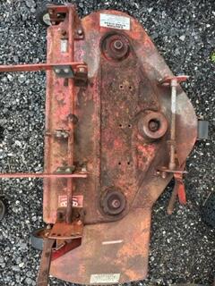

I've owned a Raider 8 for 30 years and now I want to get the deck back working.
The only thing it needs is a spindle belt but I am having trouble finding the correct size????
Also if anyone knows the pattern that the belt should be installed in, it would be helpful to know.

Is there an ID tag somewhere on the deck?  A model number and serial number would help.  Failing that, could you post a picture of the deck?  There are folks here on the forum that will be able to identify the deck and point you towards the proper belt.

Looks like you’re missing the idler pulley and spring as well?
vjerry
I have both, they were removed for cleaning and the idler is being replaced with new.
Still hoping someone can tell me the model number of the deck since I am missing the belt????
Is the deck a 36" width of cut side discharge?
vjerry
Yes,that is correct
vjerry
Anybody???? Still needing the fan belt size for the side discharge deck

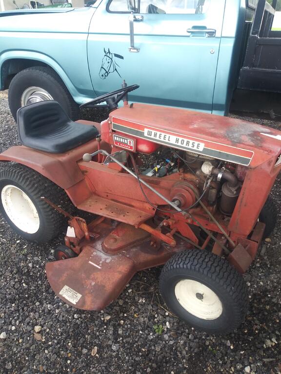

Engine run like new because it was completely rebuilt, sheet metal and deck are in very good condition with only surface rust.
Has new belts & tires
Trying to decide if I want to sell it and buy a larger one?
