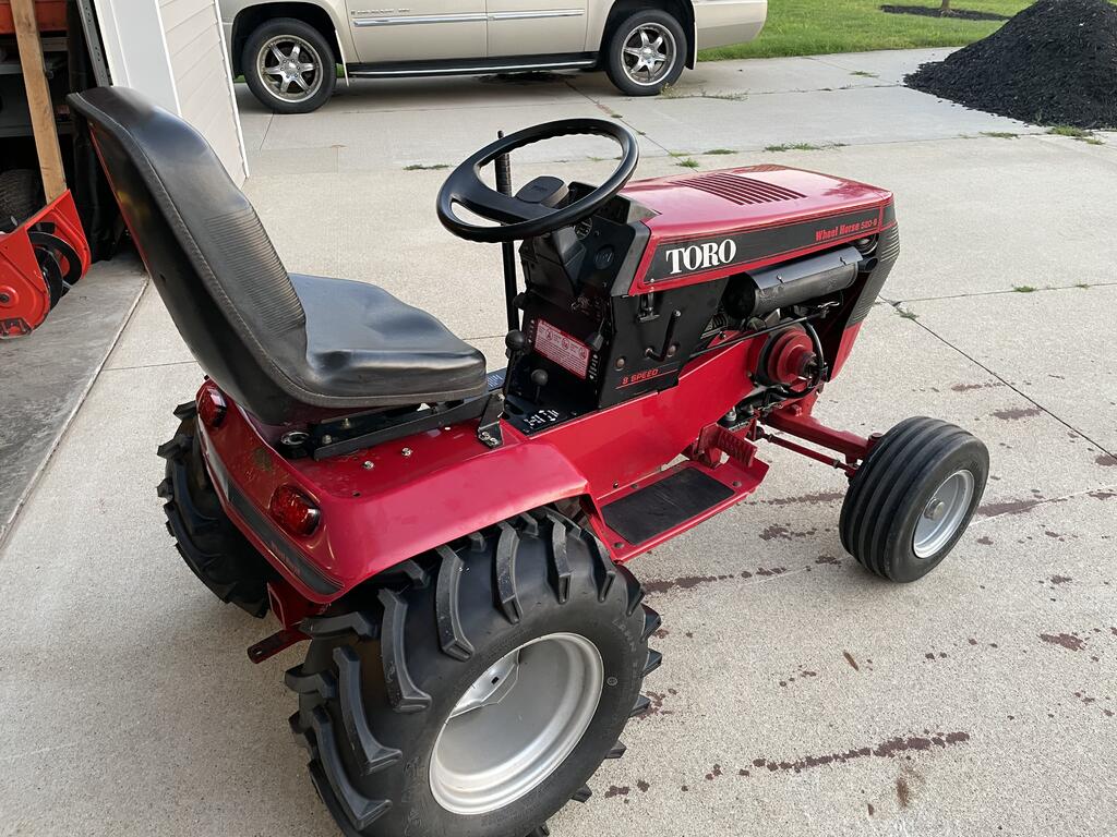

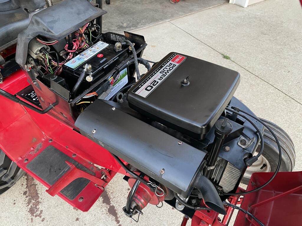

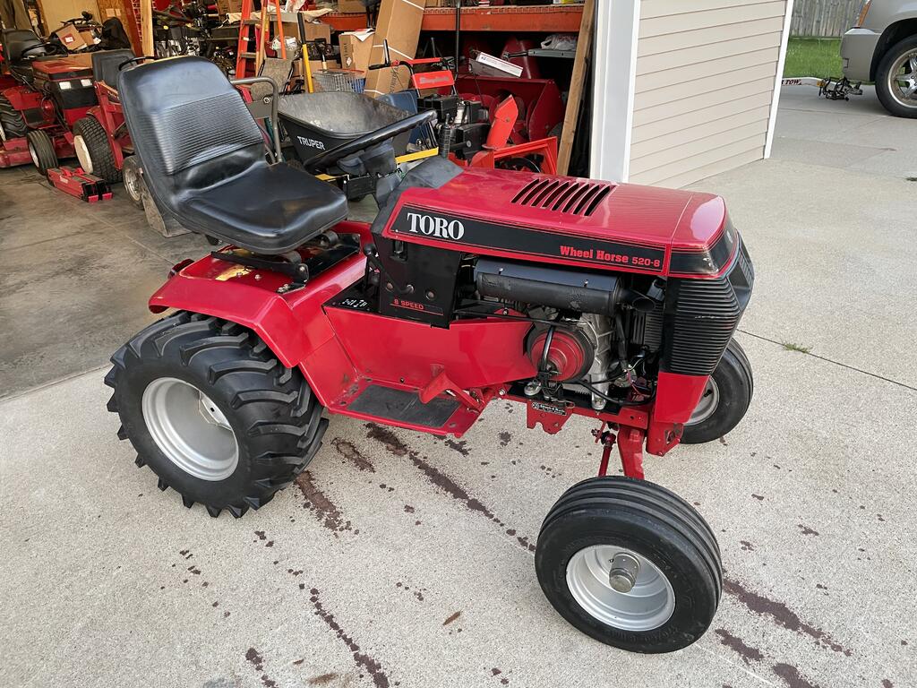

Bow_Extreme 544 #33 Posted August 18, 2023 (edited) Well, a second engine and we have progress. IMG_0041.mov Edited August 18, 2023 by Bow_Extreme 1 4 Share this post Link to post Share on other sites
Bow_Extreme 544 #34 Posted August 18, 2023 (edited) Well, a second engine and we have progress. Edited August 18, 2023 by Bow_Extreme 2 Share this post Link to post Share on other sites
Pullstart 64,529 #35 Posted August 19, 2023 Awesome! 2 Share this post Link to post Share on other sites

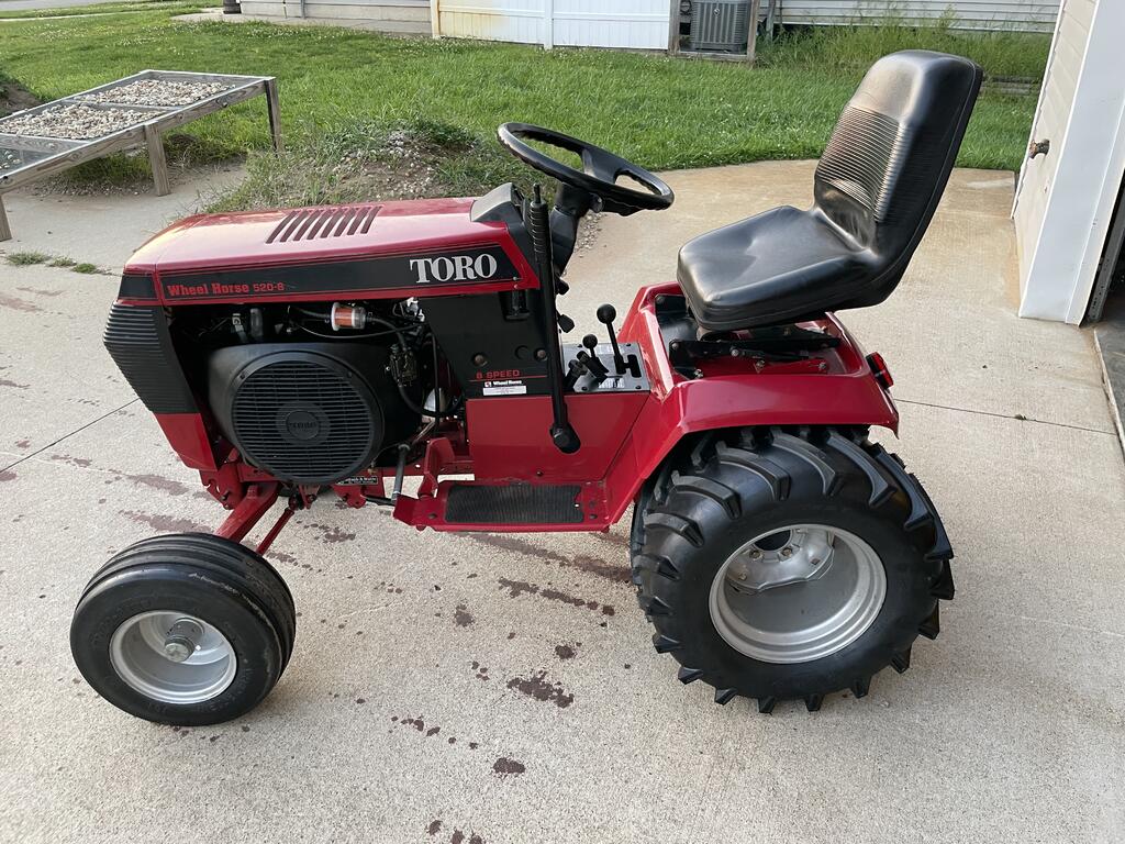

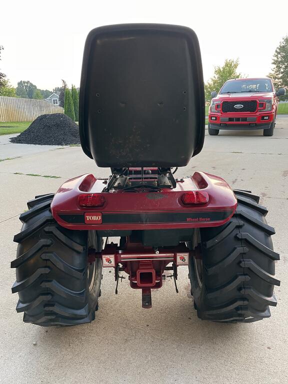

Bow_Extreme 544 #36 Posted August 20, 2023 (edited) Almost done. Edited August 20, 2023 by Bow_Extreme 1 8 2 Share this post Link to post Share on other sites
c-series don 9,425 #37 Posted August 20, 2023 Two words, Bad Ass! 2 1 1 Share this post Link to post Share on other sites
Bow_Extreme 544 #38 Posted August 20, 2023 4 minutes ago, c-series don said: Two words, Bad Ass! Thank You! 2 Share this post Link to post Share on other sites
JCM 10,017 #39 Posted August 20, 2023 When you have some serious work to do, it's tough to beat a well maintained 520 Wheel Horse. 4 Share this post Link to post Share on other sites
kpinnc 13,728 #40 Posted August 20, 2023 1 hour ago, Bow_Extreme said: Almost done. That thing is gorgeous! Well done sir! 2 1 Share this post Link to post Share on other sites
Bow_Extreme 544 #41 Posted August 20, 2023 5 minutes ago, kpinnc said: That thing is gorgeous! Well done sir! Thank You! 2 Share this post Link to post Share on other sites
