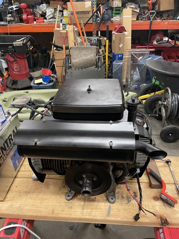

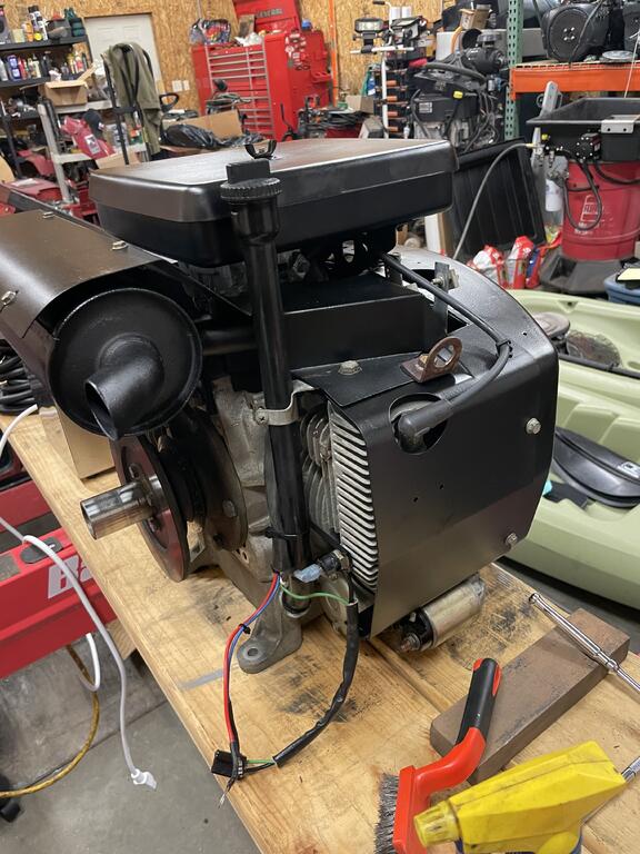

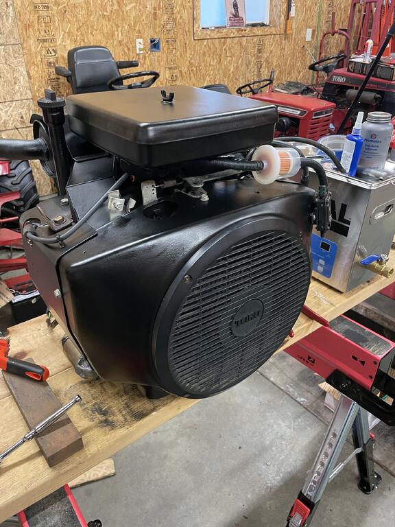

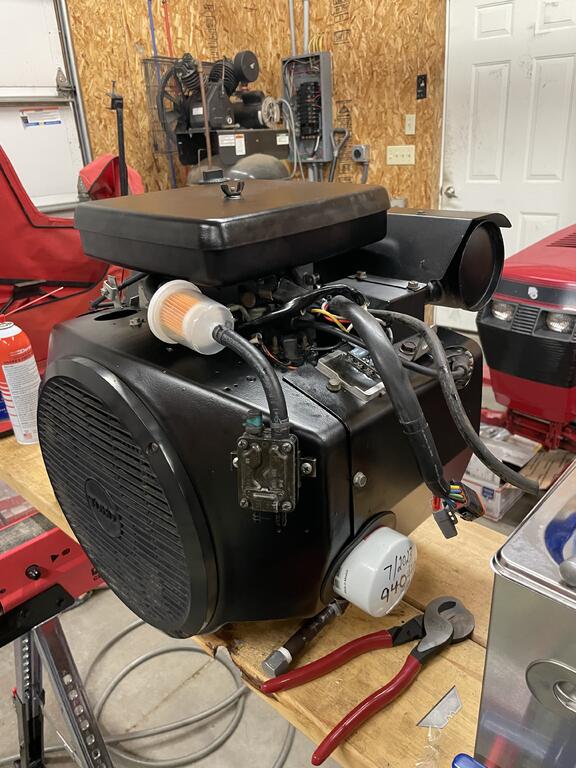

Bow_Extreme 544 #1 Posted June 2, 2023 Well, so much for keeping this original……. @Pullstart Engine is getting all new gaskets as well. 2 8 Share this post Link to post Share on other sites

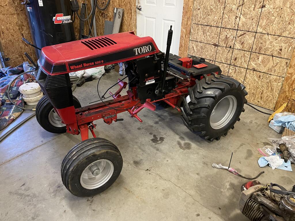

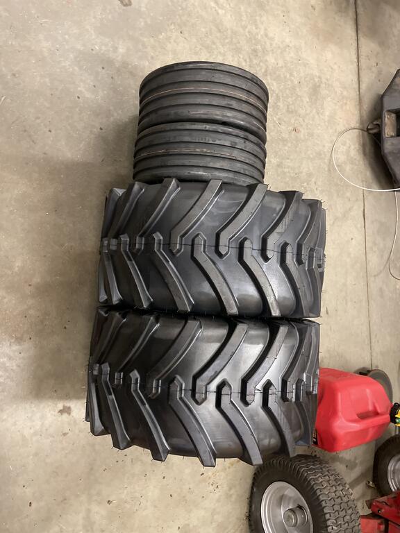

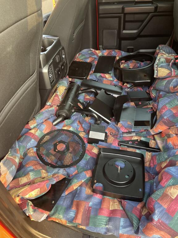

c-series don 9,425 #2 Posted June 2, 2023 @Bow_Extreme Let’s talk about those tires and what those pieces are painted with! 3 Share this post Link to post Share on other sites
Bow_Extreme 544 #3 Posted June 2, 2023 8 minutes ago, c-series don said: @Bow_Extreme Let’s talk about those tires and what those pieces are painted with! Fronts: Vredestein 16-6.50-8 5-Rib Rear: OTR Lawn Trac 24x12-12 Rims are all stock Thinking of loading rears but haven’t decided. all the engine parts are powder coated, extra heavy. There are more at powder coat, right now. I keep deciding to do more of them. I’m thinking they after removing the dash tower, tonight, I’ll be sending more out for coating. 3 4 Share this post Link to post Share on other sites
c-series don 9,425 #4 Posted June 2, 2023 I’m really liking everything so far. Please keep us updated with pictures as you go! Thx 4 Share this post Link to post Share on other sites

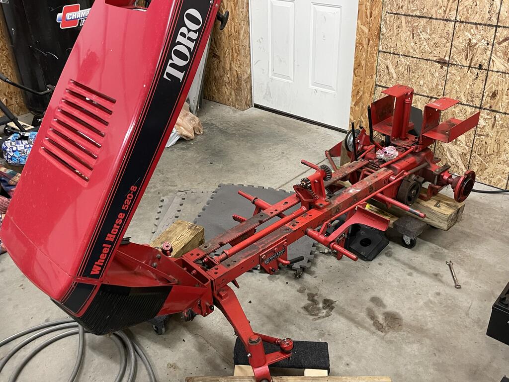

Bow_Extreme 544 #6 Posted June 2, 2023 1 minute ago, Pullstart said: Lookin’ great Matt! Thanks! Since I have it this far, should I paint the frame and trans? I wasn’t out to restore this, just improve it a bit. 2 2 Share this post Link to post Share on other sites
Horse Newbie 7,195 #7 Posted June 2, 2023 47 minutes ago, Bow_Extreme said: Thanks! Since I have it this far, should I paint the frame and trans? I wasn’t out to restore this, just improve it a bit. I say “go all the way” 6 1 Share this post Link to post Share on other sites
oliver2-44 10,367 #8 Posted June 2, 2023 (edited) Your down to almost the bottom, may as well go all the way Edited June 2, 2023 by oliver2-44 6 Share this post Link to post Share on other sites
stevebo-(Moderator) 8,398 #9 Posted June 2, 2023 Always top notch builds by you! 5 Share this post Link to post Share on other sites
ebinmaine 70,720 #10 Posted June 2, 2023 6 hours ago, c-series don said: I’m really liking everything so far. Please keep us updated with pictures as you go! Thx 6 hours ago, Bow_Extreme said: Since I have it this far, should I paint the frame and trans? I wasn’t out to restore this, just improve it a bit. You're already there Bud. Might as well finish right up while the opportunity is the best. I'm with the others above. I say paint the frame and trans. 5 Share this post Link to post Share on other sites
Pullstart 64,529 #11 Posted June 2, 2023 Absolutely paint the heavy stock! 3 1 Share this post Link to post Share on other sites
c-series don 9,425 #12 Posted June 2, 2023 You can’t get it down to the frame and transmission and not paint it. Simply. Not aloud. 1 5 Share this post Link to post Share on other sites

Bow_Extreme 544 #17 Posted July 27, 2023 (edited) A little work done over the last few nights. Edited July 27, 2023 by Bow_Extreme 1 8 Share this post Link to post Share on other sites

Bow_Extreme 544 #21 Posted August 1, 2023 35 minutes ago, Pullstart said: Hey, I’ve got a GT14 with a tiller… once you get this thing put back together wanna trade? You’re doing great Matt, and to think I thought it was ready to go! Ha! Thank You! Honestly, this one has been a lot of work! So many things found that needed repaired or replaced. Last night, I had to replace the headlight switch as it didn’t work. I know. Random event. At first I thought my wiring job was bad. This is one of many issues. Last night I fired it up for the first time. Have to pull the carb again, as I’m having issues with fueling. Plenty of fuel to the carb but seems like something is stuck in the main jet. To make matters worse, I now have another 520-8 sitting in the barn.🤪 1 2 Share this post Link to post Share on other sites
