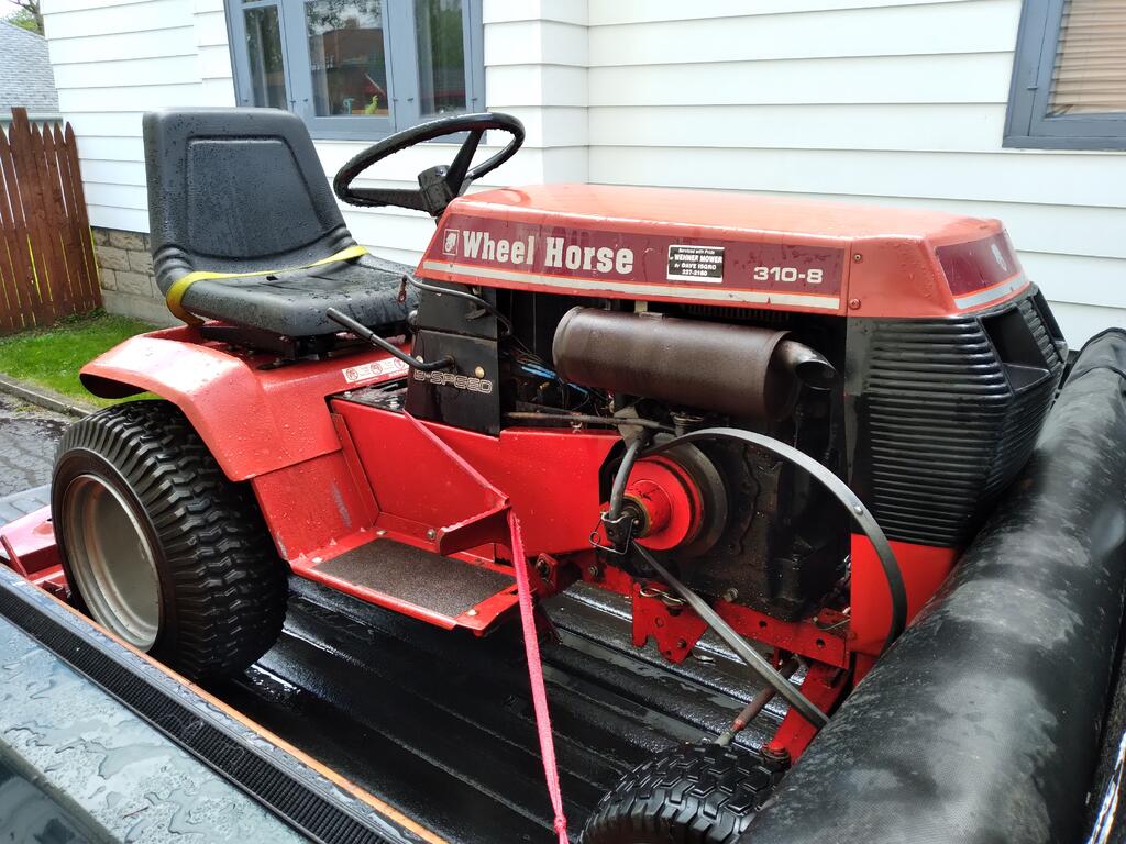

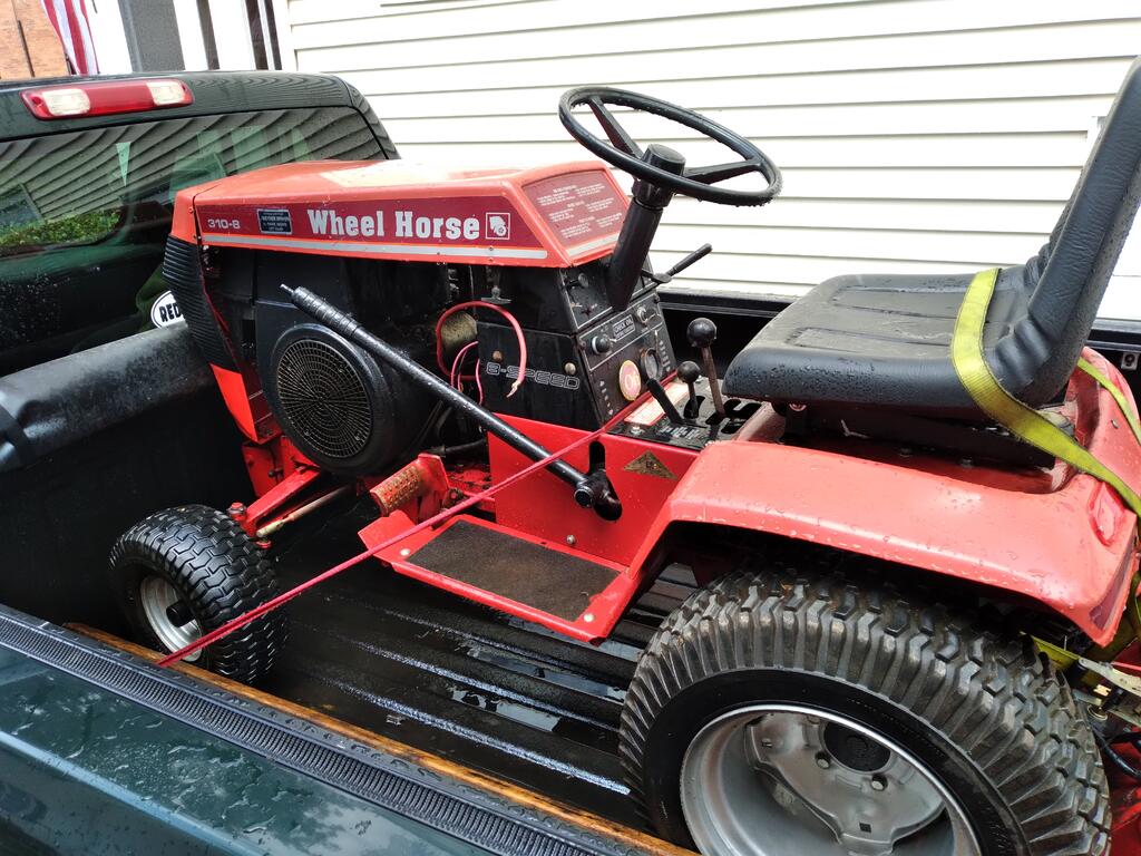

D_Mac 9,139 #32 Posted June 8, 2023 So my new carb should be here tomorrow. Ordered one from isavetractors. Hopefully the free 310-8 will be mowing grass this weekend. Excited to get that carb on and get the tractor home for a good cleaning. 1 Share this post Link to post Share on other sites

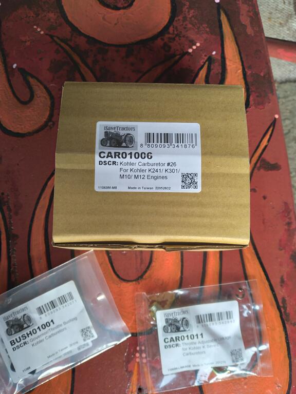

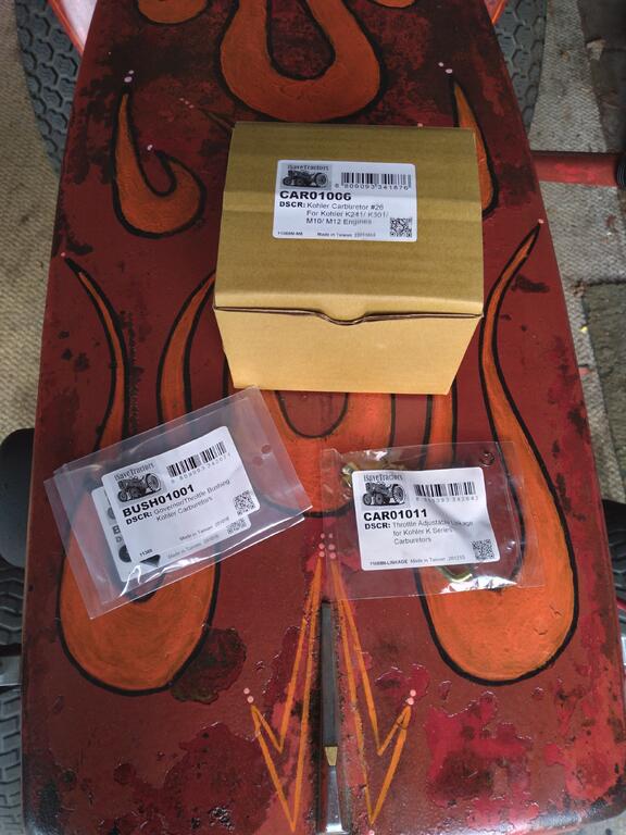

D_Mac 9,139 #33 Posted June 8, 2023 Got my order today. Came pretty late in the day so I will try to get it on tomorrow afternoon. Shipping was quick. Can't wait to try it. More to come. 1 Share this post Link to post Share on other sites
