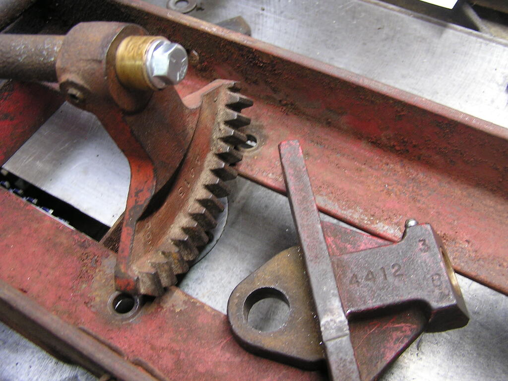

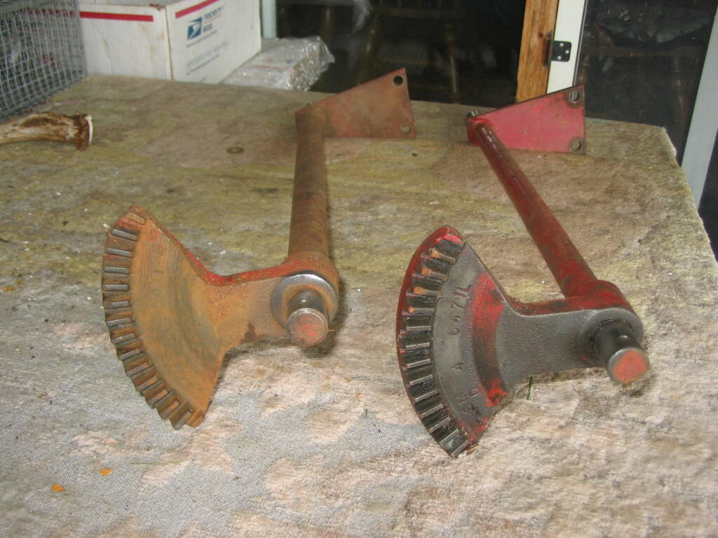

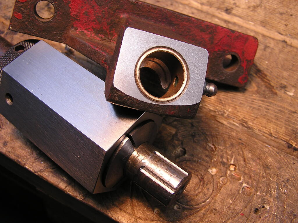

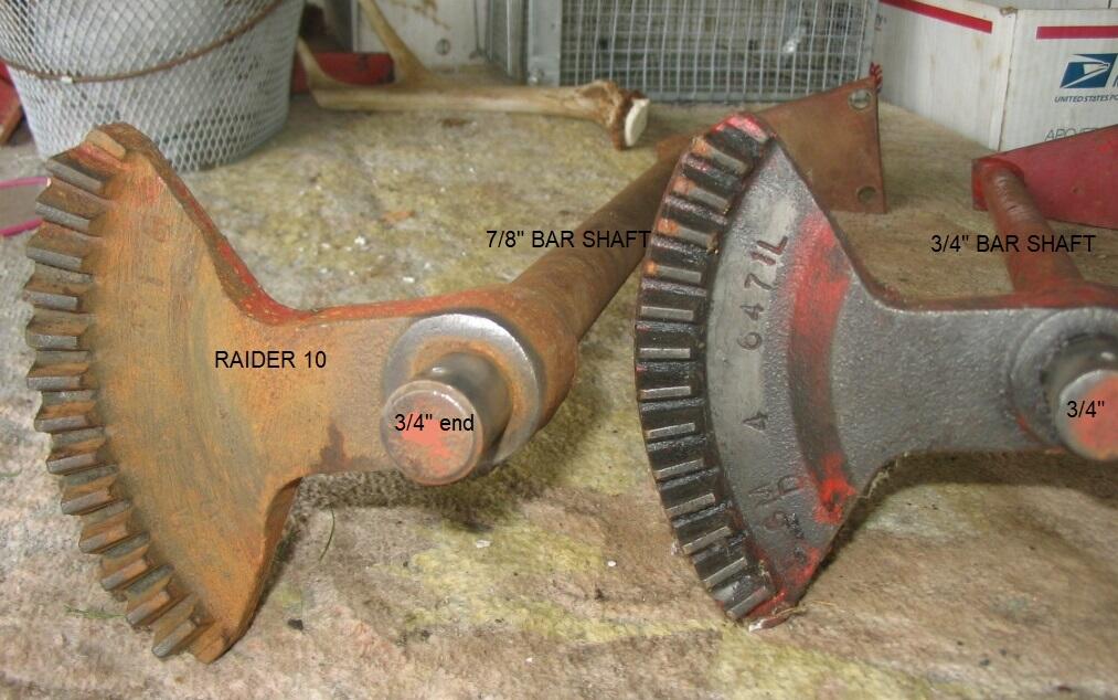

ri702bill 8,894 #8 Posted May 31, 2023 (edited) 12 hours ago, mrharris12 said: I’m guessing the new washer and cotter tried to adjust it for a quick fix. I’m guessing the first thing to try is to switch out the fan gear and see what happens with a new one? I am not convinced that the fan gear is the problem. The lower steering block is broken - fairly common. You will need a new one anyway - replace that first. The action between the steering wheel shaft gear and the fan gear seems to be OK. There are various styles of lower steering supports, they are interchangable, but some are "better" than others. The early 1960's version had thin tabs to mount to the frame and no thin bushing for the shaft - the least desirable of all. Later they added the bushing in the same casting - a bit better. The "best" version is newer, has thicker tabs and the bushing. For what it's worth, I modified the early one and the steering wheel shaft - added an upper bushing, grooved the shaft to make grease pockets, added a bushing to the fan gear shaft. Edited May 31, 2023 by ri702bill 1 3 Share this post Link to post Share on other sites

mrharris12 32 #10 Posted May 31, 2023 1 hour ago, ri702bill said: I am not convinced that the fan gear is the problem. The lower steering block is broken - fairly common. You will need a new one anyway - replace that first. The action between the steering wheel shaft gear and the fan gear seems to be OK. There are various styles of lower steering supports, ther are interchangable, but some are "better" than others. Thearly 1960's version had thin tabs to mount to the frame and no thin bushing for the shaft - the least desirable of all. Later they added the bushing in the same casting - a bit better. The "best" version is newer, has thicker tabs and the bushing. For what it's worth, I modified the early one and the steering wheel shaft - added an upper bushing, grooved the shaft to make grease pockets, added a bushing to the fan gear shaft. I’ll see if I can find a steering block and see what happens with it, appreciate it! 1 Share this post Link to post Share on other sites
ri702bill 8,894 #11 Posted May 31, 2023 Good - do that first, but do not be surprized that the more you fix, the more you find!! Do check the play in the tierod joints. Factory ones for MOST tractors were non greaseable and wear out (or fall apart !!) long before the rest of the tractor does, Modern adjustable length replacements with Heim spherical joints are the way to go... Was the tractor ever used for plowing - the broken lower steering block is usually the victim of vibration and frame twist from plowing.. If so, check the frame "F" plate - the flat end of the frame where the Unidrive bolts on - for evidence of cracking around the four mounting bolts - fixable but time consuming. This is an 854 frame from a dedicated plow tractor - 3 of the 4 holes were severely cracked out - only 1 had a good hold of the Unidrive. This one wiggled like an inchworm on uneven ground..... 2 Share this post Link to post Share on other sites

Lee1977 6,989 #17 Posted May 31, 2023 2 hours ago, brians306 said: you have a p.m. Here is how I brazed mine. 1 2 Share this post Link to post Share on other sites
ri702bill 8,894 #18 Posted May 31, 2023 Lee - a bit of prep work to fixture it with good results. That block looks like a newer one with the thicker tabs and the bushing... A few questions... Did you have to remove the lower bushing due to the heat? Did you pre-heat the whole part and fixture first?? I take that this is a long term fix - did it hold up?? The heat discolorization seems to be very localized. Bill 1 Share this post Link to post Share on other sites
Lee1977 6,989 #19 Posted May 31, 2023 It's off the 312-8 it's still on there those pictures were taken in July of 2017.Doesn't move when turning the steering wheel. No preheat, takes a good bit of heat before you can braze. I didn't remove the bushing. It broke when I turned it over backing into a fence post. There is a picture I just posted in last tractor loading accident on Bumps and Bruises. 1 Share this post Link to post Share on other sites

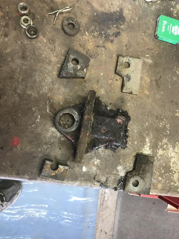

mrharris12 32 #21 Posted June 5, 2023 Wanted to let everyone know that I finally had time to get the steering uninstalled and turns out the block is fine and the fan gear isnt worn down. It turns out the bearing or bushing that goes on the end of the fan gear was completely gone, that is why it was rocking when turning within the steering block. 2 Share this post Link to post Share on other sites
mrharris12 32 #22 Posted June 16, 2023 To all, I ended up getting a new steering block, the old one was a little more opened up than it should be. Did not get a bushing for either hole on the steering block, but for the fan gear I added a few more washers and made it a lot tighter and it took most / if not all the play out of the steering. Fix wont last but so long, but it does work for now. 1 1 Share this post Link to post Share on other sites
