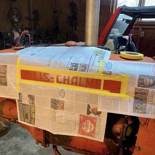

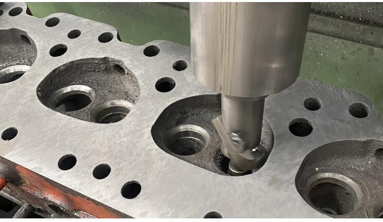

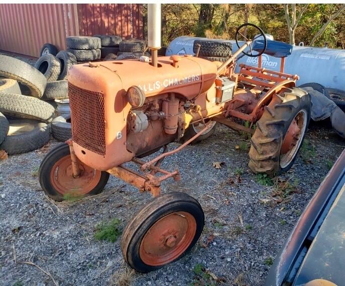

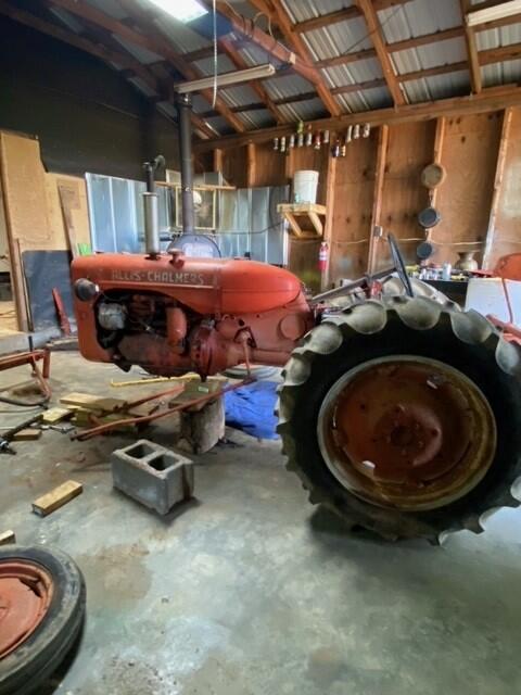

Greentored 3,220 #1 Posted May 18, 2023 (edited) Some of you may remember seeing a shot of this in another thread, just before I got it. My buddy purchased some land and this old B was sitting in the weeds- he says "Want an Allis Chalmers? Guy mowed with it up til about a year ago. If you dont want it it's going to scrap." Well eff yeah I do! And so it began....... "Adventures with Allis", and if you're interested in a lot of boring rambling but cool content, its on Youtube- might make for some good toilet reading Ol Allis has gone from prying the flywheel with a breaker bar to get it broke loose (yeah- running a year ago- more like 20 ha), to a somewhat freshened bottom end, modified cylinder head and governor spring, and 'half slammed' to Industrial B stance- about 9" lower than the original row crop design. Oh, and it runs, drives and works- quite well I might add! Heres some random photos- whatta fun project this has been....and continues to be, as they all are. Edited May 18, 2023 by Greentored 5 7 Share this post Link to post Share on other sites

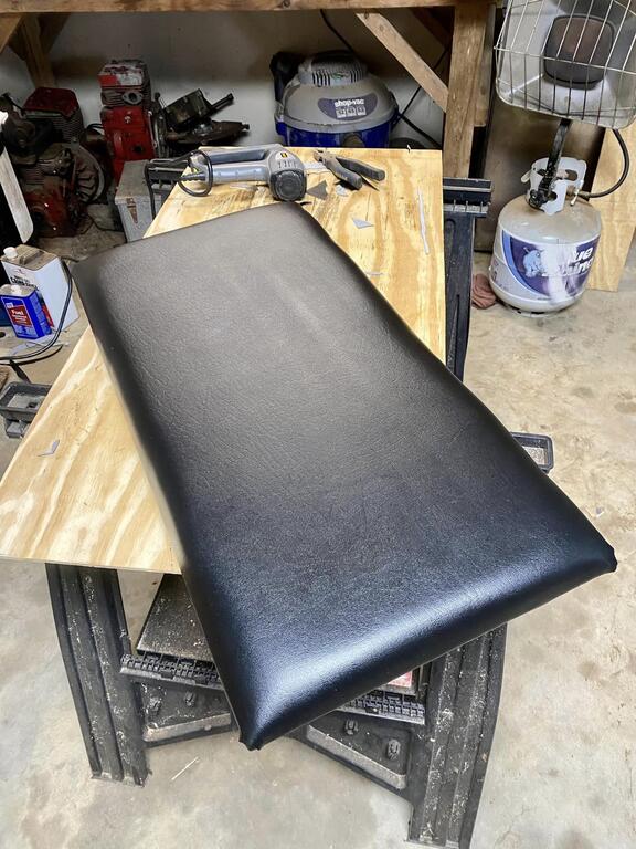

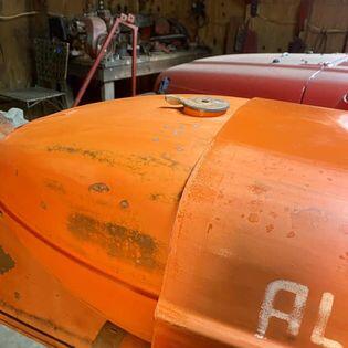

Greentored 3,220 #2 Posted May 18, 2023 And a few more- trying to keep the patina look, including trying to make the freshly repaired and painted fuel tank match the rest of the battle scars. 6 5 1 Share this post Link to post Share on other sites

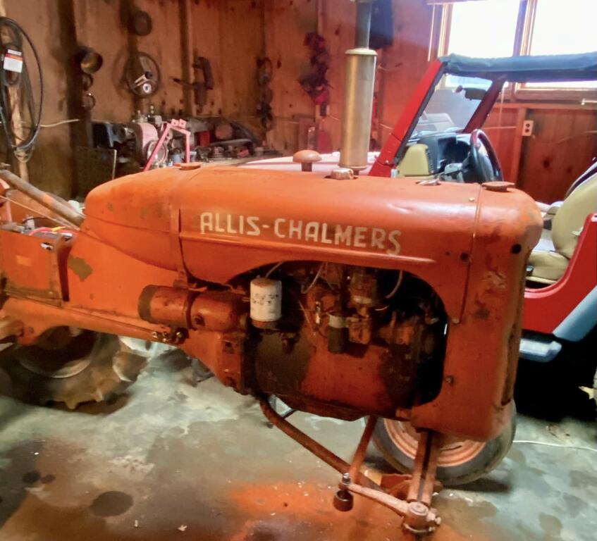

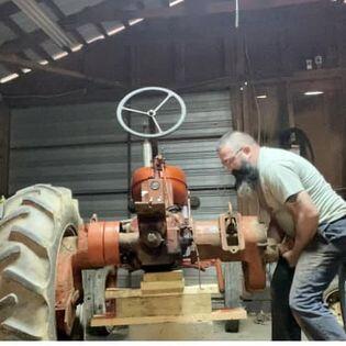

Greentored 3,220 #3 Posted May 18, 2023 ....but wait, theres more! Knocking some air out from under her- after a quick trip to the local watering hole 7 6 2 Share this post Link to post Share on other sites

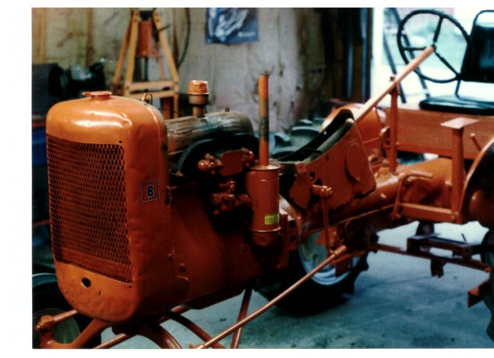

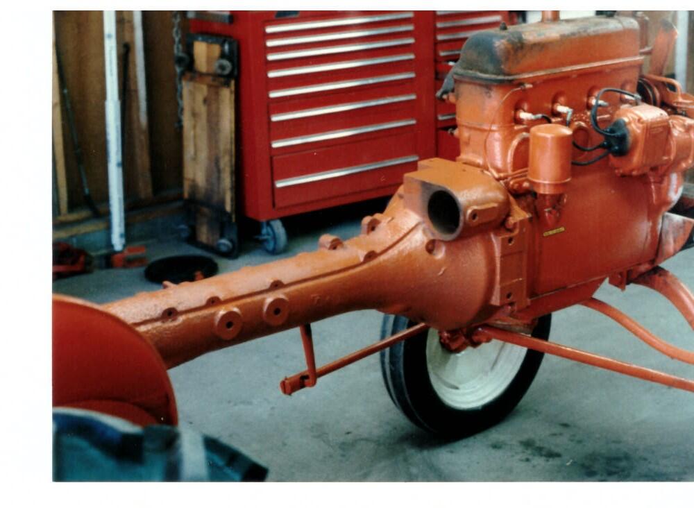

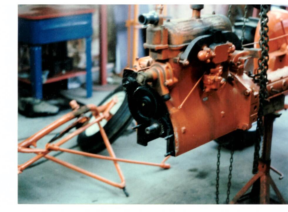

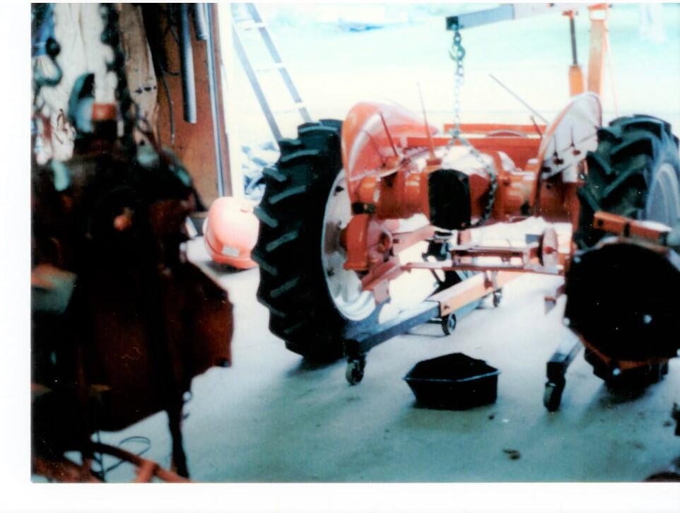

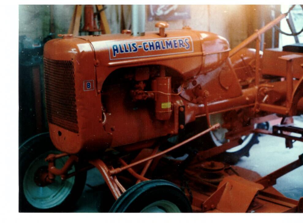

squonk 42,095 #4 Posted May 18, 2023 (edited) My Father had a 39 B. I have pictures somewhere in here where I converted it into electric start. Found em! Edited May 18, 2023 by squonk 4 4 2 Share this post Link to post Share on other sites
pacer 3,175 #5 Posted May 18, 2023 Gotta love this shot of the often heard before -- "it ran when I parked it" Geez, what a mess!! But, more times than not, as you've shown, even that big a mess can be brought back --- with a good bit of elbow grease!! Nicely done........... 39 minutes ago, Greentored said: Guy mowed with it up til about a year ago. 1 Share this post Link to post Share on other sites

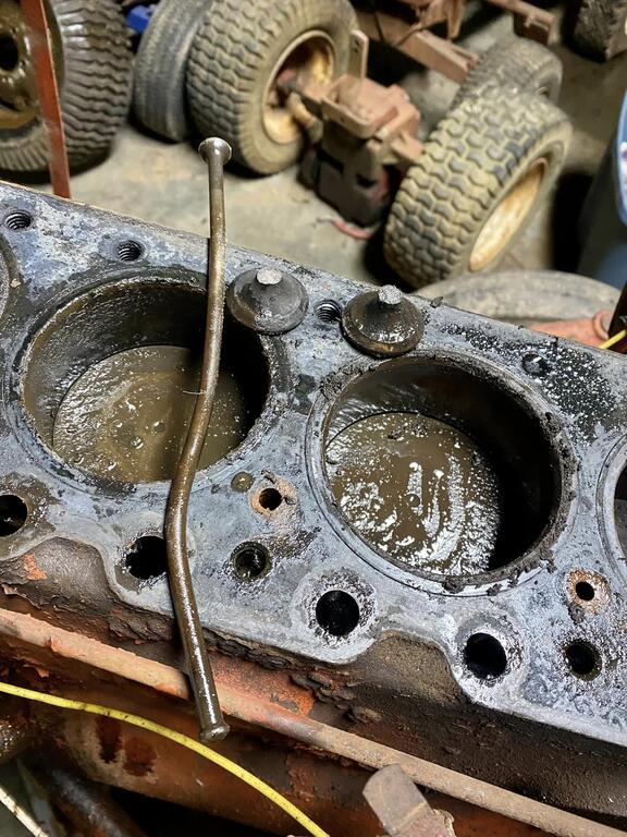

Pullstart 63,896 #6 Posted May 18, 2023 Wow, that valvetrain was BUSTED! Cool project Scott! 1 Share this post Link to post Share on other sites

Greentored 3,220 #8 Posted May 18, 2023 Theres a short clip in one of the first youtube vids of this thing running before disassembly. I drained a gallon of water out of the crankcase and another cup out of #2 and 3 spark plug holes. It actually sounded somewhat ok! Found the stuck exhaust valves when I pulled the valve cover- think I jammed them into the pistons when trying to bang them loose- theres no way it ran with those valve heads laying in there. Cylinder 3 had so much rust, pitting and 'swelling' I dont know how it spun over at all! All that mess and the bottom end was perfect. I purchased a used cylinder, one set of rings, shoved the pistons down to BDC and ball honed what I could, slapped a new set of exhaust valves and 2 springs in- bout as back yard as it gets, and the ol girl runs like a watch! 1 Share this post Link to post Share on other sites

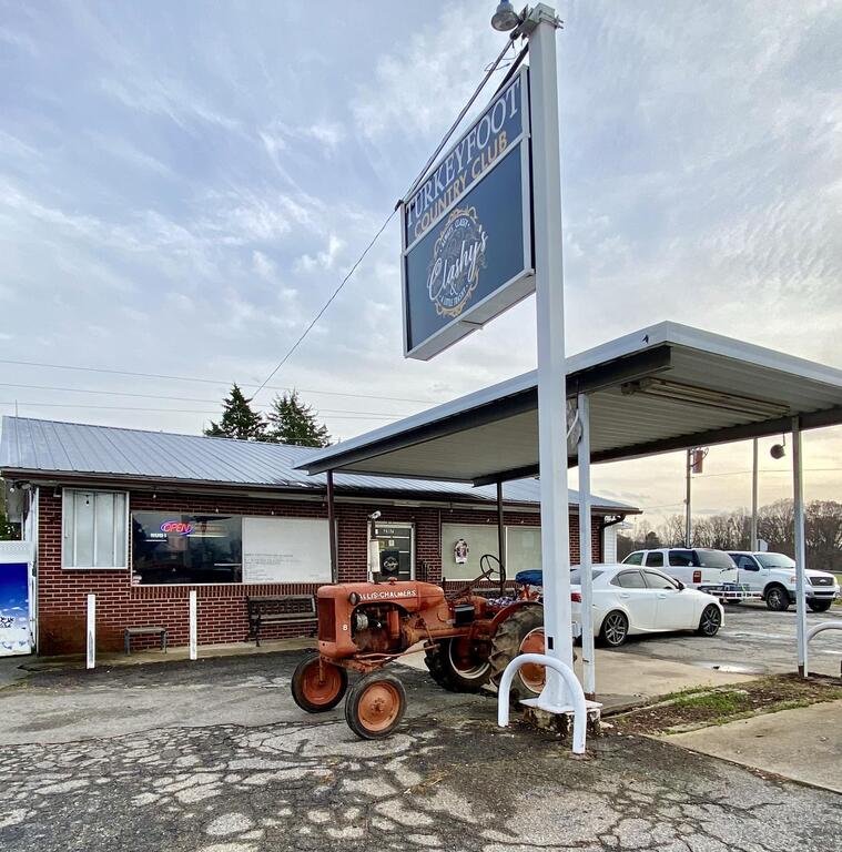

mrc 859 #10 Posted May 19, 2023 hi greentored, how far is that watering hole from your shop? what a great town to live in! wish i could do that!!! nice work on the tractor Share this post Link to post Share on other sites

ACman 7,629 #12 Posted May 19, 2023 (edited) Love the stance on the tractor . I’ve been around orange tractors my whole life as my family farms with them and also sold them at our dealership . I want to discuss the water in the engine issues on these tractors and for many others . The issue is where the muffler clamps onto the exhaust manifold and that’s where the water gets in . These aftermarket mufflers don’t have a shroud around the end that keeps the water from going past the threads on the muffler so even if it has a flapper or you put a can over the top of the muffler the water just runs down the outside of the muffler into the manifold . If you have some old iron outside that you don’t want to ruin remove the muffler and put a can directly over the manifold and notch if you have to so it fits . Edited May 23, 2023 by ACman 1 2 1 Share this post Link to post Share on other sites

Greentored 3,220 #17 Posted May 22, 2023 On 5/19/2023 at 8:48 AM, ACman said: These aftermarket mufflers don’t have a shroud around the end that keeps the water from going past the threads on the muffler so even if it has a flapper or you put a can over the top of the muffler the water just runs down the outside of the muffler into the manifold . Yes sir, was thinking the same thing! The threads look pretty bad on this manifold- someone clamped a pipe adapter over the outside then clamped a section of pipe to that, then to the muffler. It got a good slathering of orange high temp RTV at all connections for some extra insurance, inside and out. This is my first 'big' tractor- there is a hole in the manifold near that threaded outlet, maybe 1/2"dia- what was that for? Someone made a sheet metal shield to cover it, clamped to the pipe to hold in place. I filled that with the RYV as well and 'glued' the sheet metal to it on top of clamping it. 1 Share this post Link to post Share on other sites

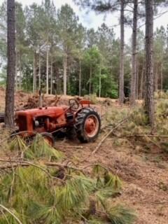

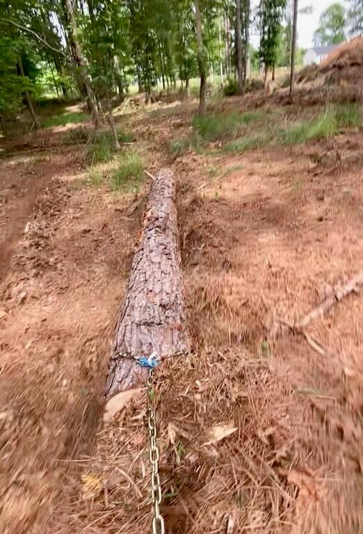

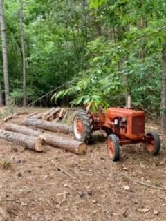

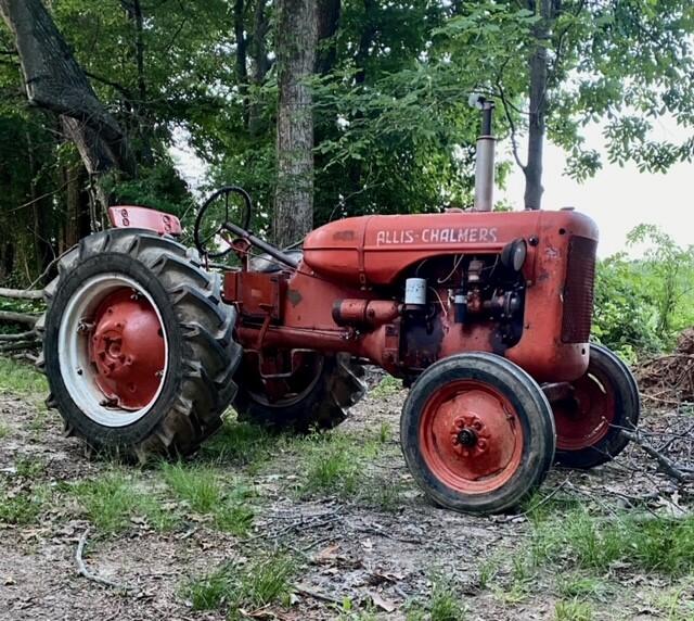

Greentored 3,220 #18 Posted May 22, 2023 She went to her temporary forever home this weekend and went straight to work dragging logs all day. Aside from a little chunk of dirt in the fuel inlet which was quickly resolved, she never missed a beat. I cant get over how much grunt and capability these little buggers have! I put her up to a couple dang big logs and she dragged em around just off idle like nobodys business- will easily dig a hole before it runs out of power! 1 1 Share this post Link to post Share on other sites
Greentored 3,220 #19 Posted May 22, 2023 On 5/18/2023 at 8:06 PM, mrc said: hi greentored, how far is that watering hole from your shop? what a great town to live in! wish i could do that!!! nice work on the tractor Thanks! Its a nice 2 mile back country ride- farm equipment is not uncommon. Course they're probably not supposed to be parked at a bar either Just gotta go real easy on the refreshments and enjoy the ride instead.... 2 Share this post Link to post Share on other sites

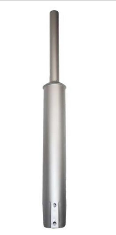

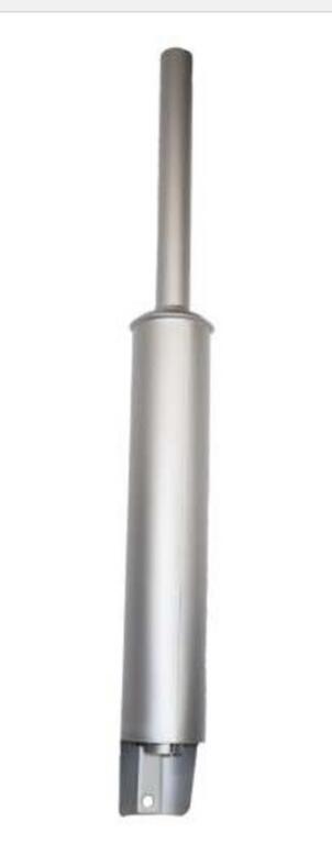

ACman 7,629 #21 Posted May 23, 2023 @Greentored I do see you have a large hole in the hood . This is what an original muffler with shroud should look like . This is a high quality restoration part . I’ll give a plug to DJS tractor parts . He’s actually a local guy and ex Ford engineer with many connections in the parts manufacturing world . He’s actually gotten a few nos parts from my dad had them reproduced and are now sold through many companies. 1 Share this post Link to post Share on other sites
Greentored 3,220 #22 Posted May 24, 2023 Very interesting! ...and no water ingestion haha 1 Share this post Link to post Share on other sites
