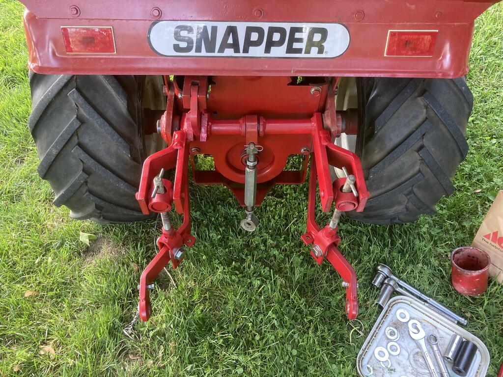

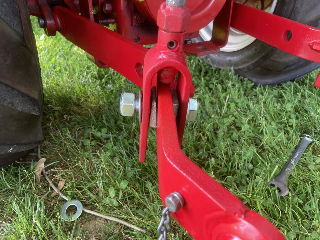

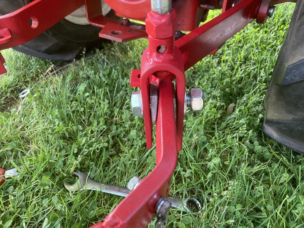

"Manic-Mechanic" 1,196 #1 Posted May 13, 2023 (edited) Combined Toro Lower Lift Links to Snapper cat 0 3pt, couple 5/8 holes here an there. Also, some wedges to stabilize the lift links, (otherwise they would twist) Fabricating chains & clevis turnbuckles next. Edited May 13, 2023 by "Manic-Mechanic" 6 2 Share this post Link to post Share on other sites

oldlineman 1,487 #4 Posted May 13, 2023 Hillside washers very good idea! Bob 1 Share this post Link to post Share on other sites
"Manic-Mechanic" 1,196 #5 Posted May 13, 2023 14 hours ago, Pullstart said: Well that doesn’t suck! Yea, I'll take it as a win,win. Need some from weight though... Share this post Link to post Share on other sites

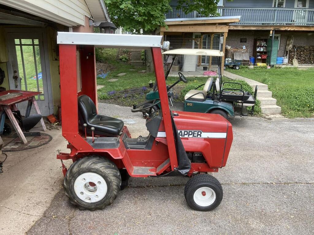

Pullstart 63,300 #6 Posted May 13, 2023 2 minutes ago, "Manic-Mechanic" said: Yea, I'll take it as a win,win. Need some from weight though... Tires loaded? What does the rest of the tractor look like? @WHX?? @Achto is this the kind of Snapper Massey Jason has? Share this post Link to post Share on other sites
Achto 28,062 #7 Posted May 14, 2023 7 hours ago, Pullstart said: @Achto is this the kind of Snapper Massey Jason has? Yes, this would be the same model. Jason's is sporting a 22hp Predator under the hood though. Share this post Link to post Share on other sites
"Manic-Mechanic" 1,196 #8 Posted May 14, 2023 8 hours ago, Pullstart said: Tires loaded? What does the rest of the tractor look like? @WHX?? @Achto is this the kind of Snapper Massey Jason has? 1 Share this post Link to post Share on other sites
"Manic-Mechanic" 1,196 #9 Posted May 14, 2023 8 hours ago, Pullstart said: Tires loaded? What does the rest of the tractor look like? @WHX?? @Achto is this the kind of Snapper Massey Jason has? No, tires are not loaded as yet but might consider this. 1 Share this post Link to post Share on other sites
