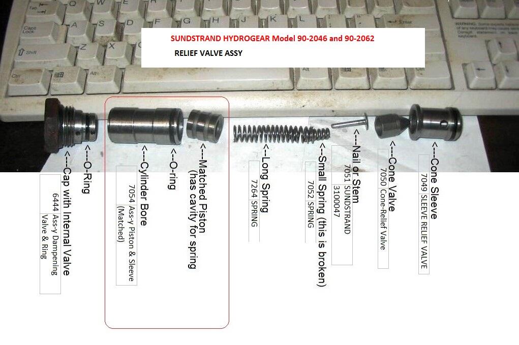

953 nut 56,005 #6 Posted May 11, 2023 10 hours ago, WHGuy413 said: started going up hill really slow Is the speed reduction on a hill the same in reverse as it is in forward? The fact that your lift works well leads me toward the acceleration valves. The spring on the acceleration valves will break and limit the ability of the transmission to transfer power. Lowell @wheelhorseman sels the springs. https://wheelhorsepartsandmore.com/product/transmission-acceleration-springs-2-7052-9215-2-7264-9858/ 1 Share this post Link to post Share on other sites
WHGuy413 2,756 #7 Posted May 11, 2023 3 hours ago, 953 nut said: Is the speed reduction on a hill the same in reverse as it is in forward? The fact that your lift works well leads me toward the acceleration valves. The spring on the acceleration valves will break and limit the ability of the transmission to transfer power. Lowell @wheelhorseman sels the springs. https://wheelhorsepartsandmore.com/product/transmission-acceleration-springs-2-7052-9215-2-7264-9858/ Yes! It will barely creep going up a hill in reverse but if I back up going down a hill it’s normal. Share this post Link to post Share on other sites
daveoman1966 3,762 #8 Posted May 11, 2023 In conjunction with my HYDROGEAR REFURB.pdf , there is a 4-page OEM manual on the Automatics. Pages 1 thru 3 deal with the Piston-to-Piston models (90-1136, 1137, 1140 etc) and the 4th page alone deals with the HYDROGEAR. Here is that FOURTH PAGE... Sunstrand Hydro (part 4).pdfI am also posting a photo of the actual dampening/acc valves that 953 nut alludes to. NOTE that the cone valve (7050) is often damaged ...yet is machined to match the cone sleeve (7049). Get the springs from Lowell. I may have some replacements if you have damaged parts. Share this post Link to post Share on other sites
