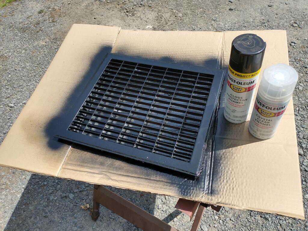

squonk 42,516 #33 Posted May 13, 2023 Painted this old floor register today. It was a med brown. Did not prep anything. 2 coats of black and 2 coats of clear. First coat of clear went on as soon as I set the can of black down. It's dry to the touch a half hour later. 4 Share this post Link to post Share on other sites
76c12091520h 3,785 #34 Posted May 14, 2023 My 2 cents: squonk is on the right track here. I'm a painter, it's what I do. I have a wall full of PPG certificates ( for whatever that's worth ). It puts me at unfair advantage in that if I want to paint something I just mix it and go. However, that doesn't mean that I never pick up a can of Rust Oleum. Rust oleum never dries , or put in different terms it never gets hard. If you're going to clear it do it right away. There is no reason to wait. When you wait to recoat Rust Oleum after it initially flashes off , you are re-activating the base color which leads to the cracking , lifting mess that we're all too familiar with. And yes you can coat Rust Oleum with a 2K ( hardened clear ) while the base color is still slightly tacky, I do it with some small parts occasionally with no side effects , but never a hood , fenders , etc. 3 3 Share this post Link to post Share on other sites
