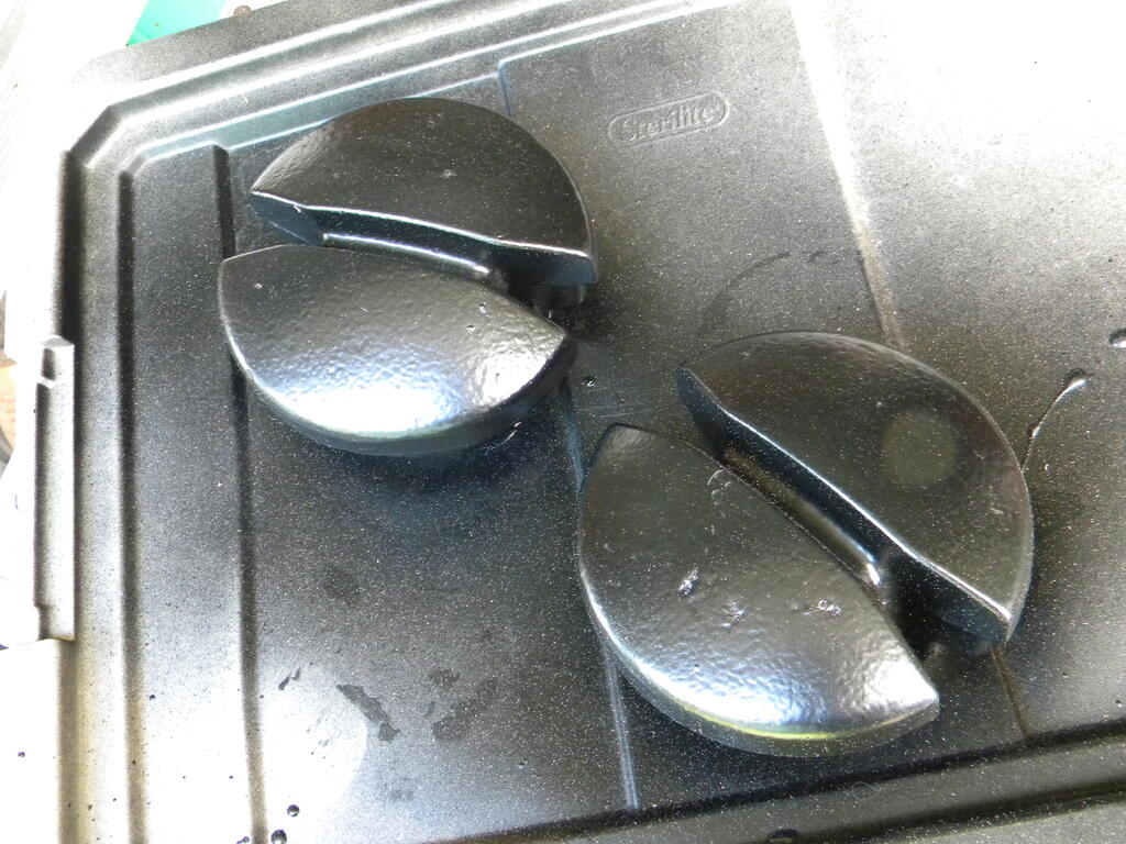

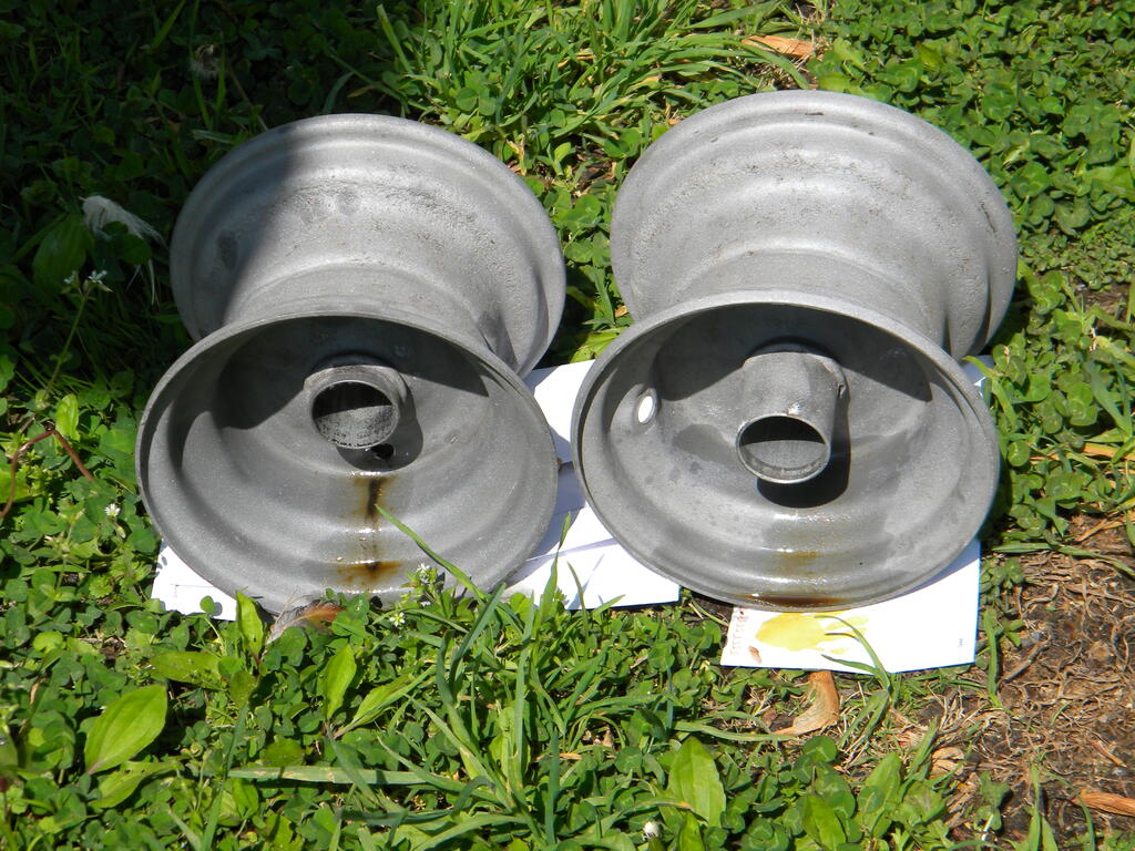

jeepdan 321 #1 Posted May 9, 2023 (edited) Prepping a pair of 6" front wheels for paint and new tires. Well, my painting plans have been put on hold until this unexpected oil stops seeping out of the freshly sandblasted wheels. It has been draining out since yesterday. After drilling two holes in each wheel to install some really cool 6" wheel weights. Edited May 9, 2023 by jeepdan 3 1 Share this post Link to post Share on other sites

jeepdan 321 #5 Posted May 9, 2023 (edited) 1 hour ago, Sparky said: If you’ve drilled two holes close enough to get into the center hub area then you’ve given a way for grit and dirt and sand to get in. Rims are shot now I would think. They aren't. I drilled holes near the outer rim on 3 1/2" hole center spacing. On closer examination, the holes for the grease fittings pass through the weld at the center hub. So maybe 30+ years of pressurized grease found it's way into the cavity through a crack in that area. Maybe Edited May 9, 2023 by jeepdan 5 Share this post Link to post Share on other sites
jeepdan 321 #6 Posted May 10, 2023 (edited) One extra photo for the heck of it. Still baffles my mind. Edited May 10, 2023 by jeepdan 1 Share this post Link to post Share on other sites
ineedanother 1,369 #7 Posted May 10, 2023 (edited) Lay them flat and clean well with prepsol or something similar. Prime and paint one side at a time and you'll be fine. A bit of a PIA but nothing I do seems to be anything less Those weights should look sharp BTW... Edited May 10, 2023 by ineedanother 4 Share this post Link to post Share on other sites
Darrenw85 625 #8 Posted May 10, 2023 The place that powder coats my wheels have had to heat my wheels in the over to get rid of the oil / grease. With the heat they still have trouble getting the grease to quit seeping out. 2 Share this post Link to post Share on other sites
Achto 28,417 #9 Posted May 10, 2023 Acetone bath followed by blowing off with an air gun. Repeat until they stay dry. This would be the procedure that I would try. 4 Share this post Link to post Share on other sites
Handy Don 13,163 #10 Posted May 10, 2023 12 hours ago, jeepdan said: One extra photo for the heck of it. Still baffles my mind. The weld that holds the hub to the wheel is only around the outside. I think you are correct that the drilled hole created a small opening into the space between the two halves of the wheel. There probably isn’t much grease in there but it’s enough to mess with your mind! 3 Share this post Link to post Share on other sites
