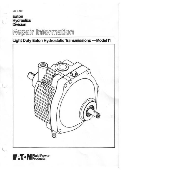

kpinnc 13,710 #16 Posted May 9, 2023 (edited) 3 hours ago, Dennis C. said: I don't have the strength or the knowledge. There is no one in my area that works on this old stuff. The Eatons are very simple to dig into- so far as the transaxle (main gearbox) is concerned. The pump sits on top of it. But the main gearbox can be opened fairly easy. It only has a few solid shaft reduction gears in it. But it's best to check the filter first. Hopefully its just something in a bind that can be corrected. I've seen a diff bolt loosen and contact the case, which locks the tranny down and can break the case depending on the speed when it catches. Edited May 9, 2023 by kpinnc 1 Share this post Link to post Share on other sites
Dennis C. 142 #17 Posted May 10, 2023 16 hours ago, kpinnc said: The Eatons are very simple to dig into- so far as the transaxle (main gearbox) is concerned. The pump sits on top of it. But the main gearbox can be opened fairly easy. It only has a few solid shaft reduction gears in it. But it's best to check the filter first. Hopefully its just something in a bind that can be corrected. I've seen a diff bolt loosen and contact the case, which locks the tranny down and can break the case depending on the speed when it catches. I've got some health issues to deal with first before I can dismantle the trans. I don't have access to a hoist or the like. At some point I'll drain the oil again and filter it for metal shavings. Then I'll try to remove the filter and cut it open. I'm 73 and projects move slowly these days. 1 1 Share this post Link to post Share on other sites
