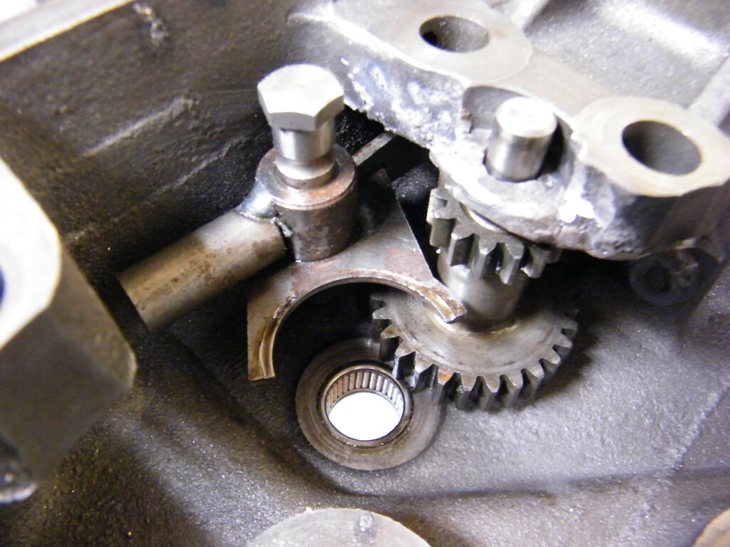

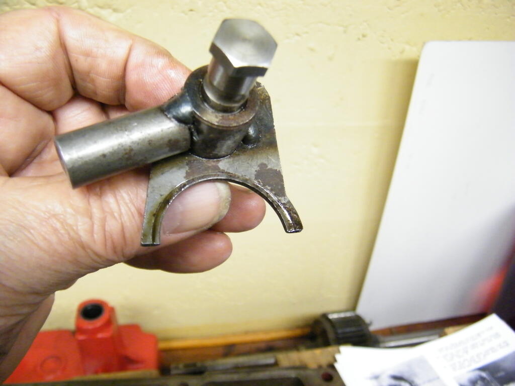

stevasaurus 23,072 #3 Posted May 6, 2023 Shifting between Hi and Low range involves a small fork gear and a fragile fork. The fork can wear, bend and even break one of the forks. If it still shifts, it is not broke, but it could be one or both of the other two. At this point, it is important to be at a complete stop and, using your feet to rock the horse back and forth a little, will usually work and save any more wear on those parts. Double clutching may also ease the selection for you. 4 2 Share this post Link to post Share on other sites
