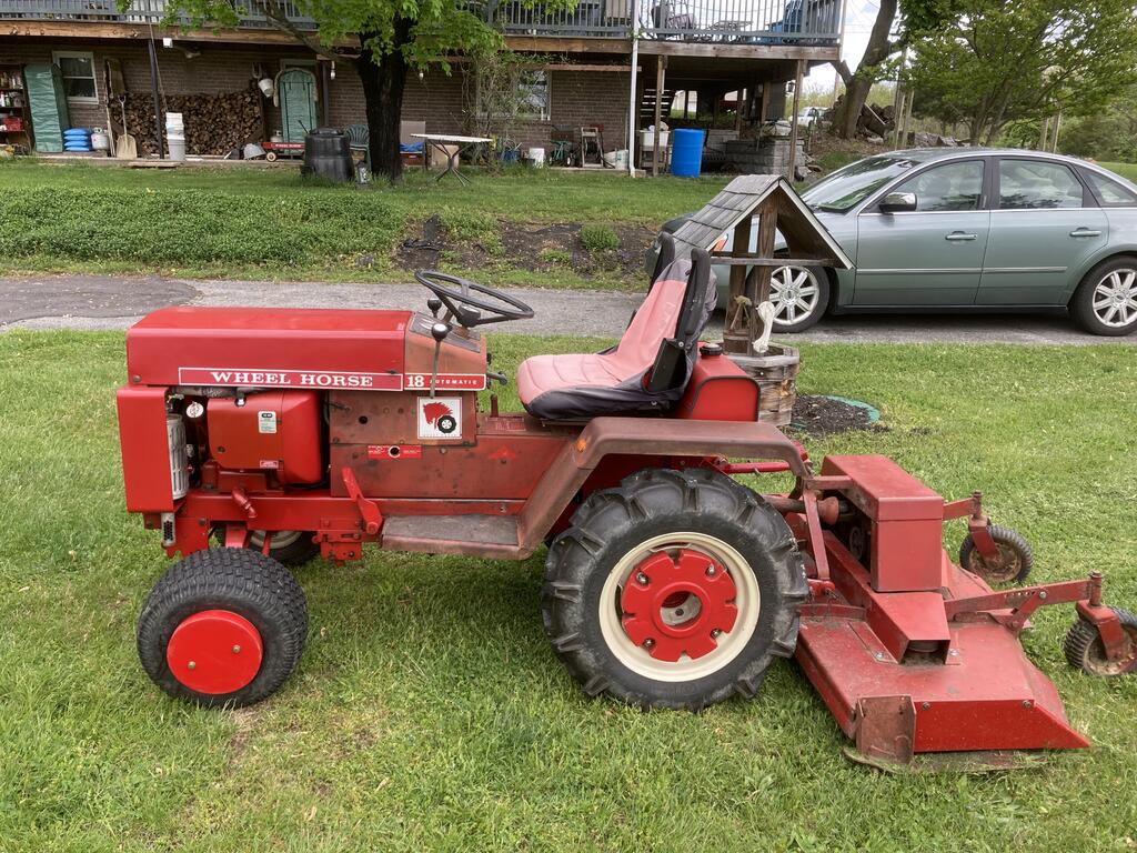

"Manic-Mechanic" 1,228 #1 Posted May 5, 2023 I had ordered up a set of 16” rear wheels with 32” ag tires.Running them with push blade or tiller is fine. However, the 3pt finish mower seems to be a burden? wheels too large? Share this post Link to post Share on other sites

"Manic-Mechanic" 1,228 #4 Posted May 5, 2023 17 minutes ago, Lee1977 said: It's that big mower, don't think the wheels have anything to do with it. With thick damp grass you might be going too fast. I wish that were the case, I cannot go up an incline even with the mower off and up. Share this post Link to post Share on other sites

"Manic-Mechanic" 1,228 #10 Posted May 5, 2023 37 minutes ago, 953 nut said: Was your going up inclines without any problems before you installed the new tires? Is the engine speed decreasing noticeably when going up a hill or is the transmission just not being responsive. Is the hydraulic lift good and strong? Is the problem more noticeable when the transmission is hot? Is the loss of power problem as bad in reverse as it is in forward? These questions can help narrow down the problem. The larger rear tires are only about 10% bigger than your previous tires +/- and shouldn't present a problem. As @kpinnc said I am inclined to think the Sundstrand needs some attention. Yes, everything leans towards the pump, especially if the tire size shouldn’t effect the torque all that much. The travel speed in forward is excellent but set slower in reverse deliberately. Yes, the wine is the same either direction. using the tiller is no problem, same with the blade. Only the 3pt mower is difficult on inclines. I have a nice rebuilt pump with really clean spline shaft, just tearing down is needed and procrastination has set in! Lol Really was researching the wheel size effect. So, probably won’t benifit to reduce rear wheels at this time? 3 Share this post Link to post Share on other sites
