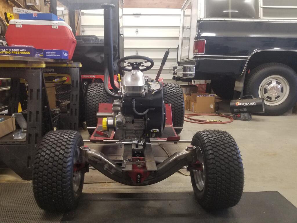

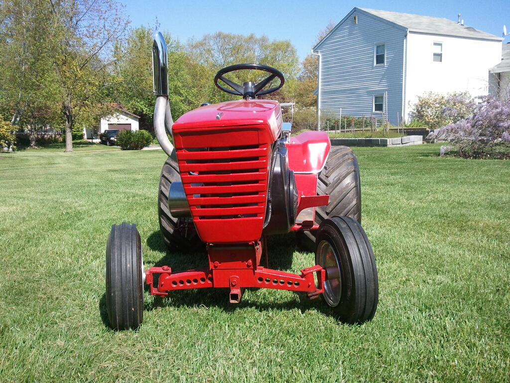

TonyToro 1,101 #11 Posted May 4, 2023 @brians306Yes you can flip upside down and use stock spindles. Many clubs don’t allow spindle flipping because of the possibility of breaking the spindle. You can also flip and use gokart front spindles off eBay, etc. That will bring it down even more. Check the rules of your club to figure out minimum rim size. Many say 6” is smallest. This one also check your rules. If you want an awesome front axle that’s a WheelHorse part….look for a Suburban axle. It will drop the front end even more than flipping and has a really cool look. I have a couple here that still need to get on two of our tractors. I’ll get a picture in the morning. Have you posted up a picture of your puller? We like pictures. Share this post Link to post Share on other sites
brians306 23 #12 Posted May 4, 2023 On 5/4/2023 at 1:21 AM, TonyToro said: @brians306Yes you can flip upside down and use stock spindles. Many clubs don’t allow spindle flipping because of the possibility of breaking the spindle. You can also flip and use gokart front spindles off eBay, etc. That will bring it down even more. Check the rules of your club to figure out minimum rim size. Many say 6” is smallest. This one also check your rules. If you want an awesome front axle that’s a WheelHorse part….look for a Suburban axle. It will drop the front end even more than flipping and has a really cool look. I have a couple here that still need to get on two of our tractors. I’ll get a picture in the morning. Have you posted up a picture of your puller? We like pictures. I will when I get the trans back in and rolling. its not gonna be pretty. just a old c160 with an m18, still in its infancy. 1 Share this post Link to post Share on other sites

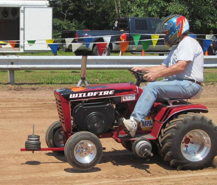

cruisnblue48 835 #17 Posted May 16, 2023 My C-120 puller... stock WH axle,,, spindles not so much... but I like this "look". 1 4 Share this post Link to post Share on other sites
TonyToro 1,101 #19 Posted July 1, 2023 On 7/1/2023 at 3:31 PM, Wild Bill 633 said: Sweet!! That’s a nice custom front end! Share this post Link to post Share on other sites
