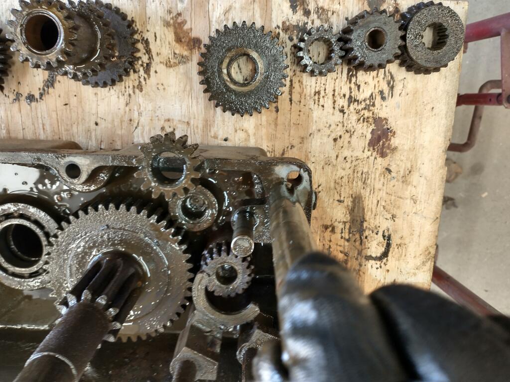

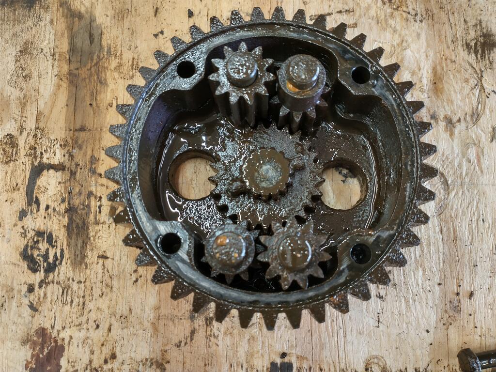

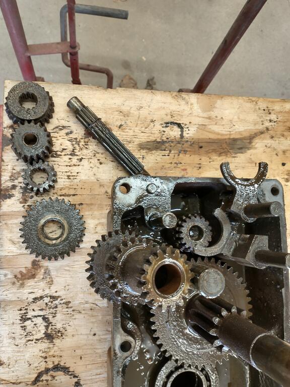

squonk 42,273 #23 Posted April 29, 2023 On 4/27/2023 at 12:52 PM, WHX?? said: And we know you are doing this because the are where??? Here. Can you smell the gear oil? 1 1 1 Share this post Link to post Share on other sites
WHX?? 50,461 #24 Posted April 29, 2023 5 hours ago, squonk said: Here. Can you smell the gear oil? Yes I have a dab behind my ears now... 8 hours ago, WH & IH's said: I know your just razzing me.. Getting one's stones busted happens alot around here... 2 Share this post Link to post Share on other sites
