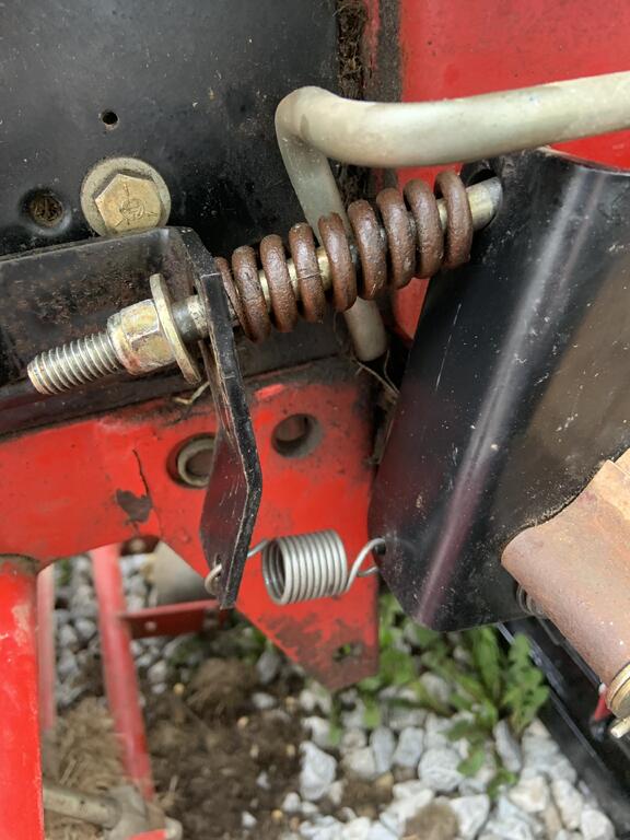

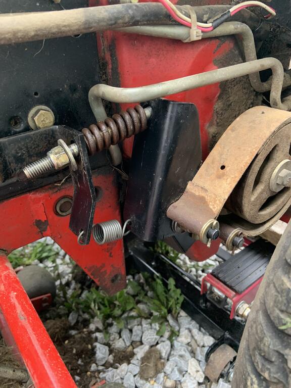

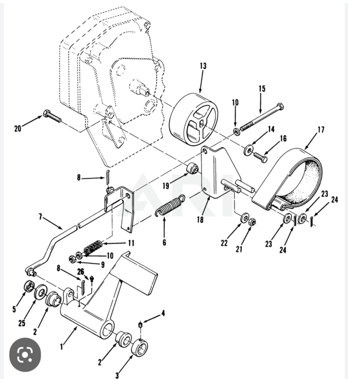

Canadaman 1 #1 Posted April 24, 2023 Hello from the North! I'm brand new here and just bought a 1997 Wheel Horse 520-H at a farm auction. Was told it was driven out of the shed and onto a trailer however, when I went to load it, there were no brakes and it drifted backwards with no forward or reverse. Figured it just needed some adjustments as the tractor is in great shape, and runs like a top. (600 hrs) I have the service & op manuals from Toro however, I cannot find any photos/videos of the correct brake & linkage position. It appears to have the original 3/8-16 x 4 1/2" bolt as spec, (Ref# 15 - Part# 323-23) however it seems a bit too long, and not enough thread left to tighten up. There looks like enough meat on the brake band but its not grabbing the drum. Could the spring have become compressed from sitting in a locked position, or should I add a bushing/washers to take up some slack? or is the brake band just worn down too far? Something doesn't look right or feel right. Any suggestions? Much appreciated. 1 Share this post Link to post Share on other sites

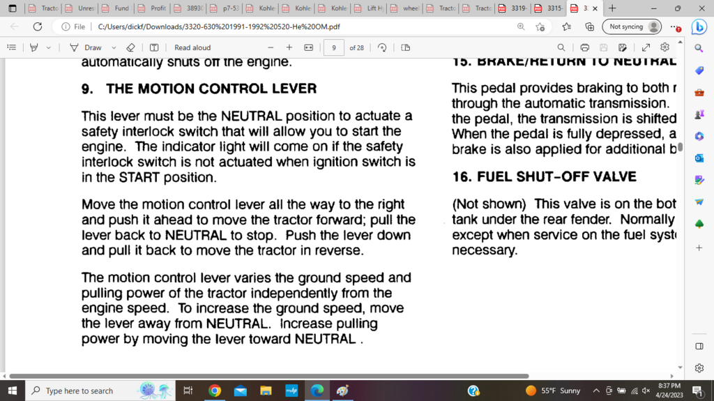

953 nut 56,487 #2 Posted April 25, 2023 (edited) Everything on the brake system appears to be correct. The brake peddle has to travel further forward to set the motion controller from reverse to neutral so if the spring is tightened too much it won't come out of reverse. The manual has a lot of good information on operating the Eaton 1100. There is a belt tensioner on the motion controller, to go forward you move the shift lever up and back toward you to position let the transaxle to operate. Edited April 25, 2023 by 953 nut I goofed, sorry! 1 Share this post Link to post Share on other sites
Ed Kennell 39,558 #3 Posted April 25, 2023 Put the spring on the other side under the nut and washer. 1 1 Share this post Link to post Share on other sites
953 nut 56,487 #4 Posted April 25, 2023 12 minutes ago, Ed Kennell said: Put the spring on the other side under the nut and washer. Ed, you are so correct. 1 1 Share this post Link to post Share on other sites
