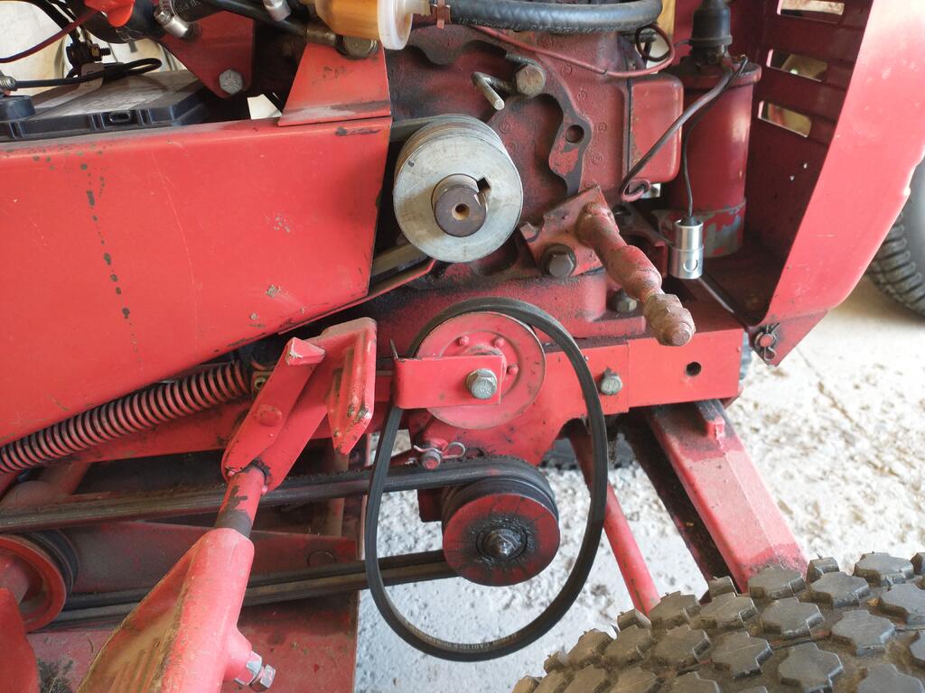

wallfish 17,189 #1 Posted April 23, 2023 This is for a custom so not WH typical stuff. Just some "thinking out of the box" type stuff Can a S/G be spun the opposite direction as the start motor is intended to turn without screwing up the start motor ? This is a S/G from a Simplicty?(because it's short ) that I want to use as a motor only to drive something in reverse off the same jack shaft driving the wheel. Just wasn't sure if it will do some unintended damage to the windings. I don't see why it would be a problem but electronics is not my strong suit. Pulley sizes are not to scale Share this post Link to post Share on other sites

wallfish 17,189 #4 Posted April 23, 2023 (edited) Yes I'm 100% certain of the direction it turns. I had to power it up just make sure it works. Set like the drawing above it will reverse the direction to the wheel when power is applied. It's painted Simplicity orange so that's just a guess. Looks original paint. This is an old school one because it has the flip cap oil ports on it Edited April 23, 2023 by wallfish 2 1 Share this post Link to post Share on other sites

wallfish 17,189 #6 Posted April 23, 2023 So the consensus is ? spinning it the opposite direction shouldn't screw the start motor stuff up? I'm probably going to find out anyway unless someone says it's a problem but didn't want to waste a whole bunch of fab time and effort mounting it and changing a few things only to see some magic smoke. If it still produces power too then maybe try to figure something out to use it if it does. The engine charging system is good. Also thinking about a way to just engage the belt when the motor is needed and not spin it all the time 2 Share this post Link to post Share on other sites

Handy Don 13,079 #15 Posted April 23, 2023 20 hours ago, wallfish said: Can a S/G be spun the opposite direction as the start motor is intended to turn without screwing up the start motor ? This is a S/G from a Simplicty?(because it's short ) that I want to use as a motor only to drive something in reverse off the same jack shaft driving the wheel. Just wasn't sure if it will do some unintended damage to the windings. I think we need @Achto in on this. My suspicion is that an S/G driven backward is more a problem of how the brushes might be angled to work smoothly in the correct direction and chatter or catch in reverse. From my basic (way old) electrical courses, an S//G driven backward will generate reverse voltage (speed dependent). If wired backward at the “starter” and ground, it will motor backward. But this leads to a question--how are you gonna isolate the shell of the S/G (which is the ground electrically) so that you can juice it with +12v and make the ground the terminal so as to make it spin in the “wrong” direction (I guess you could also put -12v on the starter terminal and not mess up the other wiring)? Share this post Link to post Share on other sites
Achto 28,183 #16 Posted April 23, 2023 Honestly I'm not sure how spinning the S/G backwards would effect it. @Handy Don pointed out some possible effects of doing so. Is it possible to disengage the S/G belt when it is not being used for reverse? I have seen some Harley's with a side car that used a Bendix style starter on the side car wheel for reverse. Share this post Link to post Share on other sites
wallfish 17,189 #17 Posted April 23, 2023 17 minutes ago, ebinmaine said: We have the pedal but nothing else. I can pass it along to Sparky for sure. Thanks !!! 3 minutes ago, Handy Don said: I think we need @Achto in on this. My suspicion is that an S/G driven backward is more a problem of how the brushes might be angled to work smoothly in the correct direction and chatter or catch in reverse. From my basic (way old) electrical courses, an S//G driven backward will generate reverse voltage (speed dependent). If wired backward at the “starter” and ground, it will motor backward. But this leads to a question--how are you gonna isolate the shell of the S/G (which is the ground electrically) so that you can juice it with +12v and make the ground the terminal so as to make it spin in the “wrong” direction (I guess you could also put -12v on the starter terminal and not mess up the other wiring)? Isolation if necessary can be achieved with some plastic tube and washers at the mounts. I don't need to reverse polarity to spin the motor in the direction I want. The normal operation of it is the correct direction. I won't have the F connection connected to anything for the field of generation. The solenoid will be normally open when not motoring it so that isolates the + power side and maybe a diode in the start wire to the solenoid but IDK. A solenoid for the ground wire can isolate that the - side With the pedal from EB, it shouldn't be spinning except for engaging the motor to drive reverse. 2 Share this post Link to post Share on other sites
