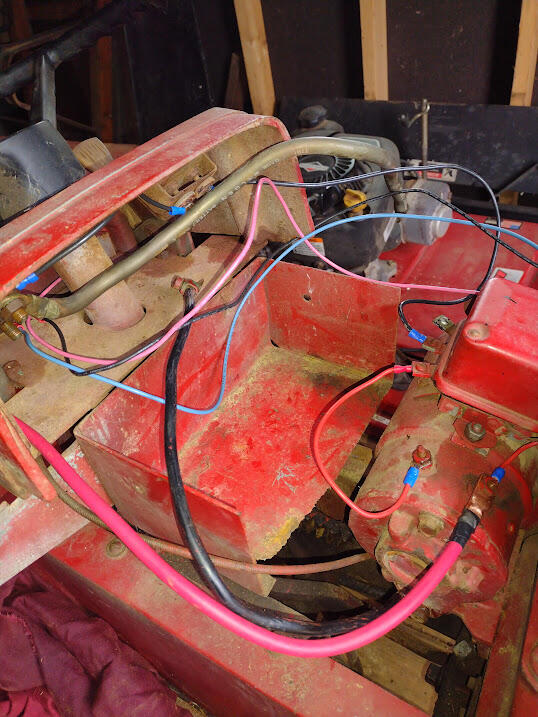

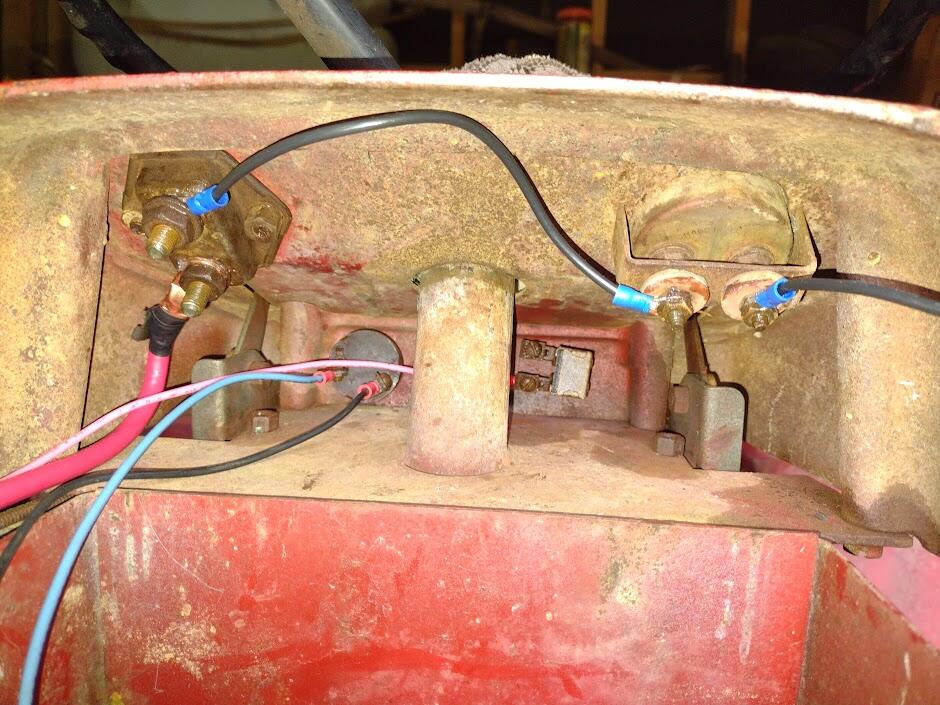

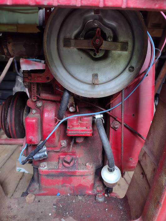

I have been rewiring the 1054 that I have had for a while. I posted last week about the replacement engine. The tractor still has the original split key and starter button but no longer has coil ignition. It does have points but the plug wire comes from behind the flywheel cover and another wire also comes from below it. The generator light has been replaced with an amp gauge. I rewired it like it was wired when I got it except the colors. I need to know where the other light switch wire goes and also if the other wiring appears correct. From the key switch the blue wire goes to the points and condenser and the black wire from behind the flywheel, is this correct for this ignition system. Any help is needed. I will clean up the wiring after it is running. Thanks!!

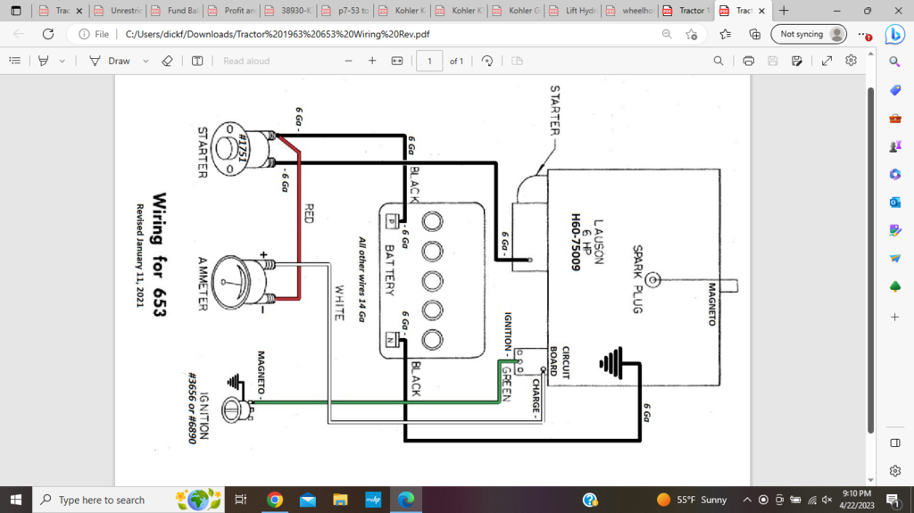

Use this diagram as a guide with the exception of the S/G which would be like the 953 wiring.
