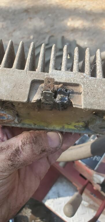

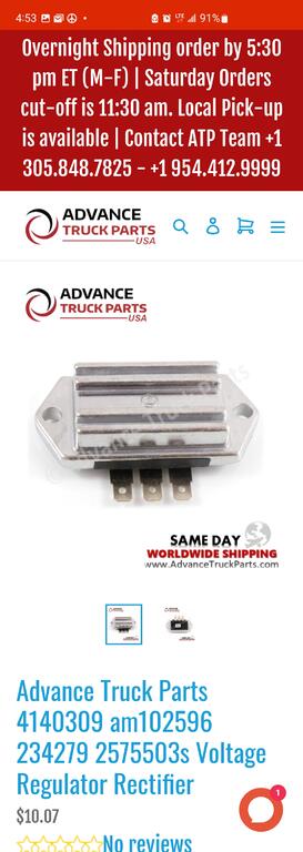

chorusguy 227 #1 Posted April 19, 2023 I'll try not to be long here, but I am very ignorant. Have t run my tractor in a couple of years. When I tried to start it the last time, had mo spark. Noticed I had a couple of wires disconnected and looked at my other tractor and by comparison, discovered they go to the voltage regulator. Pulled it and there is some significant charging. Did a little reading and saw some talk about ac and dc tabs and I was lost. So, first of all, how many tabs us it supposed to have? Secondly, I've seen aftermarket ones with three tabs and wonder if they will work, thirdly how to wire the aftermarket ones, and fourthly, can I find an NOS regulator anywhere? Thanks in advance 1 Share this post Link to post Share on other sites
chorusguy 227 #2 Posted April 19, 2023 lord, my spelling. Regulator is charred, not charging. Haven't run tractor in a couple of years. 1 Share this post Link to post Share on other sites
ebinmaine 69,706 #3 Posted April 19, 2023 Should be 2 AC terminals and 1 DC or Batt terminal. I'd say you're missing an AC wire terminal to mate the other one. My suggestion is to contact a tractor salvage yard like Lincoln at A to Z Tractor in PA and get: A good regulator. A replacement plug. A few inches of good harness. That way you can splice in a proper non meltified connection. 2 Share this post Link to post Share on other sites
chorusguy 227 #4 Posted April 19, 2023 Thanks. For clarification, the bottom connection goes tonthe ammeter, which then returns to the battery? There is no plug, just bladed connections unless you are describing the attachments on the regulator 1 Share this post Link to post Share on other sites
gwest_ca-(File Mod) 11,176 #5 Posted April 19, 2023 Got an ohmmeter? See if the burnt off terminal is connected to the DC+ terminal. One AC terminal is connected to the DC+ terminal and the other is not. If the burnt terminal is connected to the DC+ inside the regulator (0 ohms) connect one AC wire from the stator to the DC+ terminal and it will work. You end up with 2 wires on the DC+ terminal. If it works clean/polish the remaining terminals and apply dielectric silicone grease to all the terminals to prevent future corrosion. Also make sure the female terminals grip the flat spades tight. Loose and corroded terminals causes heat and the cause of your problem. The body of the regulator requires a good battery ground. The small regulator will work if you mount it in the blower housing. The flywheel fan can then cool it. The large finned regulators do not require a fan. 2 Share this post Link to post Share on other sites

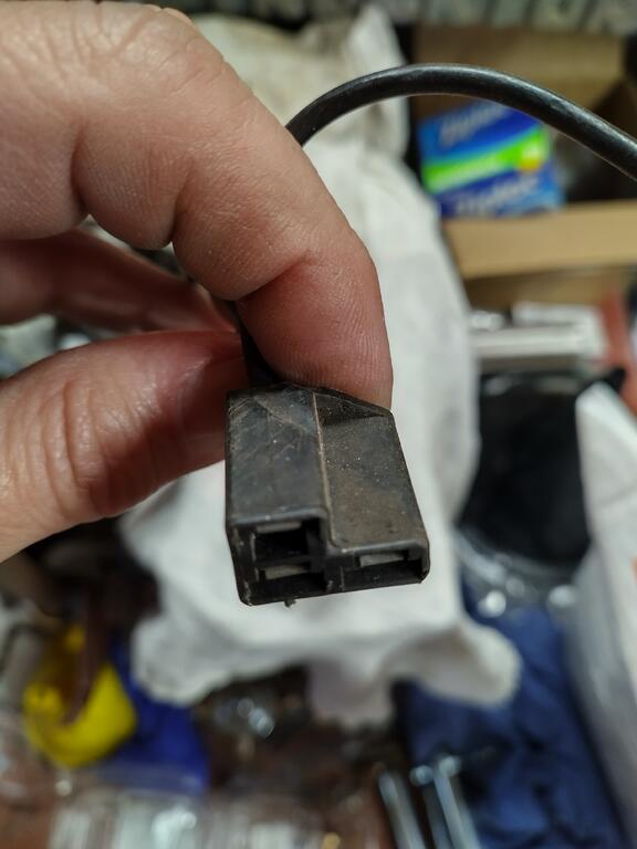

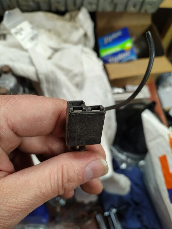

ebinmaine 69,706 #6 Posted April 19, 2023 19 minutes ago, chorusguy said: Thanks. For clarification, the bottom connection goes to the ammeter, which then returns to the battery? One of the future project tractors I have with a Kohler engine, the DC wire FROM the regulator goes directly to the ignition switch. I can't tell where the two wires connected to the ammeter would normally go to and from because the harness on this machine has been modified. 19 minutes ago, chorusguy said: There is no plug, just bladed connections unless you are describing the attachments on the regulator Here's what the Voltage Regulator plug looks like. 1 Share this post Link to post Share on other sites

ohiofarmer 3,314 #12 Posted April 20, 2023 (edited) I am pretty sure that Isavetractors has a modern and cheaper rectifier replacement.. If i am reading their info correctly , Two of their four units are said to fit K engines with 15 amp charging systems. one of them fit the mounting of OEM mounting plate.Prices are 29.99 and 44.99 for the larger OEM style replacement. On wheel horses i have worked on, it is common for the plug that fits the regulator/rectifier to get loose and then bad stuff happens. I got my first c-160 for a bargain because the PO did not figure out the problem. The connection is at an awkward location and is a problem to keep tight..Of course I would not expect these things to be USA made like the originals. It appears as well that the jungle website has both types as well for even better pricing. Edited April 20, 2023 by ohiofarmer Share this post Link to post Share on other sites
