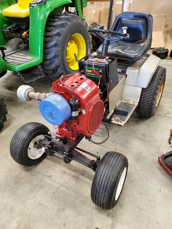

Moparfanforever 874 #1 Posted April 15, 2023 I put this 16HP K Series in my GT 1848 and it has the deep air filter cover that comes in contact with the headlights in the hood. Does someone have a picture or can tell me what type of air cleaner is used in this style of tractor with a K series engine?? Like a 416. Or do they use the shallow style air filter like on a 10,12,14 HP tractor?? That doesn't sound like it would be right, but I don't know. Thanks!!! 2 Share this post Link to post Share on other sites
squonk 42,534 #2 Posted April 15, 2023 (edited) The 16 's used the filter you have. The smaller 12,14 one will work fine. The air cleaner base is the same. Just use the more shallow filter and cover. Edited April 15, 2023 by squonk 3 Share this post Link to post Share on other sites

Moparfanforever 874 #4 Posted April 15, 2023 14 minutes ago, squonk said: The 16 's used the filter you have. The smaller 12,14 one will work fine. The air cleaner base is the same. Just use the more shallow filter and cover. Thanks,I will put one on. Share this post Link to post Share on other sites
Moparfanforever 874 #5 Posted April 15, 2023 10 minutes ago, Lee1977 said: The magnum series the filter housing was recessed back over the carb and the cap was also recessed and under the plastic cover. The choke arm was also longer. I tried a plastic Magnum filter cover, looked a little weird, but I will use it if I have to. Share this post Link to post Share on other sites

gwest_ca-(File Mod) 11,243 #8 Posted April 16, 2023 Filter dimensions are listed here. Checking the 16hp Kohler's Wheel Horse used looks like 6" OD x 4-5/8" ID x 3" HT was the filter used. Wondering if the smaller filters would starve the engine. Adding a pre-filter fills the cover. 2 Share this post Link to post Share on other sites
Moparfanforever 874 #9 Posted April 16, 2023 I am also wondering about the smaller filter starving the engine since Kohler put a taller filter on 16HP engines. Anyone have a 416 with a K series that can chime in ??? Share this post Link to post Share on other sites
jeremi3210 742 #10 Posted April 16, 2023 Had the same problem with my gt1800 when I had the k341 in it. I just put the shorter filter on it and it worked fine. Took me a little bit to figure out why i was blowing fuses with the lights on and going up hill! 1 Share this post Link to post Share on other sites
WHX?? 50,730 #11 Posted April 16, 2023 The one I pictured is bigger in diameter so guessing almost the same filter opening as the long but smaller diameter ones. I put Fram CA77 filters in them with no prefilter. Share this post Link to post Share on other sites
23 Reo 229 #12 Posted April 17, 2023 If you use the thinner K filter you may want to use it's base with the shorter threaded rod. Keep the thicker filter for something else. You will be fine. Just keep the filter foam clean. 1 Share this post Link to post Share on other sites
