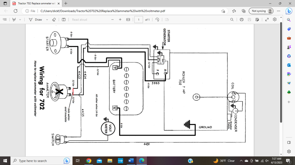

953 nut 57,904 #2 Posted April 13, 2023 I presume you connected one wire from the volt meter to ground and the other to your ignition switch terminal that sends power to the ignition coil +. If the wires from the volt met5er were not labeled to let you know how they should be hooked up they might be reversed. Try swapping them around. There is a diagram in this download that shows the wiring with a volt meter. 2 1 Share this post Link to post Share on other sites

953 nut 57,904 #7 Posted April 13, 2023 20 minutes ago, Bob Bauer said: There was a amp gauge on there at first and was told to put are you voltage gauge instead so I put on a brand new one on there. Is it hooked up like the wiring diagram I furnished above? Share this post Link to post Share on other sites

953 nut 57,904 #13 Posted April 13, 2023 If you carefully compare your wiring to this drawing I'm sure you can find the problem and correct it. When you turned the ignition key OFF did the volte Meter go to zero? Share this post Link to post Share on other sites
Bob Bauer 27 #14 Posted April 14, 2023 (edited) It never moved off of 0 at any time running or not.The only difference I did from that drawing is I didn’t connect the old amp gauge wires together, I ran the center wire off the voltage regulator straight to the + battery because I believe it would be doing the same thing by connecting the 2 wires together at the amp gauge and leaving them up in the dash . I asked someone on red square and they said it should be okay. Edited April 14, 2023 by Bob Bauer 1 Share this post Link to post Share on other sites
