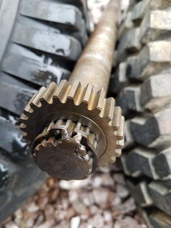

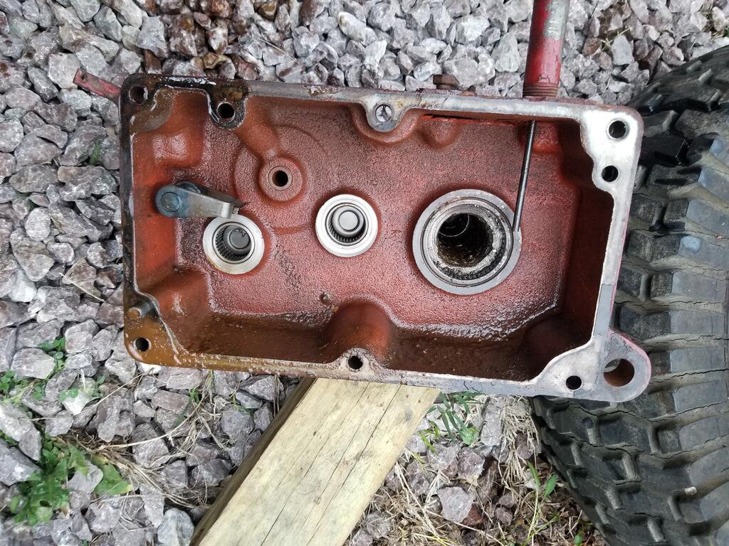

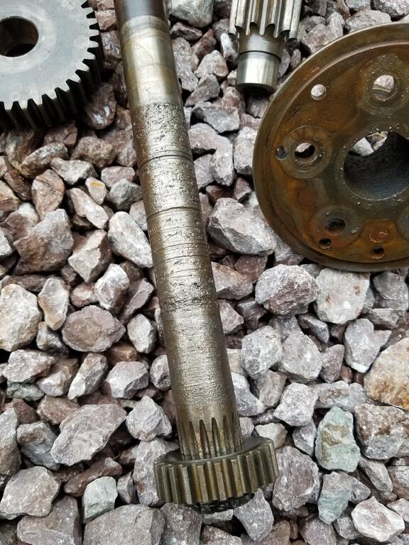

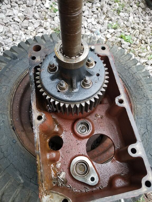

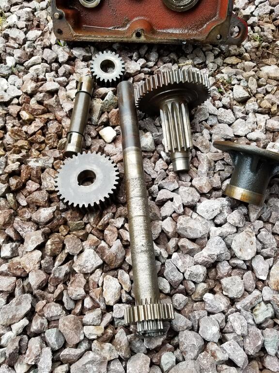

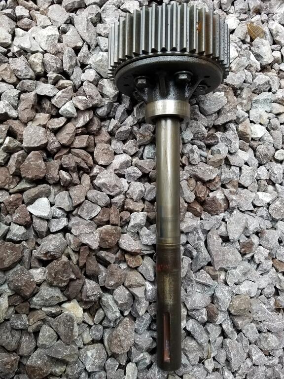

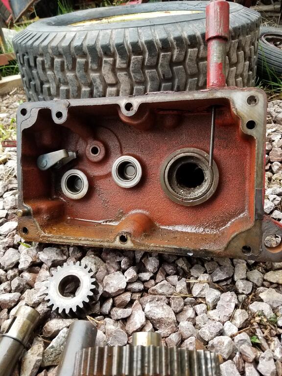

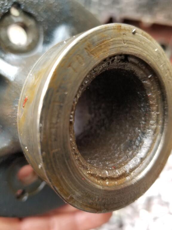

cafoose 3,383 #1 Posted April 8, 2023 (edited) I got the GT-14 trans-axle disassembled. Looks like I need some parts The axle that's bad is 1 1/8 by 15". I also need a bearing in the case and I can't find the keys from the short shaft between the two gears one of which is the parking brake gear(short shaft in picture 6). The parking brake is worn down but I had the same thing happen on my 876 and had it welded up. Now the 876 parking brake is working great Do I need anything else? Maybe I should replace the one side of the diff (picture 4) that the diff bolts goes through because it's scuffed up where it contacts the axle Edited April 8, 2023 by cafoose 2 Share this post Link to post Share on other sites
daveoman1966 3,795 #2 Posted April 8, 2023 I have listed n Ebay the SHORT side of the differential end cap...with bearing. Look at item # 133128006054 for pics and description. Can't help you with the scored up 15" axle. 1 Share this post Link to post Share on other sites
953 nut 57,602 #3 Posted April 8, 2023 @19richie66 or @Shuboxlover may have a pair of axles they could part with. 1 Share this post Link to post Share on other sites
19richie66 17,560 #4 Posted April 9, 2023 (edited) Try @Pullstart. Sorry, I have no gt14 axles. Edited April 9, 2023 by 19richie66 2 Share this post Link to post Share on other sites
ri702bill 8,927 #5 Posted April 9, 2023 Looks like you caught it in time - loose bearing needles can ruin the gears... and other things. 1 Share this post Link to post Share on other sites
