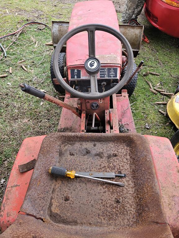

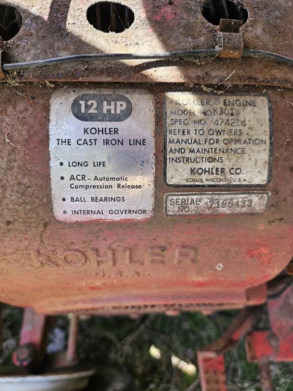

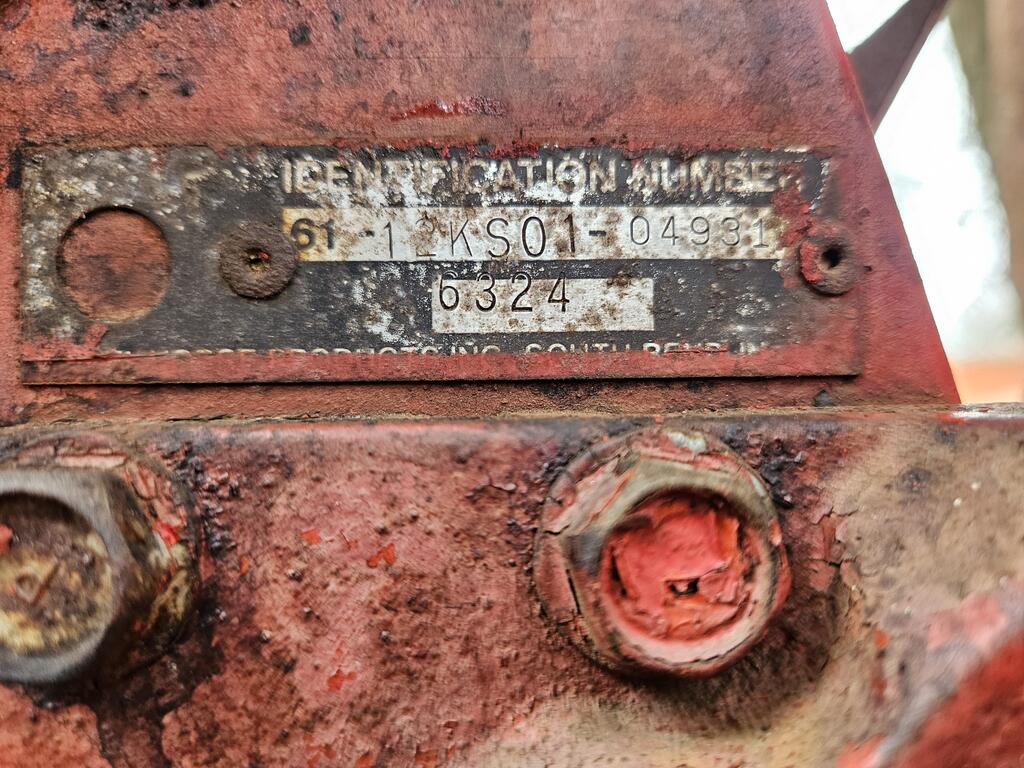

Frank DeHaven 27 #1 Posted April 6, 2023 I am asking for help! I came across this wheel horse c-120 automatic. For some reason it was crying out please restore me. So I got it for $100. I know nothing about it I have some numbers that I took pictures of that I will upload. Any information no matter how small that you could give me I would very deeply appreciate it. Thanks for your time. 3 3 Share this post Link to post Share on other sites
Pullstart 64,582 #2 Posted April 6, 2023 We have a couple great resources here, a full manuals section and we have created some “new to the herd checklists” as well. If you feel stumped, odds are someone has experienced it before. 2 1 Share this post Link to post Share on other sites
Pullstart 64,582 #3 Posted April 6, 2023 Here is the search result for everything “61-KS01“ as well. 1 1 Share this post Link to post Share on other sites

gwest_ca-(File Mod) 11,246 #8 Posted April 6, 2023 Welcome to the forum. Here is everything we have for the 61-12KS01 https://www.wheelhorseforum.com/search/?q=61-12ks01&quick=1&type=downloads_file 4 Share this post Link to post Share on other sites

Frank DeHaven 27 #25 Posted April 13, 2023 I have looked everywhere for wiring diagram for my tractor. It is a 1976 wheel Horse c120 automatic and it has the Kohler 12 horse power engine. Maybe I'm blinder I don't know how to read but I just can't seem to find it. I found one for a 74 but I'm not sure if it's the same. Any help that anyone can give me would be greatly appreciated. Again thanks everyone for all the help that you've been giving me every time I tinker with it and get something else working I have a big smile on my face. 1 Share this post Link to post Share on other sites
