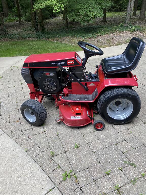

Darrell Floyd 4 #1 Posted April 3, 2023 My Classic GT Wheel Horse has been giving me some electrical problems. This winter I went thru all the connections because it was hard to get it to turn over. Once the key was turned a lot of times it would just grunt and not turn over the starter until it caught and then it started right up and ran great. It's been doing that for a long time and was just a nuisance until now. Today the PTO quit first a few times then the 426 cc Kohler quit and ran a few times until it died. It won't do anything now except turn on the lights. The battery is fully charged. I have gone thru the safety cut offs before but not recently and I find it to be a nightmare under there. Lots of times when it wouldn't catch a start I would jiggle the gear stick back a forth and it would catch. Is there anyway to override that stuff? I guess that's my next step. Any help would be greatly appreciated. I was also thinking of fault diagnosis by part substitution but where would start? Ignition switch, solenoid, starter? Anything else? My local Horse mechanic is backed up 4 to 6 weeks! 1 Share this post Link to post Share on other sites

Blasterdad 2,774 #5 Posted April 3, 2023 Wow, she's in great shape, shouldn't take much to get her going again. Try to find the model # under the the seat like @953 nut said. 39 minutes ago, Darrell Floyd said: Share this post Link to post Share on other sites

peter lena 8,957 #9 Posted April 4, 2023 @Darrell Floyd nice looking unit there, that area behind the dash , is noted for electrical glitches , especially cracked / shorted plug ins . look for a powerdry , outer finish on all connections , that will be your failure area . once you find it , would also add an additional battery ground cable from engine bolt down point to battery ground bolt , pete Share this post Link to post Share on other sites
