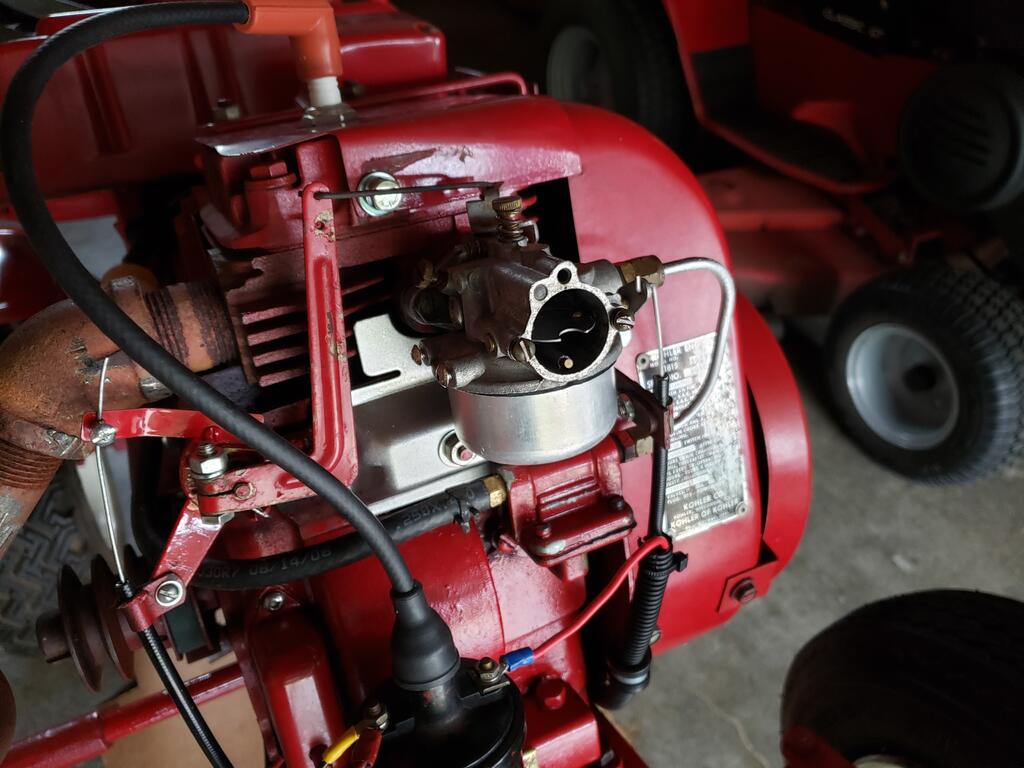

Racinbob 11,569 #26 Posted Wednesday at 03:21 PM I've always had issues with a very short throttle throw from idle to full on the 161's and 181's. This was my fix. 2 1 Share this post Link to post Share on other sites

Retired Wrencher 5,602 #28 Posted Thursday at 11:01 AM 19 hours ago, Racinbob said: I've always had issues with a very short throttle throw from idle to full on the 161's and 181's. This was my fix. Very interesting set up. Share this post Link to post Share on other sites
