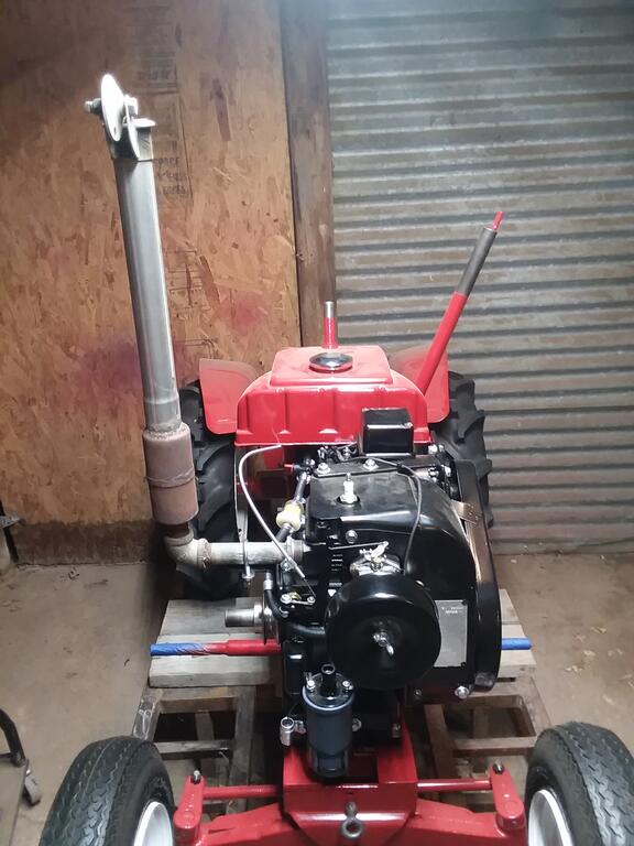

ineedanother 1,370 #76 Posted July 22, 2023 Very nice! Love the progress. You shouldn't want the condenser to sit upright if possible though. Water pooling on the business end from washing it or working in the weather can be no bueno Share this post Link to post Share on other sites

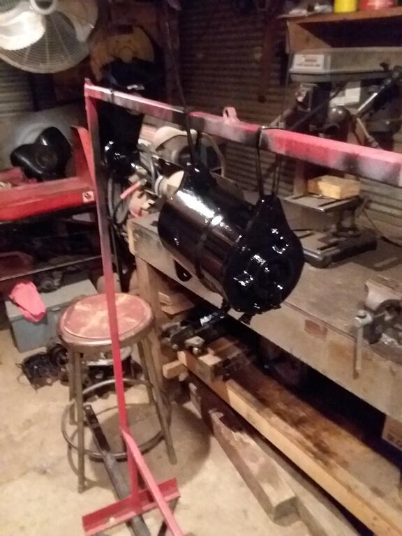

Chrishar 560 #77 Posted July 22, 2023 (edited) Got good news and bad news the starting part is good but the charging part is shot on the generator I will have to replace the shaft part has to much gap between it and the coils way to low of voltage to make the regulator work so far now it will start but will not charged Edited July 22, 2023 by Chrishar 2 Share this post Link to post Share on other sites
WHX?? 50,585 #78 Posted July 22, 2023 Generally if the SG starts it should generate. Bad regulator? Go through and check all grounds. Going through that now here with a 701. 1 Share this post Link to post Share on other sites
Chrishar 560 #79 Posted July 23, 2023 (edited) Had it at a shop that rebuild generators we had it on a test bench the generator wouldn't put out no more then 5 amps it should be 10 to 15 amps without the regulator on it the starter part does not use that miney amps to start Edited July 23, 2023 by Chrishar 4 Share this post Link to post Share on other sites

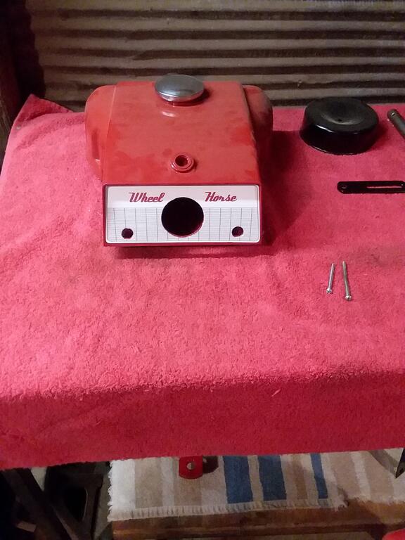

Chrishar 560 #80 Posted July 23, 2023 Got the gas tank ready to go on 5 2 Share this post Link to post Share on other sites

Chrishar 560 #82 Posted July 24, 2023 Fix the generator today and painted it too 4 1 Share this post Link to post Share on other sites

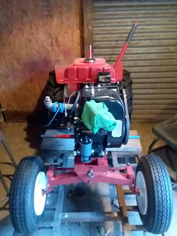

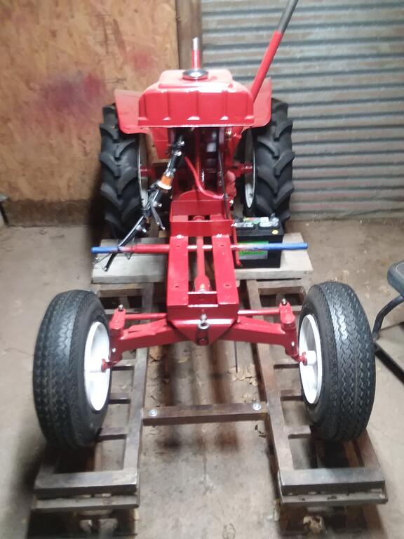

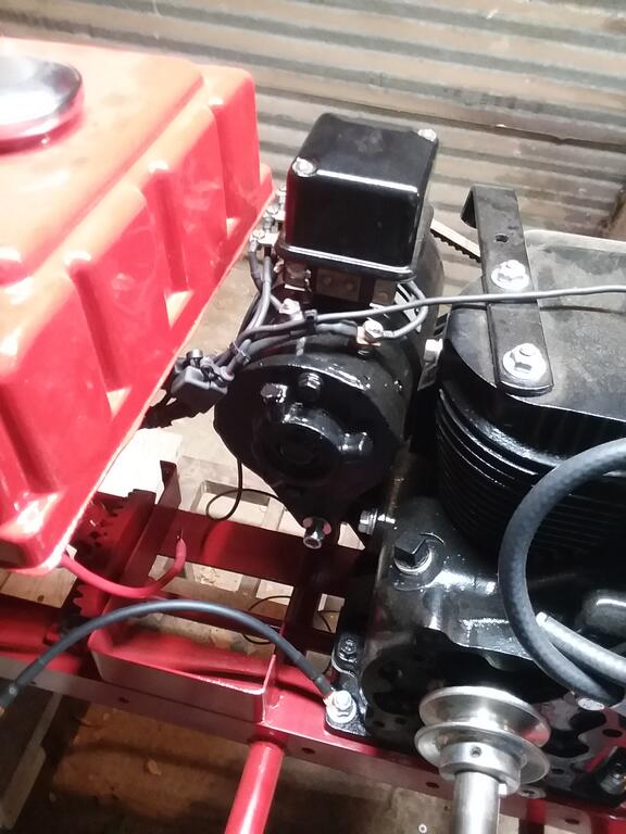

Chrishar 560 #83 Posted July 25, 2023 (edited) Got the generator, gas tank, upper steering shaft on and more of the wiring done too little closer Edited July 26, 2023 by Chrishar 5 1 Share this post Link to post Share on other sites

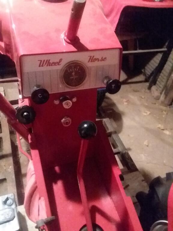

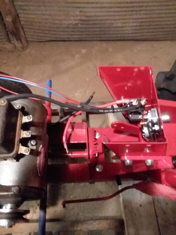

Chrishar 560 #85 Posted August 1, 2023 Got the wiring from the switches too the generator done just waiting for parts to come in 2 4 Share this post Link to post Share on other sites

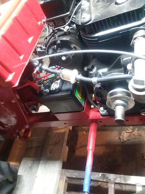

Chrishar 560 #86 Posted August 2, 2023 (edited) Did a little on the old 753 put the cables on Edited August 2, 2023 by Chrishar 6 2 Share this post Link to post Share on other sites

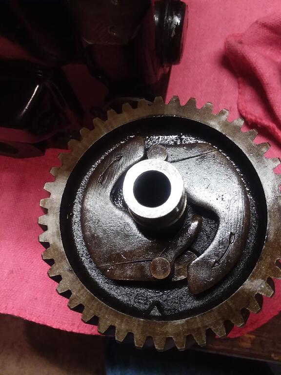

Chrishar 560 #93 Posted August 7, 2023 (edited) I will probably taking the motor back off again I think the two piece cam is out of time I think it's 180 out so its firing at the wrong time that's what I read last night yay a lot of fun Edited August 7, 2023 by Chrishar 1 1 Share this post Link to post Share on other sites
WHX?? 50,585 #94 Posted August 7, 2023 Guessing you played with the points gap? Sounds like it's trying to fire too soon. 1 Share this post Link to post Share on other sites
Chrishar 560 #95 Posted August 8, 2023 Yes the firing is 180 out got the motor back off again yay tomorrow night I'll take the motor apart 2 Share this post Link to post Share on other sites
Chrishar 560 #96 Posted August 9, 2023 So it was 180 out this is what it look like 1 Share this post Link to post Share on other sites

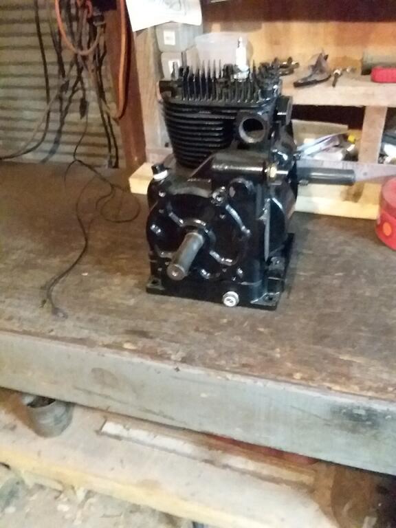

Chrishar 560 #98 Posted August 10, 2023 Got the motor back on the old 753 again and started putting pices back on the motor 2 Share this post Link to post Share on other sites
Chrishar 560 #99 Posted August 11, 2023 Got the motor almost all together tonight still have to put the carburetor and coil on tomorrow then see if the old 753 comes back to life with no more problems 2 Share this post Link to post Share on other sites
