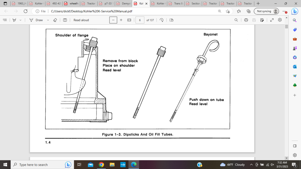

Do I thread dipstick in to check level or no?  Thanks for any advice.1964 1054.

The engine oil dipstick should be removed, wiped clean and the inserted in the threaded hole but not threaded in. Remove the dipstick and read the oil level.
Edited by 953 nut
add drawing

Well well!! they say you cant teach an old dog new tricks ............. but this old dog never knew that about threaded dips not being threaded in for a reading!! :handgestures-thumbupright:
