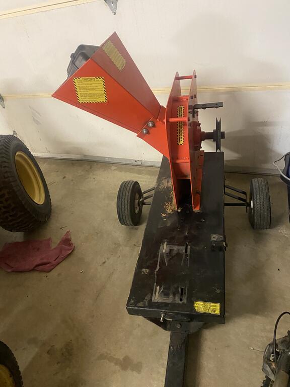

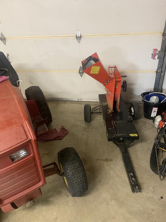

Keithwidney 48 #1 Posted March 31, 2023 I bought a small trailered DR power wood chipper that had a Briggs and Stratton 8hp. WhenI bought it I knew it wasn’t running, motor rolled over fine and didn’t pay to much attention to it. I figured I have fixed lots of small engines , shouldn’t be a problem. Got it home and realized it rolled over a little too easy . It has a Grenaded piston rod . I can possibly rebuild it but was thinking I can make an adapter plate to mount to the front of my tractor and run it off the pto . What are your opinions? 4 Share this post Link to post Share on other sites

953 nut 68,548 #3 Posted March 31, 2023 Some pictures would be helpful in figuring out the best approach but there should be no problem driving a chipper with a Wheel Horse. 2 Share this post Link to post Share on other sites

Handy Don 17,319 #6 Posted March 31, 2023 18 minutes ago, Keithwidney said: As long as you get the direction and speed of the rotation correct, it should be straightforward to power that off a WH PTO. You could choose to have it hang on the tractor or else stay on its wheels and lock up against the tractor to keep the belt taut. Chipping can be tough on engines, though, (hence the blown B&S). Using a longish belt with a spring tensioner that can slip before stalling it out helps protect the engine. 2 1 Share this post Link to post Share on other sites

Keithwidney 48 #12 Posted March 31, 2023 14 hp kihler on a c-145 1 Share this post Link to post Share on other sites
ebinmaine 80,369 #13 Posted March 31, 2023 2 minutes ago, Keithwidney said: 14 hp kihler on a c-145 Given good connection I think you would be more than happy with that. I don't run my 16 at full RPM so it would be pretty comparable to your 14 if you ran yours at 3600 RPM. Be a great idea for you to check rated horsepower of your chipper. Even if the 14 yes a little on the high side, I still do it. Be more adamant about building in belt slippage or a clutch situation. Share this post Link to post Share on other sites

gwest_ca-(File Mod) 12,461 #18 Posted May 14, 2023 That chipper looks to be the same as a Mighty-mac without a shredder. Do you know the DR model number? 3 screws holding the knife on? 1 Share this post Link to post Share on other sites
