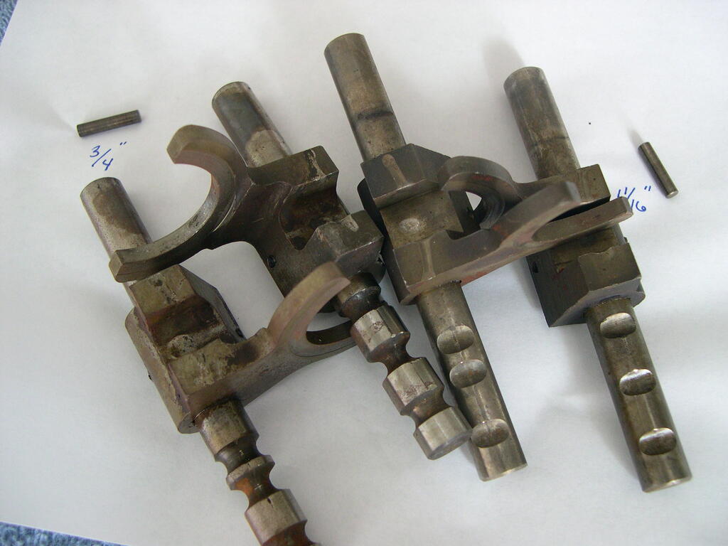

Racinbob 12,422 #13 Posted March 31, 2023 17 minutes ago, Pullstart said: Good point John. Uncle Jim, with the help from your lead mechanic in Red Granite, you might as well tear the trans down and grind the flat in your shift rails so you don’t have the same issue with hydro lock. If you're gonna go that far you'd be best just to find a couple of updated shift rails with the deeper neutral detent and the 3/4" stop pin. 3 1 1 Share this post Link to post Share on other sites

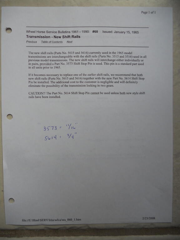

Racinbob 12,422 #21 Posted March 31, 2023 6 minutes ago, Pullstart said: Will that prevent the hydro lock ability, with the smooth (round) shift rails? Especially when shifting fast? There are a few ways to help the hydro lock issue including a service bulletin from the early 60's stating that switching to 40w lube will minimize it. It likely did but the flats solved that issue. As far as locking in two gears they finally came up with a solution addressed in service bulletin #60 in 1965. Note the interchangeable newer shift rails on the left compared to the older style on the right. The longer stop pin was key to this working. The first 'newer' style rails just had a deeper neutral detent. I'm guessing a change in the manufacturing process was the reason they started milling the entire circumference. It doesn't matter because the rails only slide side to side and not around. I wish I had a newer set of rails to send you but all I have left are the older style. 3 2 Share this post Link to post Share on other sites
