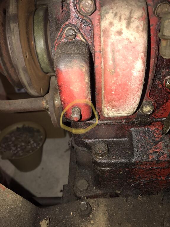

Joe Shmo 158 #1 Posted March 28, 2023 (edited) Would someone tell me what this does? It is on the front of engine Edited March 28, 2023 by Joe Shmo Share this post Link to post Share on other sites
c-series don 9,453 #2 Posted March 28, 2023 It’s a kill switch 2 Share this post Link to post Share on other sites
Pullstart 64,600 #3 Posted March 28, 2023 Yup. Some had it, some didn’t. Press on it and it grounds out the points. 3 Share this post Link to post Share on other sites
WHX?? 50,776 #4 Posted March 28, 2023 Some engines have it ... some don't. More common on the small blocks or 90/91s. It grounds out the points like a kill or ignition switch might do. Your slacking Don and Kev has faster fingers... 3 Share this post Link to post Share on other sites
Ed Kennell 40,513 #5 Posted March 28, 2023 6 minutes ago, Joe Shmo said: Would someone tell me what this does? Actually it doesn't do anything. It just sits there waiting for someone to push it and wonder why the engine shut off. 10 Share this post Link to post Share on other sites
Joe Shmo 158 #6 Posted March 29, 2023 Thank you for the information and the laugh. 2 1 Share this post Link to post Share on other sites
ri702bill 8,993 #7 Posted March 29, 2023 Used on Kohler yank-start motors like tillers to kill the spark when done - has a piece of blue spring steel that deflects to ground out the points.... Share this post Link to post Share on other sites
