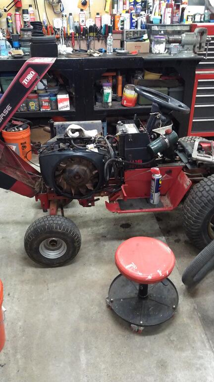

I picked up a low hour, (189.6) abandoned 416h yesterday.  Does anyone know what size the o-ring is that seals the carb to the air cleaner?  Mines cracked and I expected it to break in pieces when I remove it there by making it useless for sizing at the hardware store.  Also, the voltage regulator is missing.  Has anyone tried used a regulator from a Kawasaki as a replacement?  I have a couple here and thought about trying them.  Can anyone tell me if this engine has the governor spacer with the tab?  Thanks.

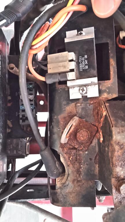

I decided to test this voltage regulator I had from a Kawasaki on the Onan.  So far it's working great.  Put out 14.25 VDC regardless of engine speed. I have to make a better mounting plate to seal off the opening.  I will post pictures when done.KIMG2157.JPG.2d8875012153cefb9a045d350569d106.JPG

johnnymag3
Make sure you ground that regulator better.....           :tools-wrench:            With all that rust I would not rely on the 2 screws that hold it in to be a great source under vibration.
Just a suggestion....  :) ....    you know how fussy I am with Grounds and Grease !!!

Bill D
John      :greetings-clappingyellow:
It's not done yet.  I plan to make an adapter plate from stainless steel to mount it on.

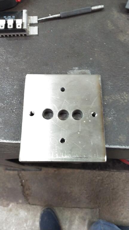

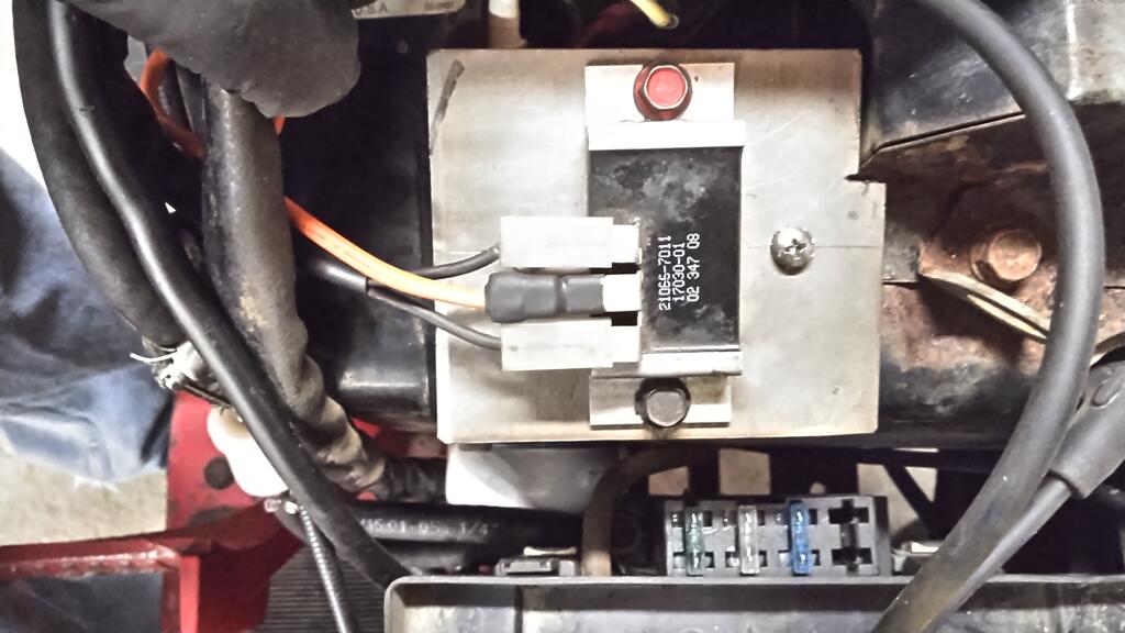

Bill D
Adapter plate for the Kawasaki voltage regulator.  I had the regulator and metal to make the adapter plate.  Seems to be working fine so far.
