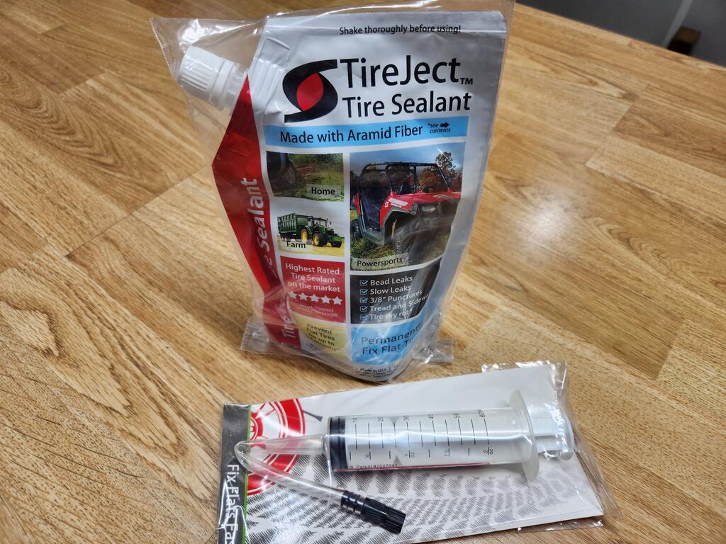

Racinbob 11,726 #27 Posted March 28, 2023 I've likely fought my last tube. For a few years now I've taken the lazy way out and used this stuff. I do know that it works like a charm. It's supposed to be easy to clean off the rim should the need occur but I don't know that first hand. It (and any other sealant) can mess with the valve core so I bought a bunch of cores and replace them a couple days after using this stuff. 1 1 Share this post Link to post Share on other sites
