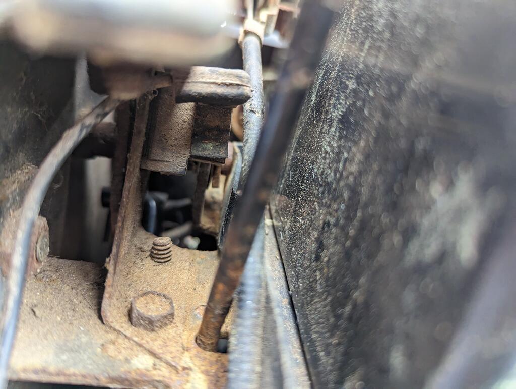

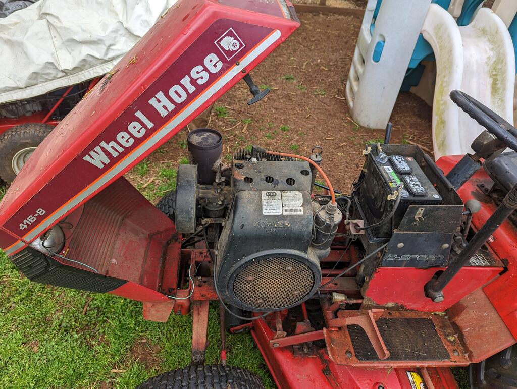

TC10284 113 #1 Posted March 25, 2023 I have an older model 416-8 with k341. I used it yesterday for a few hours to mow. Today it won't start. Got to looking and found one of the pins in the PTO safety switch was loose and corroded in two. I guess me using it yesterday finally broke it. The trouble is, I cannot seem to find a replacement. I can't read the model number on the sticker in front of the seat. What I'm finding on partstree is Toro 110970 for the part but it says unavailable everywhere I look on google. Does anyone know of a replacement? 1 Share this post Link to post Share on other sites
gwest_ca-(File Mod) 11,845 #2 Posted March 25, 2023 This one? This may not work but may have a solution 1 Share this post Link to post Share on other sites
TC10284 113 #3 Posted March 25, 2023 (edited) I will have to look closer but yes, that does seem to be what I need. Thanks! Edited March 25, 2023 by TC10284 1 Share this post Link to post Share on other sites
TC10284 113 #4 Posted March 25, 2023 I guess I will order a Toro 103480 1 Share this post Link to post Share on other sites
TC10284 113 #5 Posted March 25, 2023 Dang, I'm having trouble finding even that one. 1 Share this post Link to post Share on other sites
ineedanother 1,808 #6 Posted March 25, 2023 45 minutes ago, TC10284 said: Dang, I'm having trouble finding even that one. Hey @TC10284, if you can't find one let me know. I'm pretty sure I have one somewhere. Share this post Link to post Share on other sites
ineedanother 1,808 #7 Posted March 25, 2023 Another option, and likely why I probably have some laying around is that the clutch switch should be the same and that's one I don't mind bypassing. Share this post Link to post Share on other sites
TC10284 113 #8 Posted March 25, 2023 Yep, I'm not able to find one. I guess my options are bypass it or see if anyone on here has one. 1 Share this post Link to post Share on other sites
biged77 113 #9 Posted March 27, 2023 A refrigerator fan switch (not a light switch) can be used as a replacement for 103480. I bought one for my 1988 416-8 and it works. https://www.amazon.com/gp/product/B07RZ91GW3/ref=ppx_yo_dt_b_asin_title_o09_s00?ie=UTF8&psc=1 5 Share this post Link to post Share on other sites
TC10284 113 #10 Posted March 27, 2023 8 hours ago, biged77 said: A refrigerator fan switch (not a light switch) can be used as a replacement for 103480. I bought one for my 1988 416-8 and it works. https://www.amazon.com/gp/product/B07RZ91GW3/ref=ppx_yo_dt_b_asin_title_o09_s00?ie=UTF8&psc=1 Funny, because last night my arm hit the light switch on my fridge door when I was grabbing milk and I was thinking " huh, looks pretty similar..." Thanks! 2 Share this post Link to post Share on other sites
