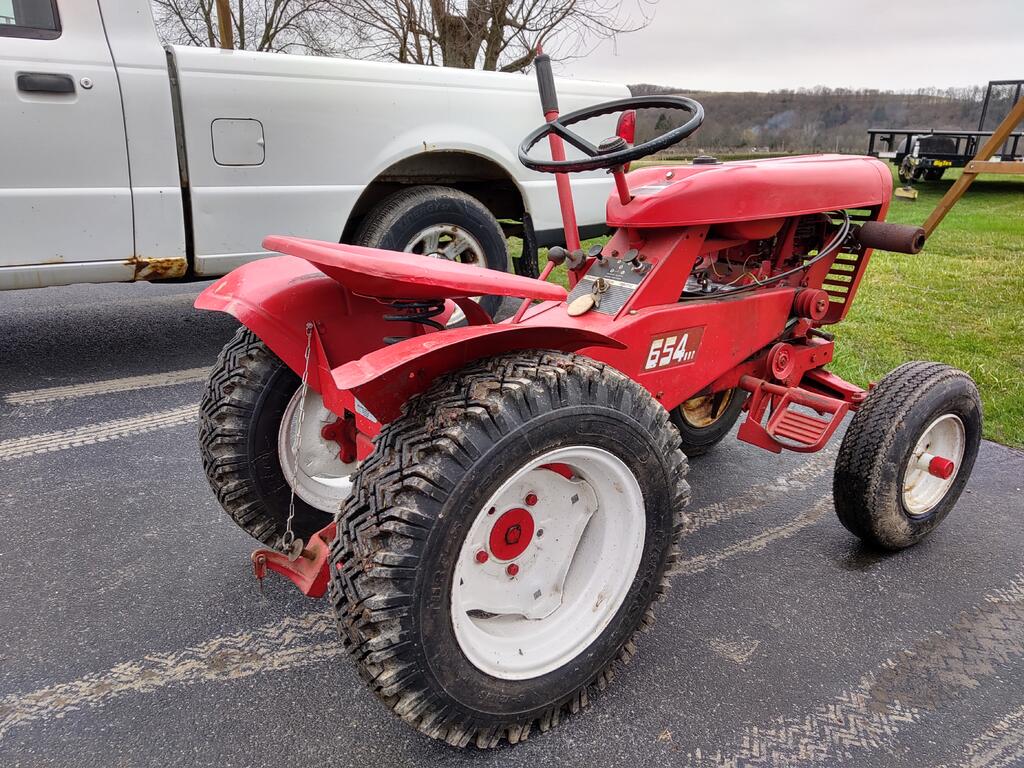

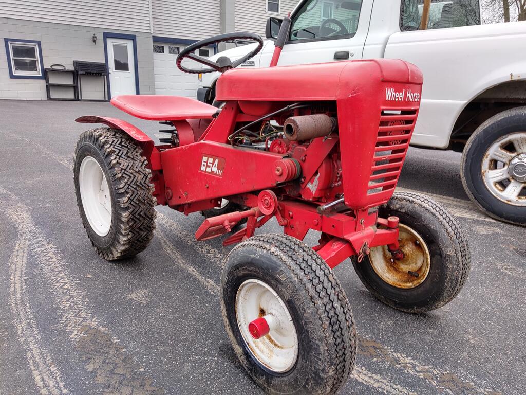

ML3 1,448 #6 Posted March 25, 2023 Thanks everyone for the good information Ended up.going this afternoon to look at the 654. I bought it. Unfortunately I have my trailer tires off & at tire shop getting replaced so I couldn't bring it home. Guy I bought it from offered to deliver it end of next week for $50! Score!!! So for $450 I got a running 654 delivered! It has a Tecumseh engine- probably not original I believe. He is into Cub Cadets & got it on a package deal so he wasn't interested in keeping it. Now I need to find a snow plow because I doubt the plow or snowblower off my 1984 C105 will fit? 5 2 Share this post Link to post Share on other sites

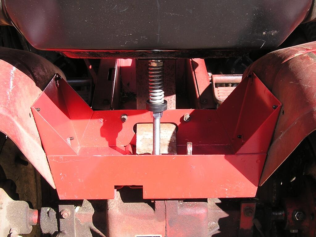

ri702bill 8,990 #7 Posted March 25, 2023 (edited) Good score !! I see someone added a "Big Boy" helper spring under the seat to keep the seat pan off the rear fenders. I did an adjustable one on the 854 8 speed... a bolt-in version that uses existing holes - works well. I also see the PTO lever dangling - the roll pin to stop it needs attention, and the spring... Edited March 25, 2023 by ri702bill 2 Share this post Link to post Share on other sites
ML3 1,448 #8 Posted March 25, 2023 I gotta figure out all that in the back. PTO lever it is?? He has some other parts for that- pin & some other stuff in a box?? gotta figure out a rear hitch for sure & get a blade for front. Also gotta get the park brake to function too. Share this post Link to post Share on other sites
wallfish 17,498 #9 Posted March 25, 2023 44 minutes ago, mjl111070@yahoo.com said: I gotta figure out all that in the back. PTO lever it is?? He has some other parts for that- pin & some other stuff in a box?? gotta figure out a rear hitch for sure & get a blade for front. Also gotta get the park brake to function too. The foot pedal is for a mower deck so that can be removed if your not using a deck The cable for the rear hitch rusted rotted and broke. Find one here https://wheelhorsepartsandmore.com/product-category/cables/ Your blade from the C105 should fit. Move the rear mounting bar on the frame to the front set of holes. They push snow well, 654 is my snow blade tractor Parking brake is a very simple mechanism and you can probably get one from AZ tractors 3 1 Share this post Link to post Share on other sites
ri702bill 8,990 #10 Posted March 25, 2023 (edited) That chain is holding up the slot hitch - I see the broken off end of the cable clevis still attached, The other end goes to the Implement lift lower mechanism. Lowell sells the repro cables. I do not see a rear bracket clamped on the Unidrive - that is the mount for the plow. Plows - ideally, you want a "short frame" plow - the one with the triangular frame. You Can use a later "long frame" style - it may put the angling lever in an odd spot.... Two front plow lift links available - one is a chain - does NOT give the ability to put downward pressure on the plow. The other is a solid bar link - that one does. I use that style. Edited March 25, 2023 by ri702bill Share this post Link to post Share on other sites

ML3 1,448 #12 Posted March 25, 2023 I have a plow on my 1984 C105. Will the rear axle bracket off the C105 fit the 654? I can see what you mean about a "short frame" plow. Probably put my snowblower on C105 & get a plow for 654. I'll have to figure out the slot hitch as I'll need it as well as need a regular 2" ball hitch for moving my trailers around. I'm thrilled with the purchase. I'll check the engine s/n to verify. It doesn't look like a possible replacement??? 1 Share this post Link to post Share on other sites
wallfish 17,498 #13 Posted March 25, 2023 (edited) Original 654 engines did not have a recoil starter on them but had a larger "bubble type" debris cover over a rope start cup. Back up for the electric start The plow bracket should fit Edited March 25, 2023 by wallfish Share this post Link to post Share on other sites
ML3 1,448 #14 Posted March 25, 2023 Thanks again everyone for the information. When he brings tractor next weekend & I get both them beside each other I'll figure out the snow blade. Probably just put the blower on the C105 at that time since it doesn't require the rear axle bracket. I'll use it if it fits the 654. Definitely wanna fix slot hitch so I can pull garden cart & also get a regular ball hitch that's high enough fory trailers Share this post Link to post Share on other sites
wallfish 17,498 #15 Posted March 25, 2023 You can lock the slot hitch up to a fixed position with a piece of steel or chain without using a new cable if you don't need it to raise and lower. You will need a piece of flat stock steel with holes to insert into that slot hitch so you can connect a garden cart to it. Blower wouldn't perform very well on a 654 with a small engine like that anyway. Better to go with the C for the blower The bigger C would also be a lot better for the ball hitch for pulling bigger trailers. The heavier engine will counter balance the weight better. Make sure the brake works well too so you can stop. If the band has any oil in it you can soak it in gasoline overnight. Even better is the rubber type band lining material rmaynard sells as it grips much better than the old stuff does. 2 Share this post Link to post Share on other sites
ri702bill 8,990 #16 Posted March 25, 2023 1 hour ago, mjl111070@yahoo.com said: Definitely wanna fix slot hitch so I can pull garden cart & also get a regular ball hitch that's high enough fory trailers Or - take the slot hitch off and use the C series welded drawbar type... IF you can get the hitch pin out.... Share this post Link to post Share on other sites

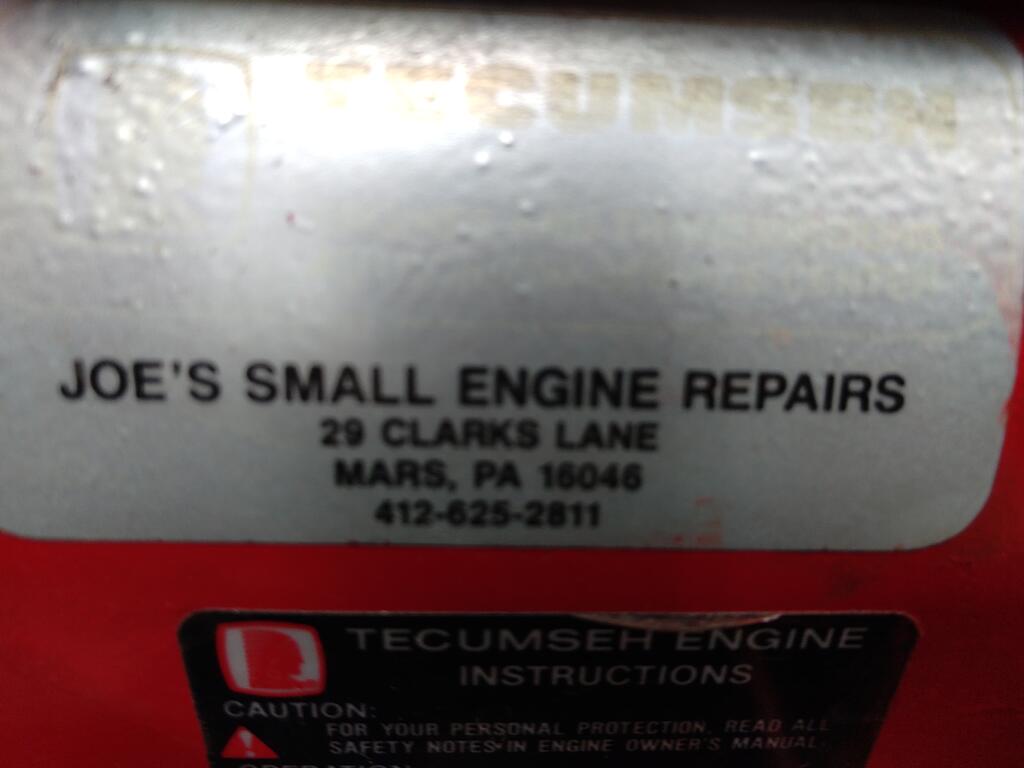

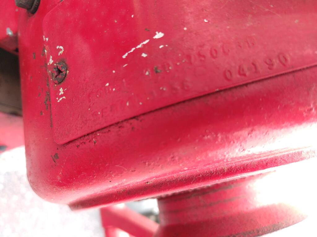

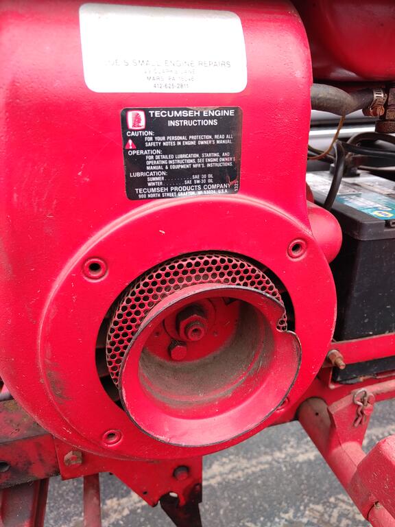

ML3 1,448 #17 Posted March 25, 2023 2 hours ago, 953 nut said: I think you got a great deal. It could be the original engine, they came with a Tecumseh 75063B electric start engine. Here's a pic of engine & I tried to get a good pic of engine id plate. I noticed it has provision for a rope back up pull start Share this post Link to post Share on other sites
wallfish 17,498 #18 Posted March 25, 2023 This is what the factory debris screen looks like.( Pic from the net.) Very difficult to find them but certainly not impossible. Not a big deal unless you are going for factory correct. Those original engines are pretty rare because they krap the bed so most are gone to the scrap yards. You might want to consider a repower with a different engine if you're not going for a factory correct tractor. The original engine can add quite a bit of value to the collector that restores to factory correct. They're a real PITA to rebuild Share this post Link to post Share on other sites

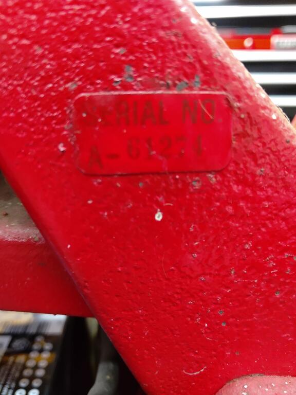

ML3 1,448 #19 Posted March 31, 2023 Got tractor today. Overall it seems to be in decent shape. Needs a few small things. Misc electrical connections need fixed, fuel shutoff/petcock has a very slight leak, choke cable stiff, hitch cable replacement. I'll change spark plug, air filter, oil, & trans fluid. Got the s/n for tractor. Ant way to determine when it was actually manufactured? Also the original selling dealer stickers are still present. One on engine & another on rear pan below seat 2 Share this post Link to post Share on other sites
