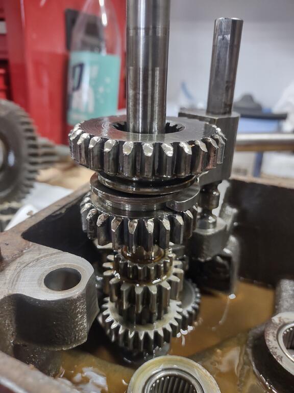

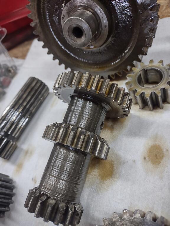

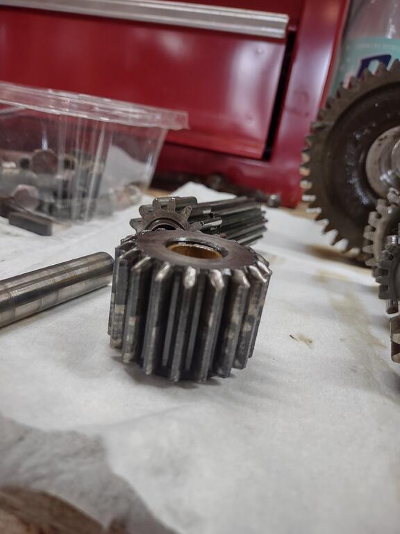

ebinmaine 69,583 #8 Posted March 20, 2023 All you guys are awesome. The pictures below show the gears that are worn. If this was a show cruiser I wouldn't hesitate half a heartbeat to put them all back in but this will be a PRIMARY worker for Trina. 2 Share this post Link to post Share on other sites
Lane Ranger 11,062 #9 Posted March 20, 2023 (edited) The cluster gear is available on any Wheel Horse gear driven transmission. They are all the same from three piece RJ’s thru last one built in 2007! Edited March 20, 2023 by Lane Ranger 2 2 Share this post Link to post Share on other sites

WHX?? 49,792 #13 Posted March 20, 2023 Cluster gear is the same & looks like the others are too. I would run the reverse gear they all look like that. Fer sure a new third gear from Lowell and he may have the others as well. Don't scrap the old ones I know a guy who repurposes them.... 1 4 Share this post Link to post Share on other sites
