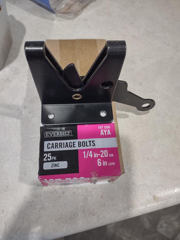

ebinmaine 75,688 #1 Posted March 18, 2023 I need to make 16, ¼" round holes to squares so I can use carriage bolts. How? Share this post Link to post Share on other sites

ebinmaine 75,688 #14 Posted March 19, 2023 8 hours ago, David Blanchard said: If it light stock you are going thru can you just drill for 11/32 and suck the bolt thru with a flat washer nut & some lube? r If it was sheet metal I could certainly do that. Not sure in the metal thickness I'm working with. Likely about .100 and a softer steel. A bit too much to draw the bolt through. Share this post Link to post Share on other sites
