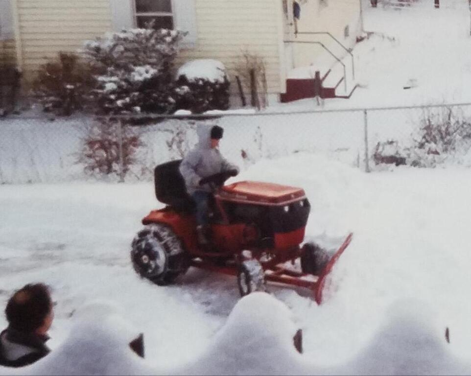

Brockport Bill 1,778 #11 Posted March 16, 2023 i have had that 312-8 tractor model bought new since 1989 --- over 2,000 hours -- awesome machine - here's photo of my then 8 yr old son plowing with it first winter in 1989, plow photo of recently reconditioned plow blade, and recent photo 33 years later of tractor and plow, and our 37 inch side discharge mower we restored after 3 decades of use. I have also used with our tiller for garden and lawn plus pulled a roller to install our lawn -- machine does everything you will ask! 1 4 Share this post Link to post Share on other sites
