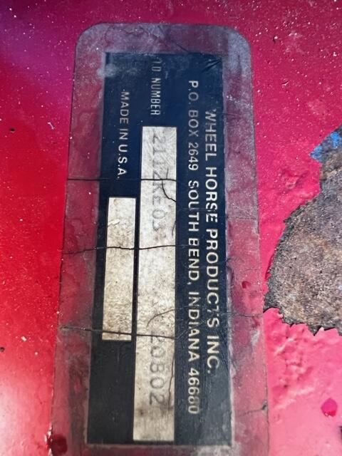

wildbill69 7 #10 Posted March 16, 2023 here is the tag and now it will bot even turn over with the key switch, but I can jump the solenoid and it will turn over just fine. Before this it was running like a top. 2 Share this post Link to post Share on other sites
gwest_ca-(File Mod) 11,249 #11 Posted March 16, 2023 Download this file. Each circuit has it's own diagram so easy to follow This link will take you to 2 pages of files we have on this model https://www.wheelhorseforum.com/search/?&q=21-12ke03&type=downloads_file&page=1&search_and_or=or&sortby=relevancy 4 Share this post Link to post Share on other sites

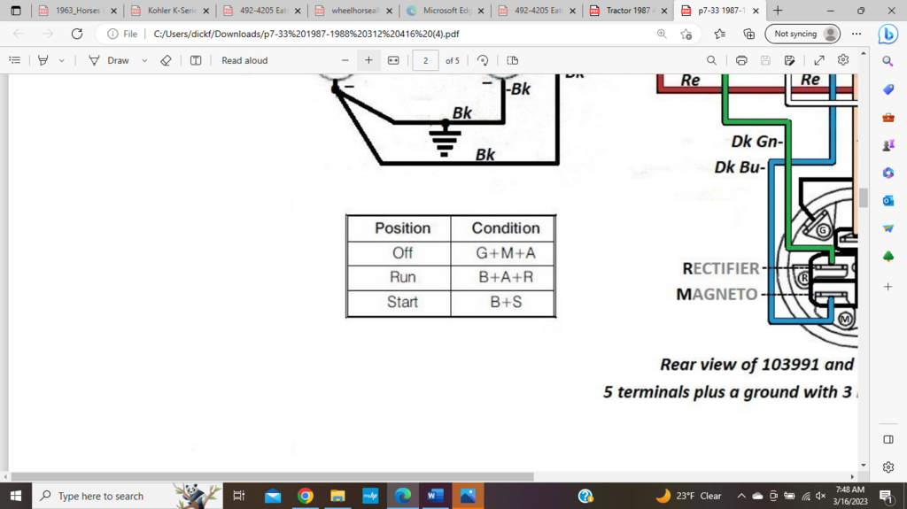

953 nut 57,980 #18 Posted March 16, 2023 14 hours ago, wildbill69 said: I took the ignition switch out and ohmed it 1 of the circuits got a reading, so I ordered a new switch. What ignition switch number did you order? Here is some information on your switch and what terminals should make contact in various positions. If you have the correct switch all is good, If the switch you have on order is anything but the correct 103991 or 111215 do not use it. 6 minutes ago, Blasterdad said: @Pullstart I was going by what he said earlier, I should have been more specific, as long as the key is in the run position & check that there's power to the coil. This is a magneto ignition, if you put power to the coil of the magneto you will fry it. Share this post Link to post Share on other sites
