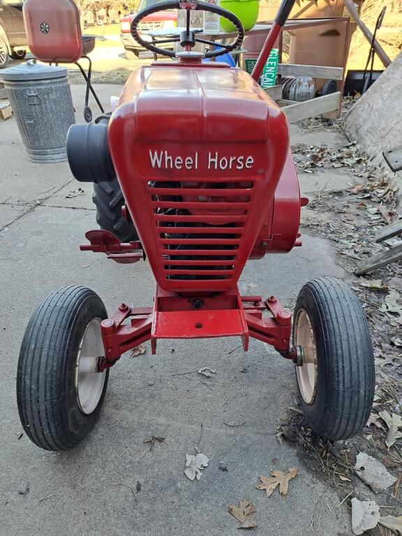

Keith Plett 25 #1 Posted March 14, 2023 I have a 1961 Wheel Horse 701 that has previously been restored very nicely. I purchased it last Fall and it being the very first Wheel Horse model I have ever owned I am substantially at a loss of knowledge concerning it. I have been told by numerous people that the 701 model only had the flat solid grill, but I have seen many examples including mine that has the slotted grill. Did they use both at one point or another? Just curious which if not both are correct. I am not even considering switching mine out for a solid flat grill. I prefer the slotted grill look over the solid flat version and I feel the slotted grill would be better to help with cooling anyhow. I just have an over-active curiosity about it. Thank you for any information anyone can afford me. 1 Share this post Link to post Share on other sites

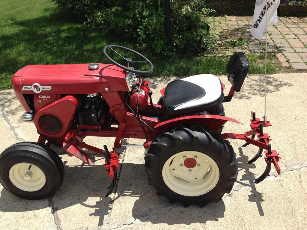

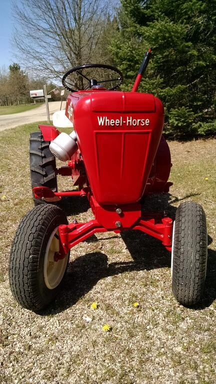

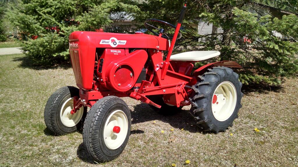

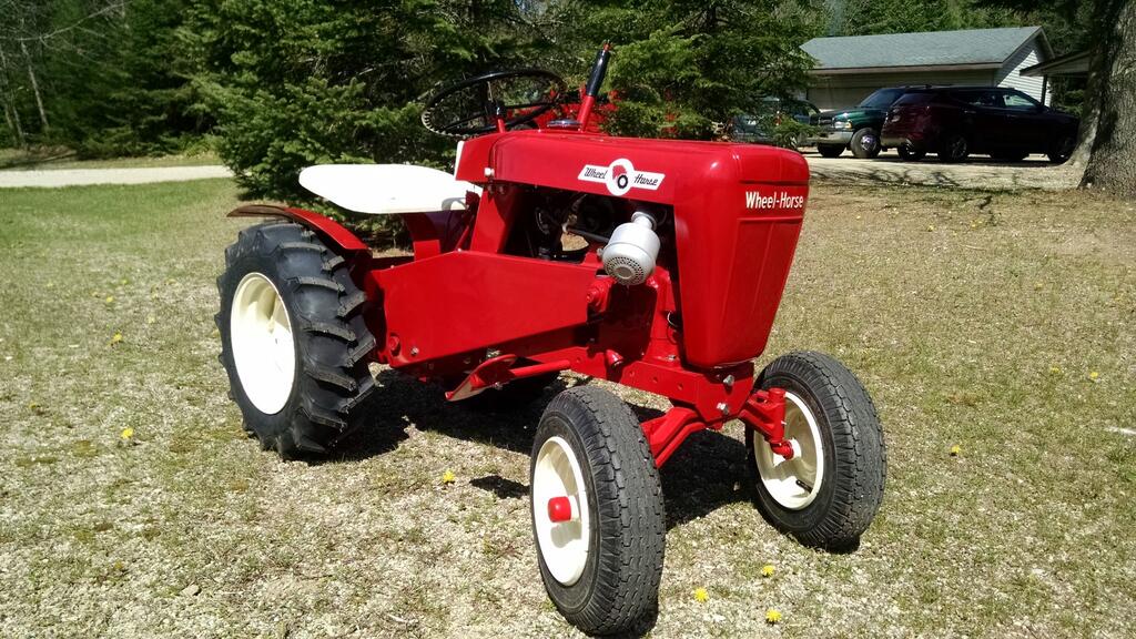

kpinnc 13,424 #3 Posted March 14, 2023 (edited) The 701 came from the assembly line with the solid faced hood. The one in the picture isn't mine, but it is the correct hood. In 1962, the hoods came with the slots from there through 1964. In the case of the Lawn Rangers, through 1968. If yours has a slotted grill, it was likely replaced at some point. A pure guess would be that at some point, the solid face 1961 hood spares ran out. Since the 1962 versions were a bolt-on swap, they naturally became the only replacement available at the time. Edited March 14, 2023 by kpinnc 5 2 Share this post Link to post Share on other sites
Achto 28,534 #4 Posted March 14, 2023 1 hour ago, kpinnc said: I recognize that tractor!! My first resto on a round hood. 7 2 Share this post Link to post Share on other sites

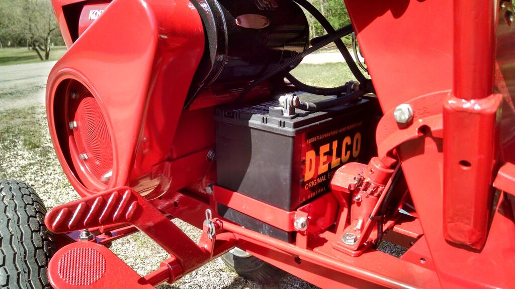

Achto 28,534 #6 Posted March 14, 2023 (edited) 8 hours ago, Keith Plett said: Thank you for any information anyone can afford me. Other than the Ride Away Senior the 701 was the first year that put the engine in the front. Being the first it had a few unique items that were not found on the '62 models. Solid grill in the hood. A thicker fan gear for the steering. A double belt on the starter/gen & a wider guard to accommodate this. The long foot rests Fender brace inside the tool box. White plastic dash. Starter button linked to a starter relay. No recessed area on the drive belt guard for the model decal. No model decal. Sharper points on the rear fenders. No cover over the brake linkage. I'm might have missed some things yet, but the above features were only on the 701 model. It would be my guess that your hood was changed at some point. A couple of pics of my 701 for reference. Edited March 14, 2023 by Achto 1 10 Share this post Link to post Share on other sites

kpinnc 13,424 #8 Posted March 14, 2023 @Achto I've had your 701's pics stored for a while now. One day I hope to restore my 701, and yours is an excellent example! Keith, welcome to the addiction! You have a great machine to start with, and lots of folks here to assist you when needed! 1 1 1 Share this post Link to post Share on other sites
ri702bill 8,894 #9 Posted March 14, 2023 41 minutes ago, Achto said: I'm might have missed some things yet, but the above features were only on the 701 model. The 701 did not have a parking brake either...The double belt setup was 701 only for the starter / generator. That engine did NOT come with ACR (Automatic Compression Release). 2 1 Share this post Link to post Share on other sites
rmaynard 15,886 #10 Posted March 14, 2023 (edited) Everything that was said above about the 701 is true. The 701 was quite unique because it was a prototype. Many of the features were never duplicated in subsequent models. Probably the most common reason for the hood replacement was the bottom mounting point rusted out easily. Only replacement was the newer 702 style. Edited March 14, 2023 by rmaynard 5 1 Share this post Link to post Share on other sites
953 nut 57,403 #11 Posted March 14, 2023 9 hours ago, Keith Plett said: I have been told by numerous people that the 701 model only had the flat solid grill, but I have seen many examples including mine that has the slotted grill. Did they use both at one point or another? Just curious which if not both are correct. I am not even considering switching mine out for a solid flat grill. Great question. We have discovered that every ironclad rule about Wheel Horses seems to have an exception or two. The Pond's were rather thrifty and with parts being so interchangeable it could be the supply of solid grills was exhausted before the end of the 701 run and the NEW slotted hood was used or it could be that a previous owner at some point in the past six decades replaced it with a slotted grill. Who knows for sure? None of us were at the Wheel Horse factory in 1961 supervising the grill installation. The only ironclad rule that we can all agree on is it is your tractor and yours to enjoy! 5 3 Share this post Link to post Share on other sites

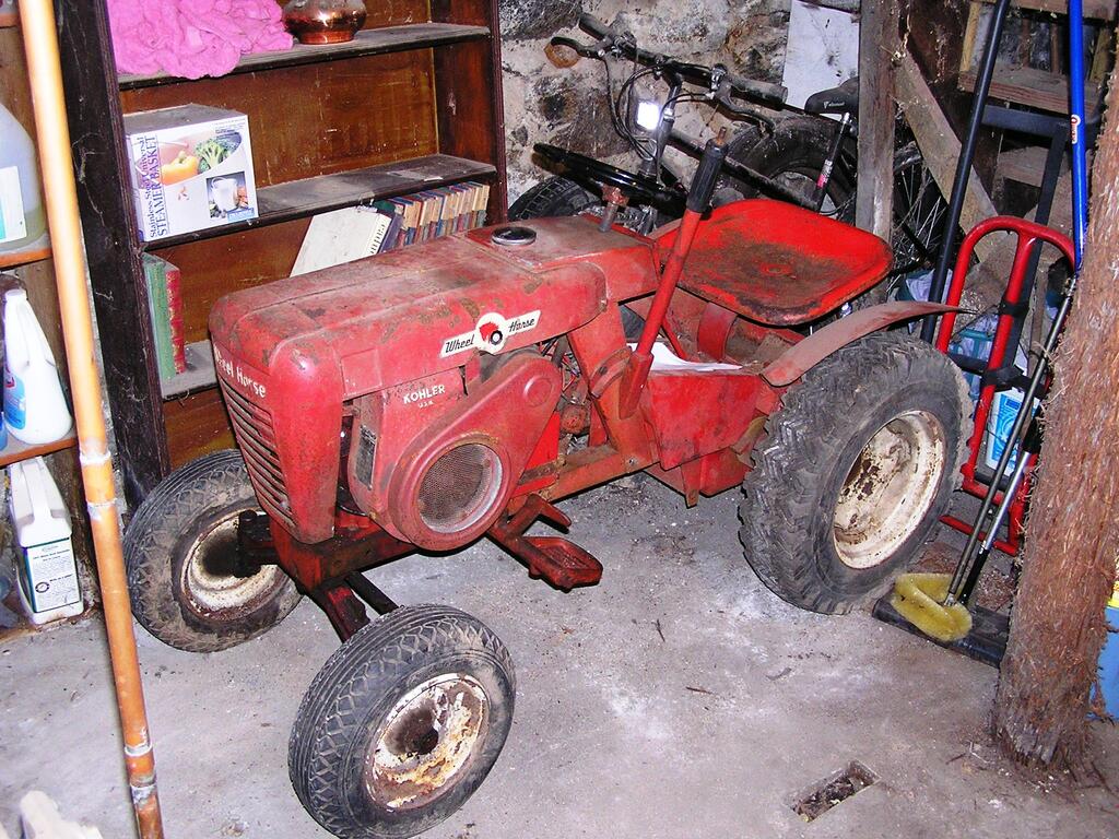

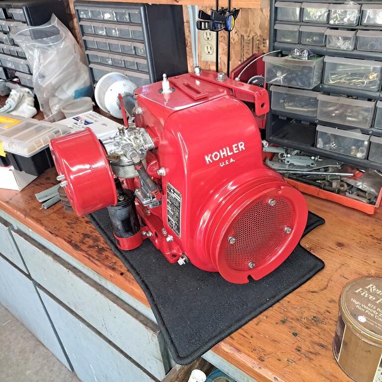

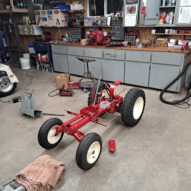

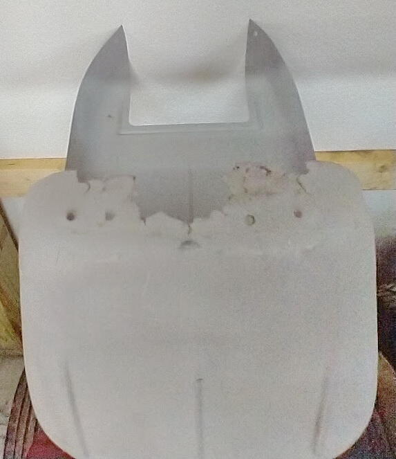

WHX?? 50,417 #12 Posted March 14, 2023 Given 701 solid front hoods are hen's teeth anybody faults you for liking the slotted is going to have to answer to us. 10 hours ago, Keith Plett said: am substantially at a loss of knowledge concerning it. I Anything you ever need to know about it is right here. BTW you might already know we like Keith Some pics of my 701 in resto. @squonk you need to lite a 🔥 under Dan I need to gitterdone! 2 5 4 Share this post Link to post Share on other sites
Lee1977 6,989 #13 Posted March 14, 2023 (edited) Wheel Horse never let the shortage of parts stop them from production of tractors. They usualy used the parts they had on hand or could get like engines. Most times it was a special model . There is no way to tell that the slotted hood didn't come stright off the line. Edited March 15, 2023 by Lee1977 2 1 Share this post Link to post Share on other sites

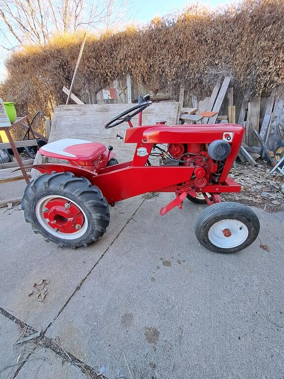

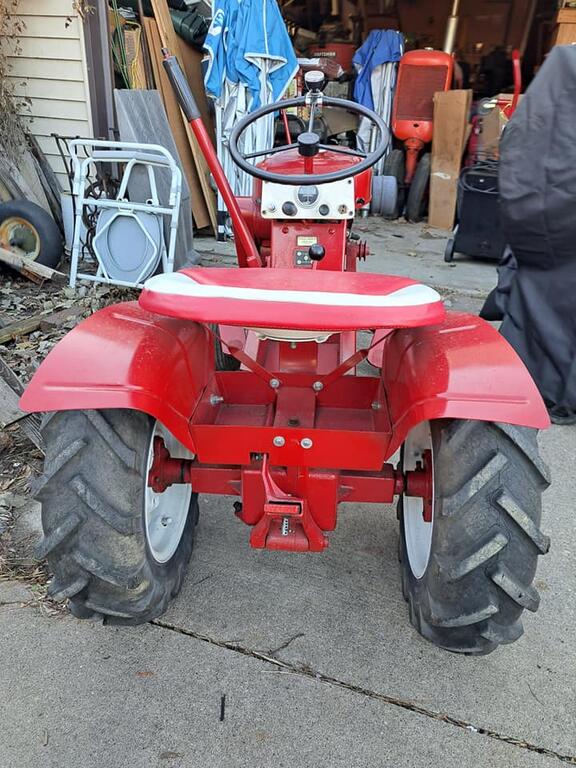

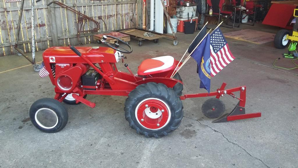

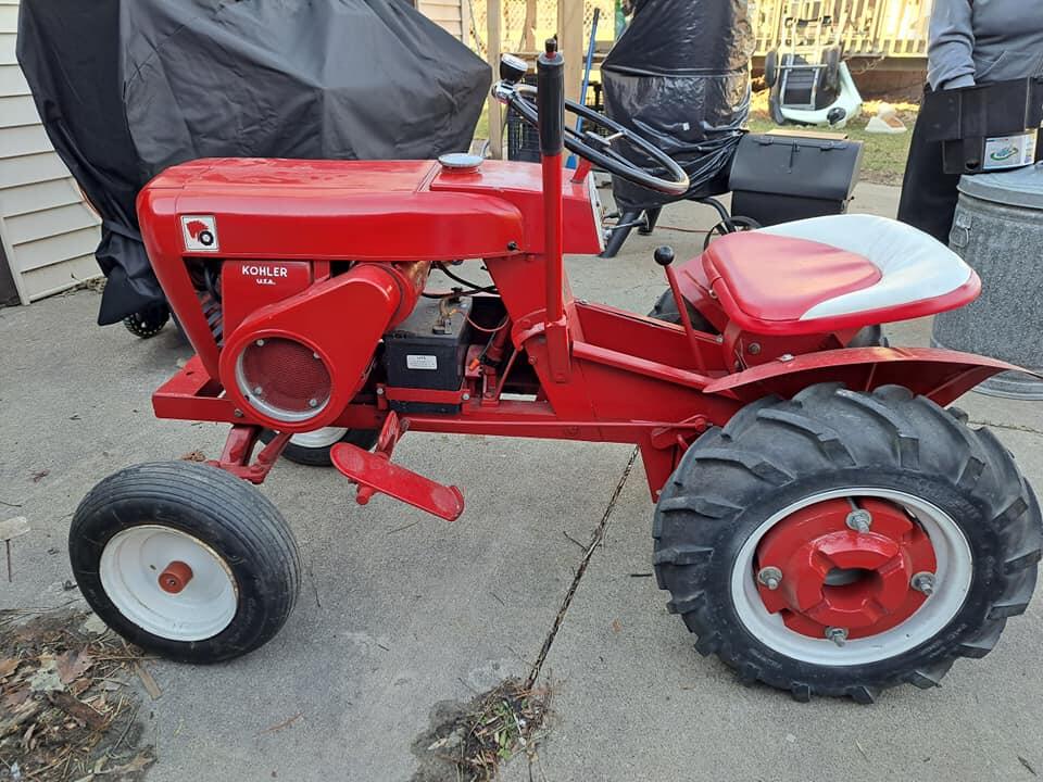

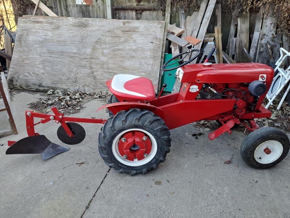

Keith Plett 25 #14 Posted March 14, 2023 Thanks for all of the info everyone! I greatly appreciate it! I absolutely love this little tractor! I've bee a Cub Cadet guy my entire life, but when I saw this come up for sale not far from me I knew I had to have it. Y'all may have already seen it as pics of it have been posted on here before by the previous owner, Jim Demery of Bushnell, Illinois. Hell of a nice guy and very talented in my opinion. 8 Share this post Link to post Share on other sites
WHX?? 50,417 #15 Posted March 14, 2023 (edited) Saaawweeettt Keith... I don't think I've ever seen it and not familiar with Jim Demery... that I remember anyway. I really like them wheel weights. One thing I don't like so a little constructive criticism here guy is the front wheel barrow style tires just don't cut it for me. The rears are boss tho & that plow is to die for... Question fellas I see he has the same two holes on the passenger side of the gas tank. Mine had them too but I fingered they were for a PO throttle so i filled them in. Was I right or wrong? Nothin wrong with bein a Cub guy dude... I can think of worse brands. A few Cub guys here too and ther is a section of other brands here ... we would love to see some pics of them. Edited March 14, 2023 by WHX?? 2 1 Share this post Link to post Share on other sites
rmaynard 15,886 #16 Posted March 14, 2023 Something different about the rear fender supports. 2 Share this post Link to post Share on other sites

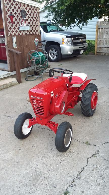

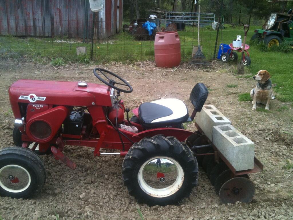

Keith Plett 25 #17 Posted March 14, 2023 Here are a couple of pics the former owner Jim Demery posted on this forum back in 2017: 2 Share this post Link to post Share on other sites

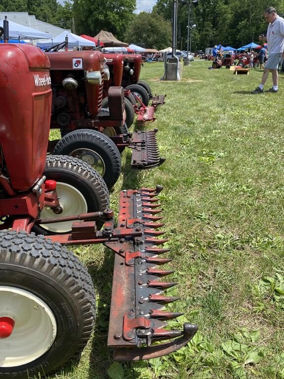

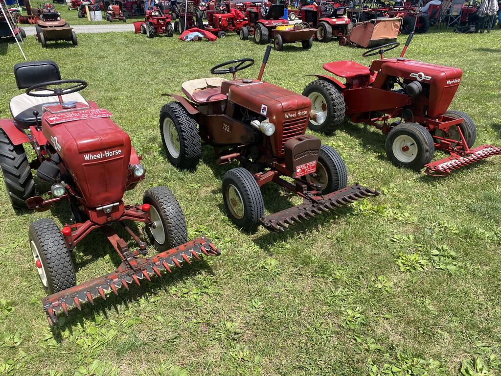

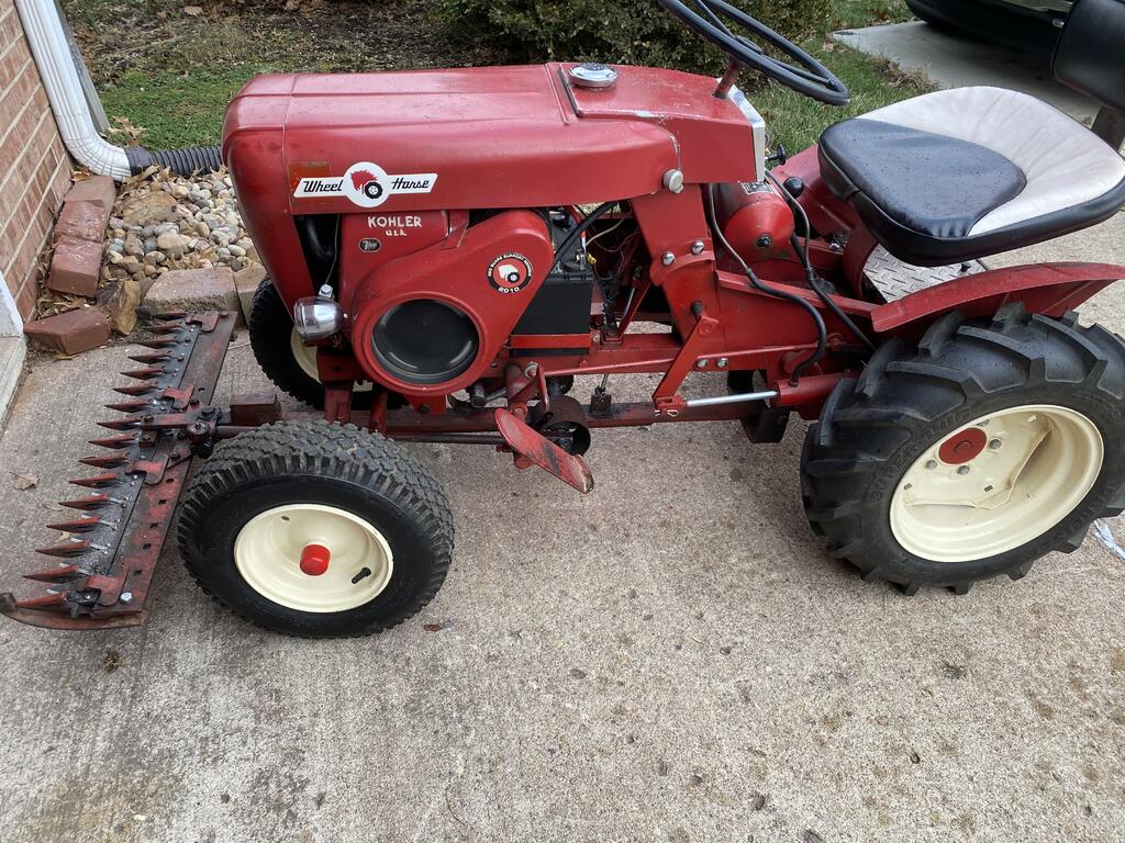

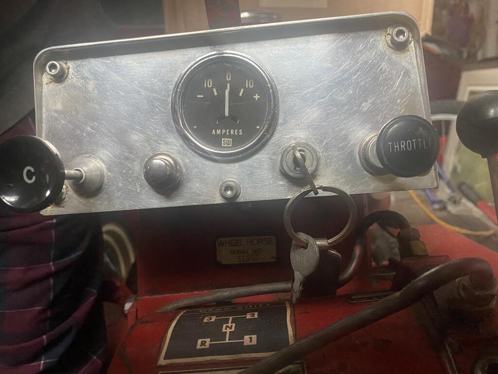

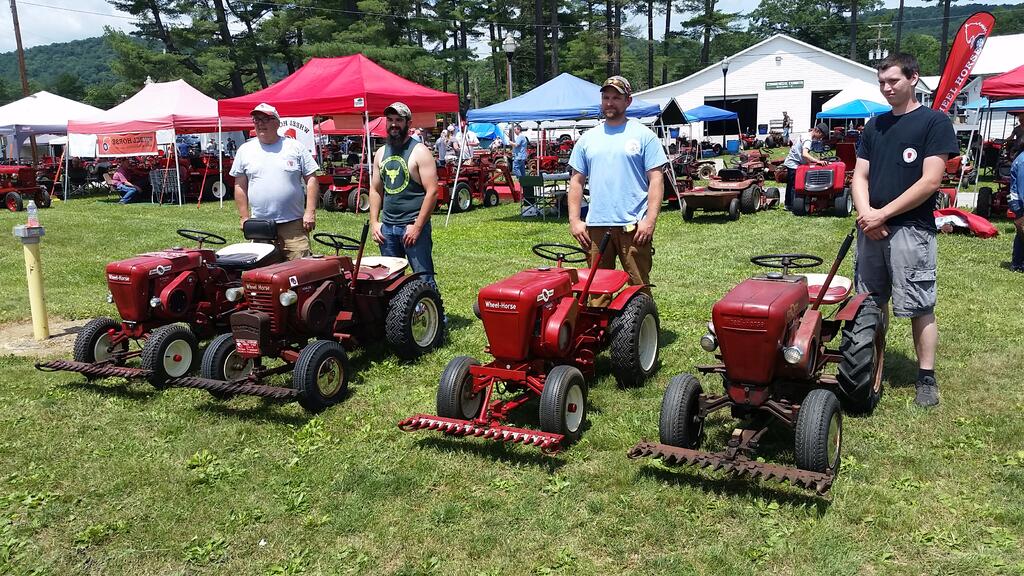

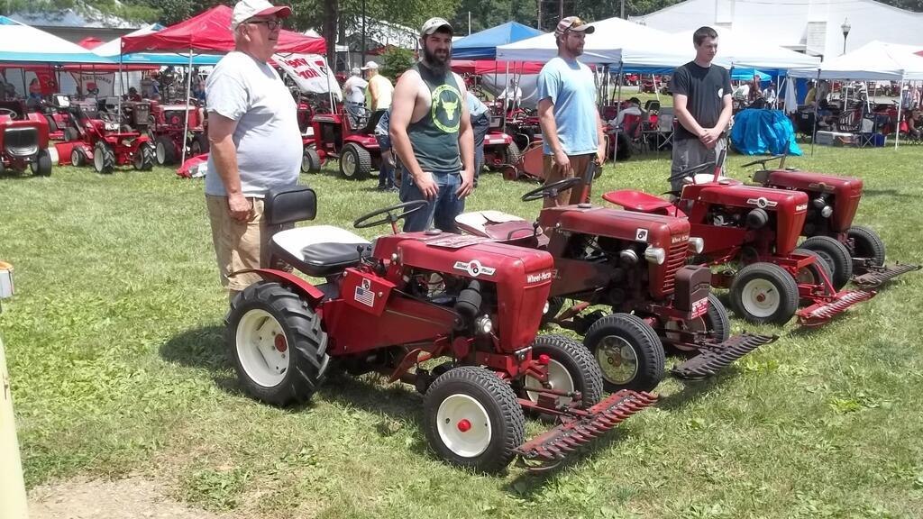

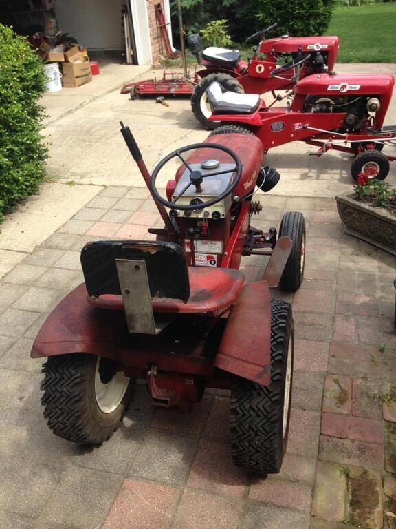

Lane Ranger 11,096 #18 Posted March 14, 2023 (edited) 701 is one of my favorites! Mine is unrestored but still greatly loved! Not only by me but two previous owners -Devin Stutler snd Jon Bell of Indians who traded this tractor back and forth with each other several times. All 701’s are special but I like that mine has a Hein-Werner hydro pump for lifting implements, a chromed dash (originally from a 702 that had additional holes drilled), and the CBR- 327 front , chain drive cutter bar. My hood even has a stainless door hinge on the bottom of the hood that allows for easy access and strengthen the original hood bottom to the front of the 701 frame. If you look close you can see it. We were fortunate a couple years ago do to efforts by Ryan Transue to get four 701’s with CBR-327 front cutter bars at the Wheel Horse Collectors Club Show. Edited March 14, 2023 by Lane Ranger 6 Share this post Link to post Share on other sites
WHX?? 50,417 #19 Posted March 15, 2023 OK Lane now yer starting to tick me off...rain on my parade Just a priceless pic of four guys with some cherry orginal 701s You can see now how a 701 is a bucket lister for many of us. 1 3 Share this post Link to post Share on other sites
