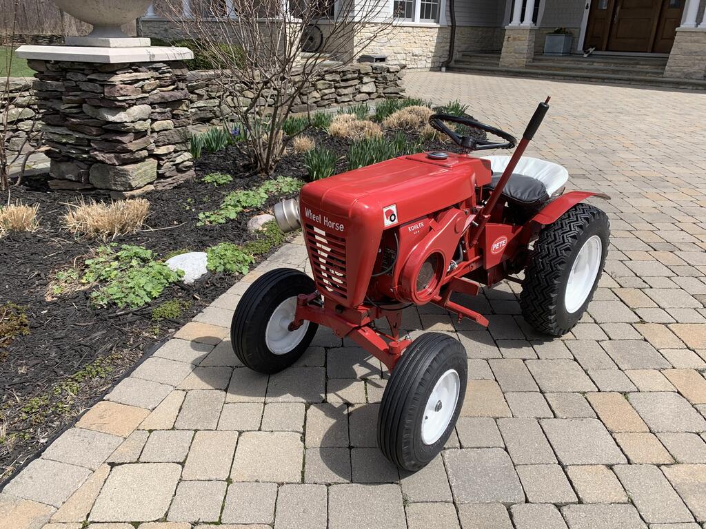

Dr.D 9 #1 Posted March 13, 2023 A few winters back I restored-rebuilt a WH854 to new (including rebuilding the original starter generator, trans and replaced the engine with still in the box replacement K181). I had to devolve the 1981 replacement engine to 1964 standard but all parts bolted up without issue. Everything on the 854 presently as factory intended it to be in 1964. Theory of stock sounds good but one design bug… well… bugs me. No matter what I do… the starter generator does such a poor job of charging the battery. That bugs me. I don’t care if the 854 is a 1964. I should not have to hook up the battery charger as often as I do and I should be able to run lights without issue. Evidently Kohler agreed and solved the problem a few years later with an alternator stator. The replacement NOS K181 is-was a 1981 vintage and came in the box with an alternator stator that I ditched for the original 1964 design starter generator. I still have the 1981 parts (flywheel, alternator stator and starter) that I could switch back to how it can in the box but I like the old 1964 starter generator shroud look even if I don’t like living with the older electrical system. Here is the design proposal question: I have the parts for both… what if Frankenstein both? The 1964 shroud will not fit over the 1981 flywheel but I should be able to bolt the 1981 stator onto the 1964 flywheel, reconnect the block leads and run both (1964 starter generator and 1981 alternator stator). The gain of doing the above would be generating current from both the generator and alternator. Theoretically charging battery faster, and powering any lights I want. Helpful given one of my 854’s new cherished family duties is pulling a cart of children around on Halloween night. That is where I am left scratching my head. Too much current? Thoughts? 5 Share this post Link to post Share on other sites

Handy Don 13,340 #11 Posted March 13, 2023 I’d strongly suggest that in doing such a terrific job of restoring that beauty, you may have neglected to assure that the S/G (and voltage regulator) have a solid ground through the S/G housing and mount to the engine block. When I did my 854, including replacing some wiring, I was very careful to make sure that all the obvious electrical connections were clean and solid. I was, however, so thorough with the painting of the individual engine and S/G parts that I effectively insulated the S/G from the electrical ground that it needs. Didn’t get as far as having charging failure, it was the pathetic anemic cranking with a new battery that caused me to slap my forehead with a “DUH!". I had to take apart the entire S/G support assembly mount, scrape off the paint between the components, dab with dielectric grease (to inhibit rust/corrosion), and reassemble. Now, like the other posters above, it is problem free for cranking and charging. A less likely possible issue is if the voltage regulator has failed. Let us know if you need a hand to diagnose that. 4 Share this post Link to post Share on other sites
squonk 42,534 #12 Posted March 13, 2023 I built an engine run stand and in the process I decided to do a little investigating with dirty/poor connections. For instance painting the block where the genny mount bolts on and painting the mount itself dropped 3.2 volts as opposed to all the mounting points all clean and shiny. 5 Share this post Link to post Share on other sites

953 nut 57,904 #23 Posted March 13, 2023 8 hours ago, Dr.D said: what if Frankenstein both? The 1964 shroud will not fit over the 1981 flywheel but I should be able to bolt the 1981 stator onto the 1964 flywheel, reconnect the block leads and run both (1964 starter generator and 1981 alternator stator) That is one great looking 854. Like others I have S/G Wheel Horses that have never been a problem. I connect the battery ground wire directly to the S/G mounting bolt to ensure a good ground. Have you had the battery load tested? Chances are the 1964 flywheel has no magnets inside it to make the stator produce electricity so I'm not too sure your will workout. 1 Share this post Link to post Share on other sites
