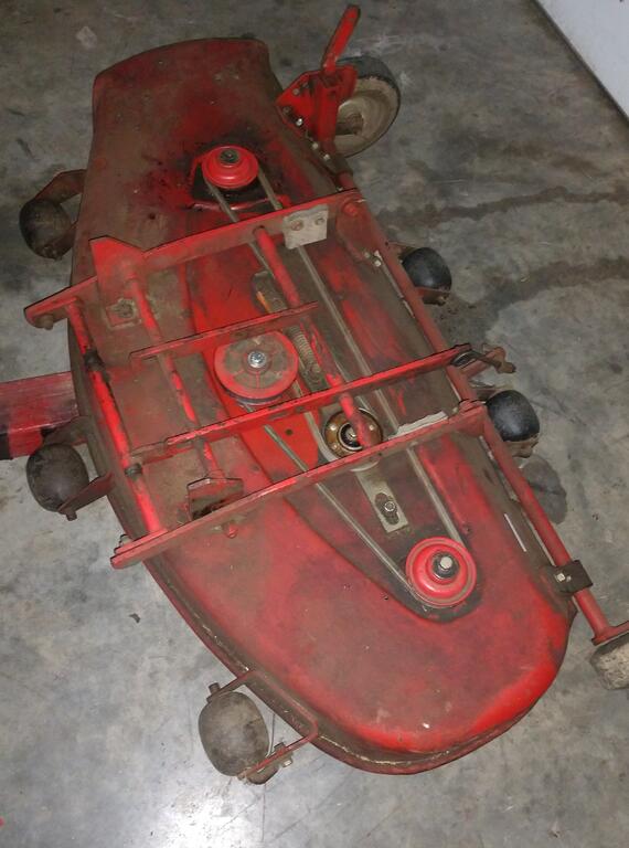

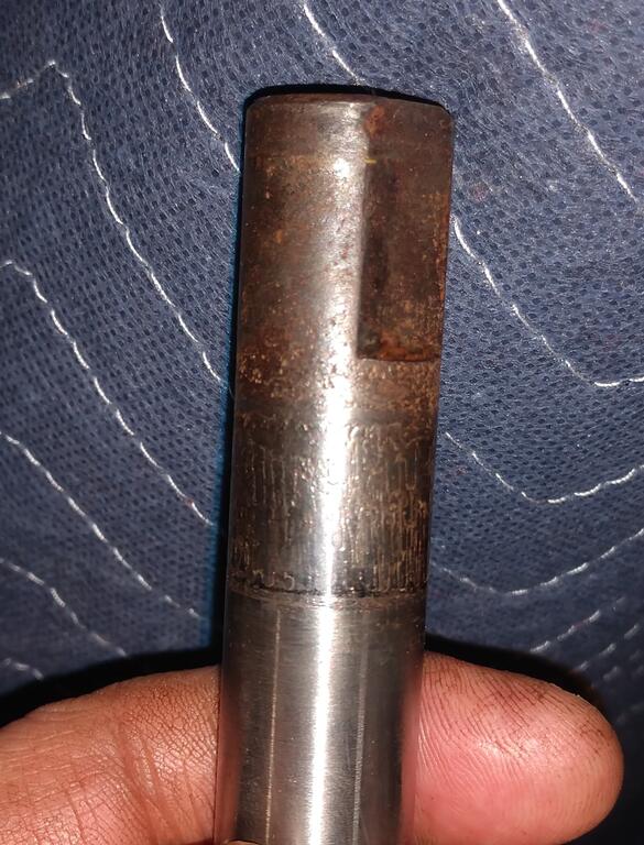

kpinnc 13,030 #1 Posted March 13, 2023 (edited) Several years ago, I swapped out some well-rotted aluminum spindles for the J-type double D cast iron spindles on my 42SD. Then I got a larger deck so I put it up in the barn where it sat for years. Somehow, two spindles got water in them. I still don't know how. The spindles turned smooth by hand, but roared at full speed. Upon dissasembly, I found the culprit. There were small lines cut into the shafts where the needle bearings made contact and rusted. So I dug out some more spindles off an old pre "attach-a-matic" deck and took the shafts from them. Then I spent the day degreasing, reassembling, and regreasing the spindles. Now they spin smooth as silk again. Tomorrow will be deck cleaning, but mechanically she is solid and ready to work! Trying some larger guage wheels too. If it works, it'll mow at 3.75 inches. We will see tomorrow... Edited March 13, 2023 by kpinnc 5 2 Share this post Link to post Share on other sites
