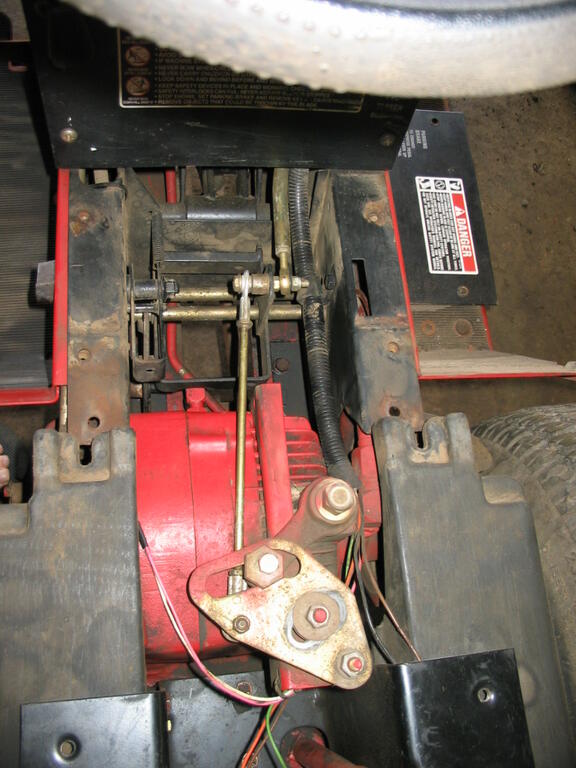

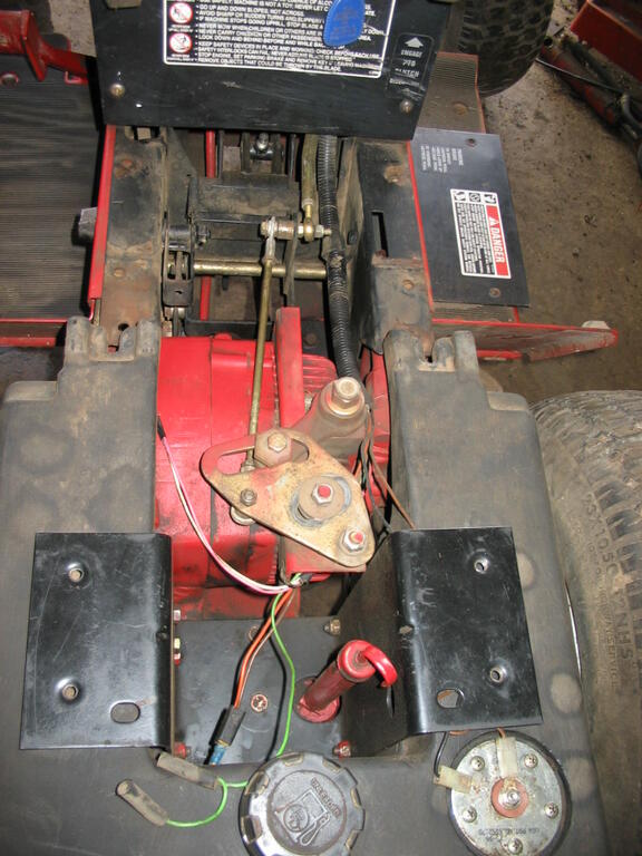

daveoman1966 3,860 #2 Posted March 12, 2023 THIS IS A 1997 520-h. maybe these help. 1 1 Share this post Link to post Share on other sites
JustinW.73 224 #3 Posted March 12, 2023 4 hours ago, daveoman1966 said: THIS IS A 1997 520-h. maybe these help. Thanks that does. After seeing this and looking through what pictures I can find, looks like we have a 416 lever. That's why it's not lining up correct Share this post Link to post Share on other sites
