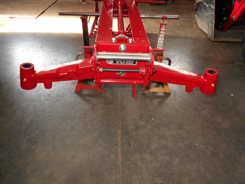

pfrederi 18,115 #1 Posted March 4, 2023 Was making a new front axle pivot pin yesterday and got to thinking why WH machined a groove and added a E clip to the front of the pin. The tab and bolt on the back would seem to be adequate to secure it. i have made a couple in the past but I have no lathe so one i made a bit longer and drilled for a cotter pin. didn't do anything on the other nor the one yesterday. Am i missing something. Share this post Link to post Share on other sites

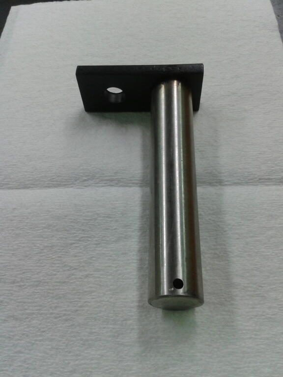

cleat 6,807 #2 Posted March 4, 2023 The ones I make also have a hole drilled for a cotter pin Here is one installed. Pin is not really required but is a good safety in case the tab breaks although I make my tabs much thicker so breakage is likely not going to happen. 3 Share this post Link to post Share on other sites
squonk 41,840 #3 Posted March 4, 2023 I've see about a dozen broken tabs. Nice to have a clip or pin. Share this post Link to post Share on other sites
pfrederi 18,115 #4 Posted March 4, 2023 I made this one long enough to drill, the previous one isn't long enough...guess I will just live dangerously 1 Share this post Link to post Share on other sites
wallfish 17,158 #5 Posted March 4, 2023 Agree, with a thicker tab welded on, there shouldn't be a need for any additional clips or pins Share this post Link to post Share on other sites
