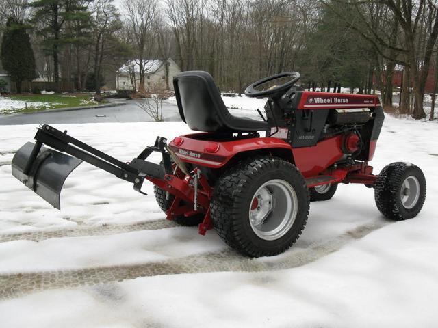

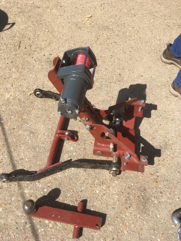

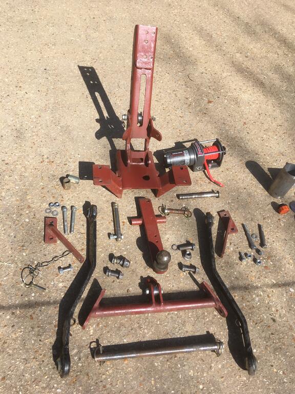

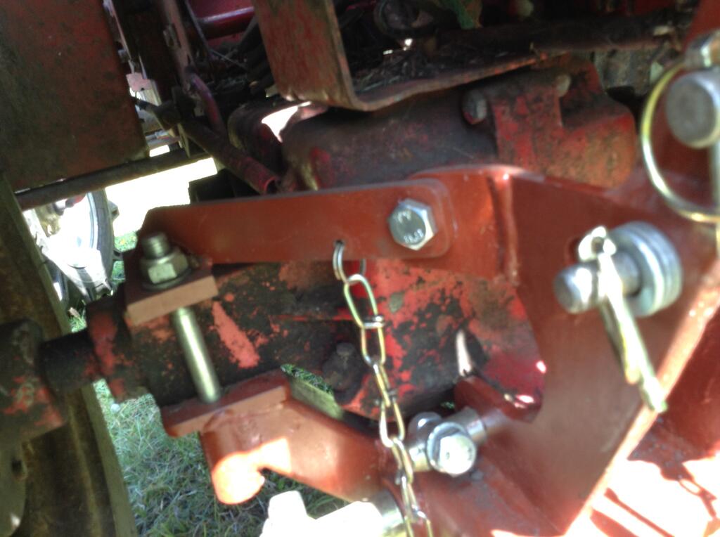

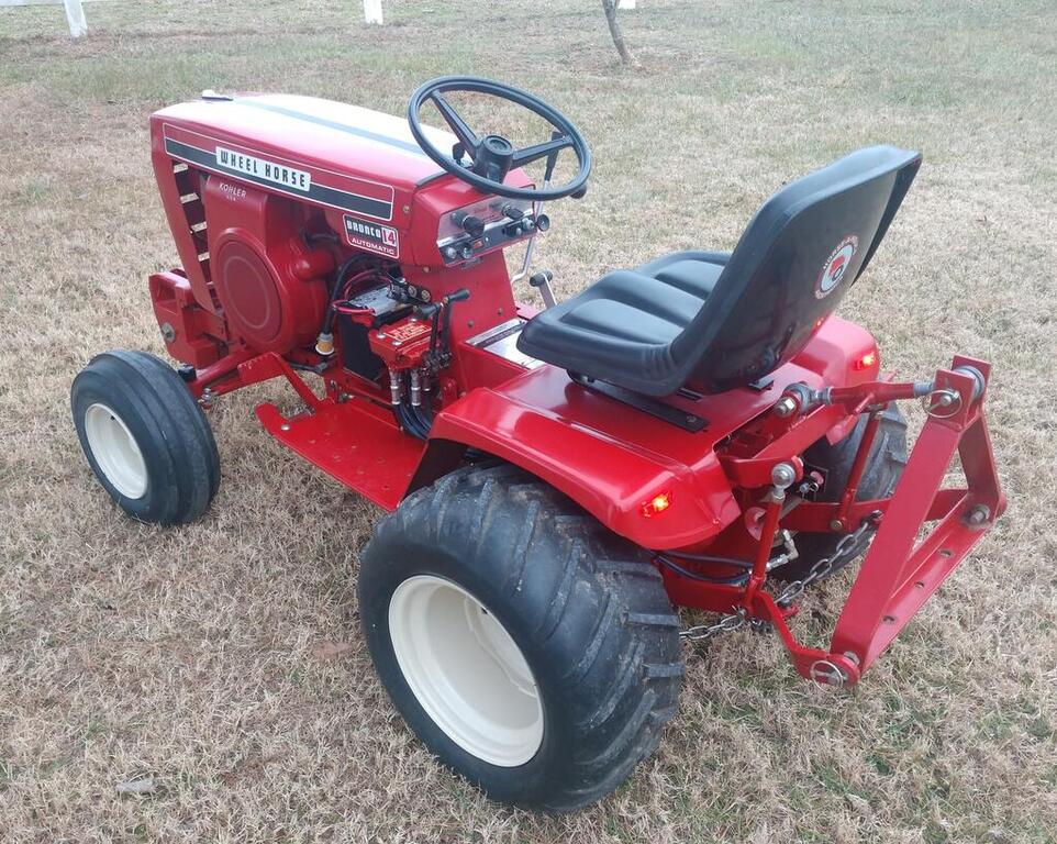

kpinnc 13,314 #4 Posted February 27, 2023 As already mentioned, it's quite a bit more work with the fuel tank under the seat. My Bronco was easier because the fuel tank is where the battery is on your Work Horse. That's the first pic. @stevebo built one for a 520-H, and it looked pretty sharp. Pic below of the 520-H is his. 4 1 Share this post Link to post Share on other sites

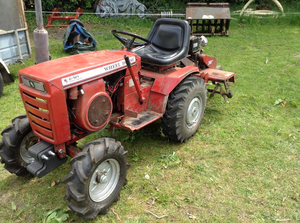

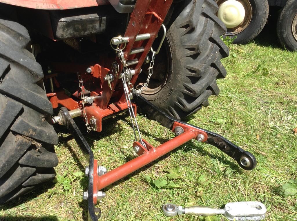

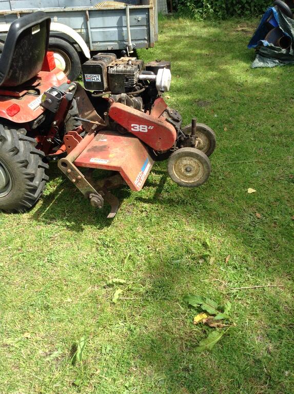

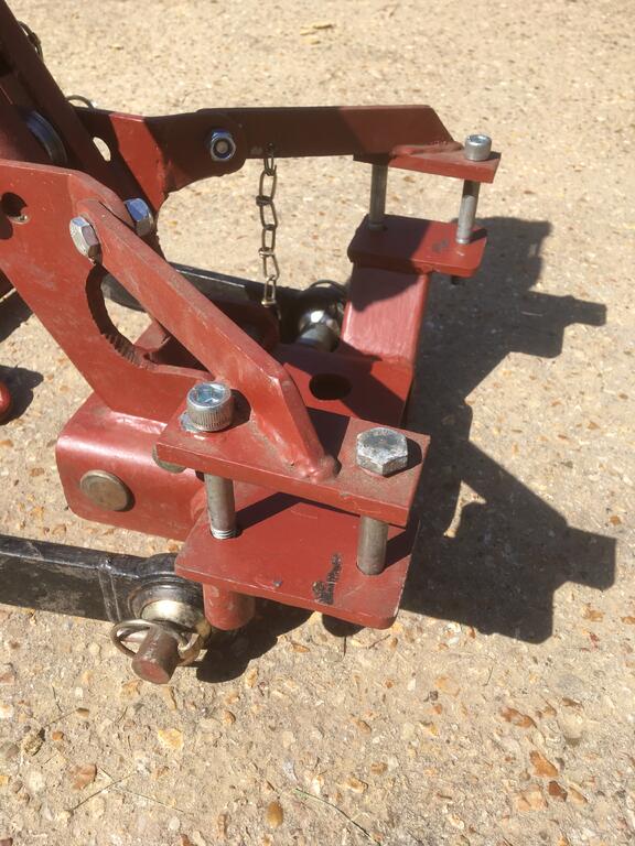

ranger 1,771 #5 Posted February 27, 2023 Here are some photos of my C121 setup, straight bolt on job. 12v winch operated, under seat fuel tank still in place. Tiller weighs some 250 lb’s? 2 3 Share this post Link to post Share on other sites
