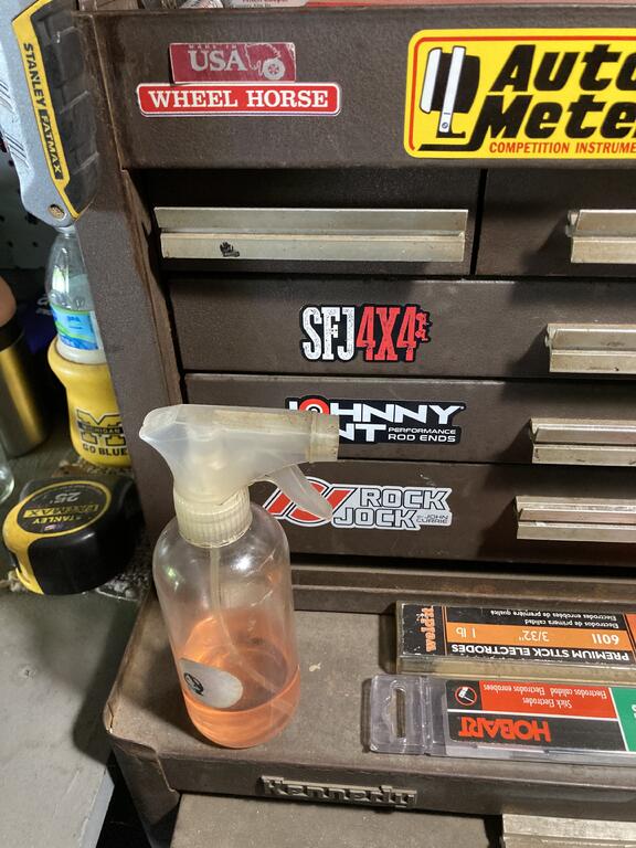

Blasterdad 3,039 #2 Posted February 26, 2023 1 hour ago, Your Uncle Tony said: wouldn’t even pop or sputter while spraying starting fluid in it. Probably a good thing, never use starting fluid, it can do extreme damage, use a squirt bottle with gas in it. Try pressurising the tank to get the gas to the pump, I put a rag around my air chuck & give it a little blast, pushes fuel through the lines & up through the pump. 6 Share this post Link to post Share on other sites
