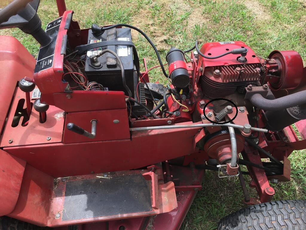

Racinbob 12,422 #8 Posted February 26, 2023 Assuming you had been driving it I'm thinking maybe the spring on the PTO. I had to steal a picture because I don't use them. Share this post Link to post Share on other sites
gwest_ca-(File Mod) 11,839 #9 Posted February 26, 2023 In 1995 the spring is near the rear of the pto rod and hooks into the corner of the battery tray support. Item 13 https://www.partstree.com/models/73401-314-h-toro-garden-tractor-sn-059001261-059999999-1995/pto-clutch-and-control-30/ Battery support item 1 https://www.partstree.com/models/73401-314-h-toro-garden-tractor-sn-059001261-059999999-1995/hood-stand-and-supports-23/ 2 Share this post Link to post Share on other sites

chev0545 236 #11 Posted February 26, 2023 2 hours ago, gwest_ca said: In 1995 the spring is near the rear of the pto rod and hooks into the corner of the battery tray support. Item 13 https://www.partstree.com/models/73401-314-h-toro-garden-tractor-sn-059001261-059999999-1995/pto-clutch-and-control-30/ Battery support item 1 https://www.partstree.com/models/73401-314-h-toro-garden-tractor-sn-059001261-059999999-1995/hood-stand-and-supports-23/ 1 Share this post Link to post Share on other sites
chev0545 236 #12 Posted February 26, 2023 it's a 95 this doesn't apply 1 Share this post Link to post Share on other sites
